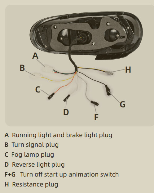

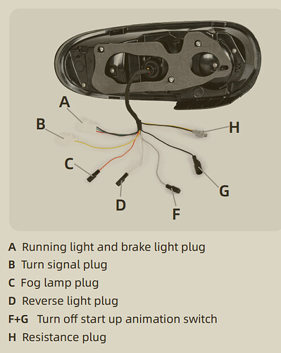

Ive Just installed some Archaic rear LED lights on my NC . They work apart from the start up sequence . Anyone had this problem?
Are F and G connected?
Hi Phillip,
Yes they are connected I’ve been fiddling with the pibs as well doesn’t seem to make a difference.
Are you getting somebody else to turn on the lights while you watch them? It happens pretty quickly, so if you turn on the lights yourself and then go to the back of the car, you’ll have missed it!
Do both of your fog lights and both of your reversing lights work, or just one on each side?
Have you tried disconnecting and re-connecting all of the connections?
Are these a recent purchase? (Some of the earlier Archaic harnesses had a couple of wires reversed, but they sorted that out a long time ago).

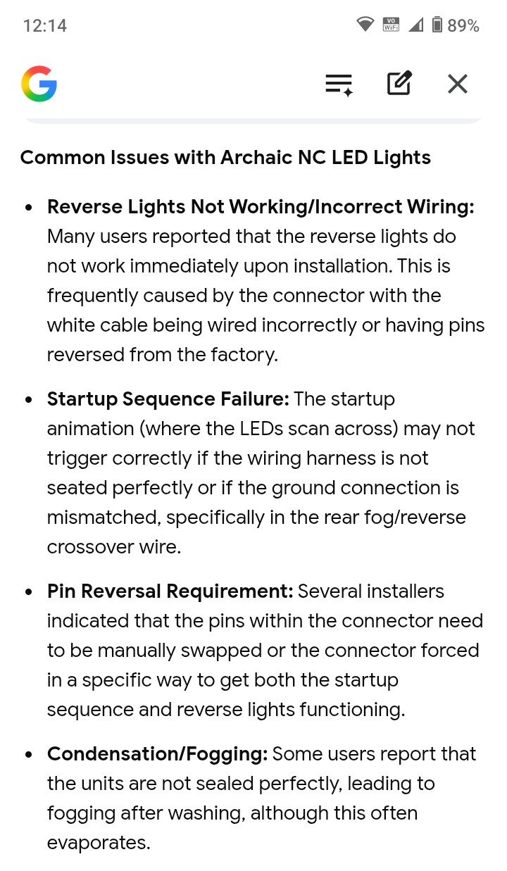

Yes ive done all of the above. Received it yesterday so its brand new.
Other than perhaps trying to disconnect plugs F & G, I’m all out of ideas.
Next step is to try contacting Archaic support, I guess.
