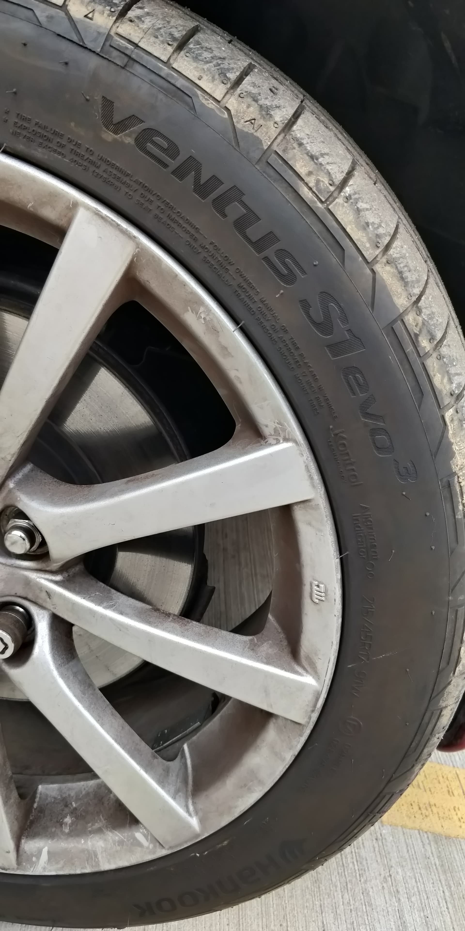

The tyres are hankook ventus S1 evo3. I had the steering problem when it was around 3c.
Nothings changed as I also lost my tyre pressure gauge so didn’t measure but remember it was on the high side.
So it seems the tyre got hard enough due to the low temperature plus a perhaps high psi to affect steering.
