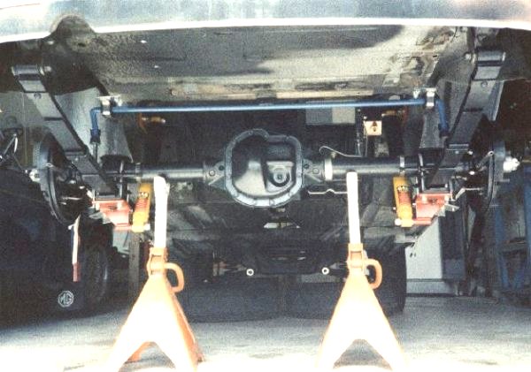

Hi, no MX5s have a live axle. It was a term more often heard 40 years ago when discussing if a car had a live axle, usually with cart springs like a Ford or MGB, or independant suspension with coils such as Triumph TR6. The MX5 is a refinement of the latter.
I’m not sure of a specific term for an axle without a diff. A live axle might not have a diff at all, or may have a regular diff, or an LSD, but it refers to it being a beam between the 2 wheels which is part of the suspension locating the wheels rather than just supplying drive torque to them. Uh, that sounds complicated but compare an MGB rear suspension (live axle) with TR6 or MX5 (independant suspension) and you’ll see what I mean Smile
MGB live axle with aftermarket anti roll bar (blue) and telescopic shockers (yellow) instead of lever arms fitted,
TR6 independant susp with coils and lever arm shockers
