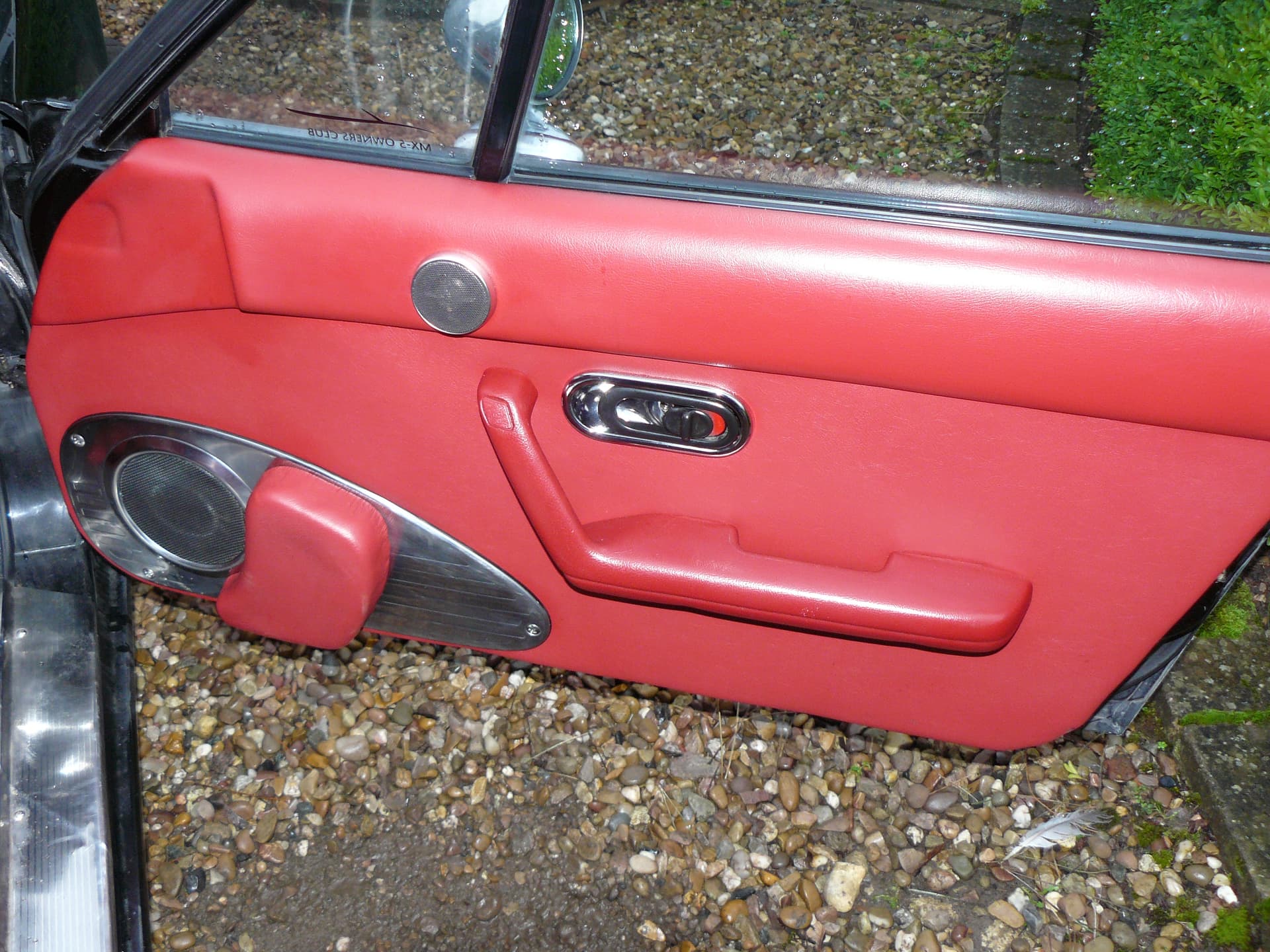

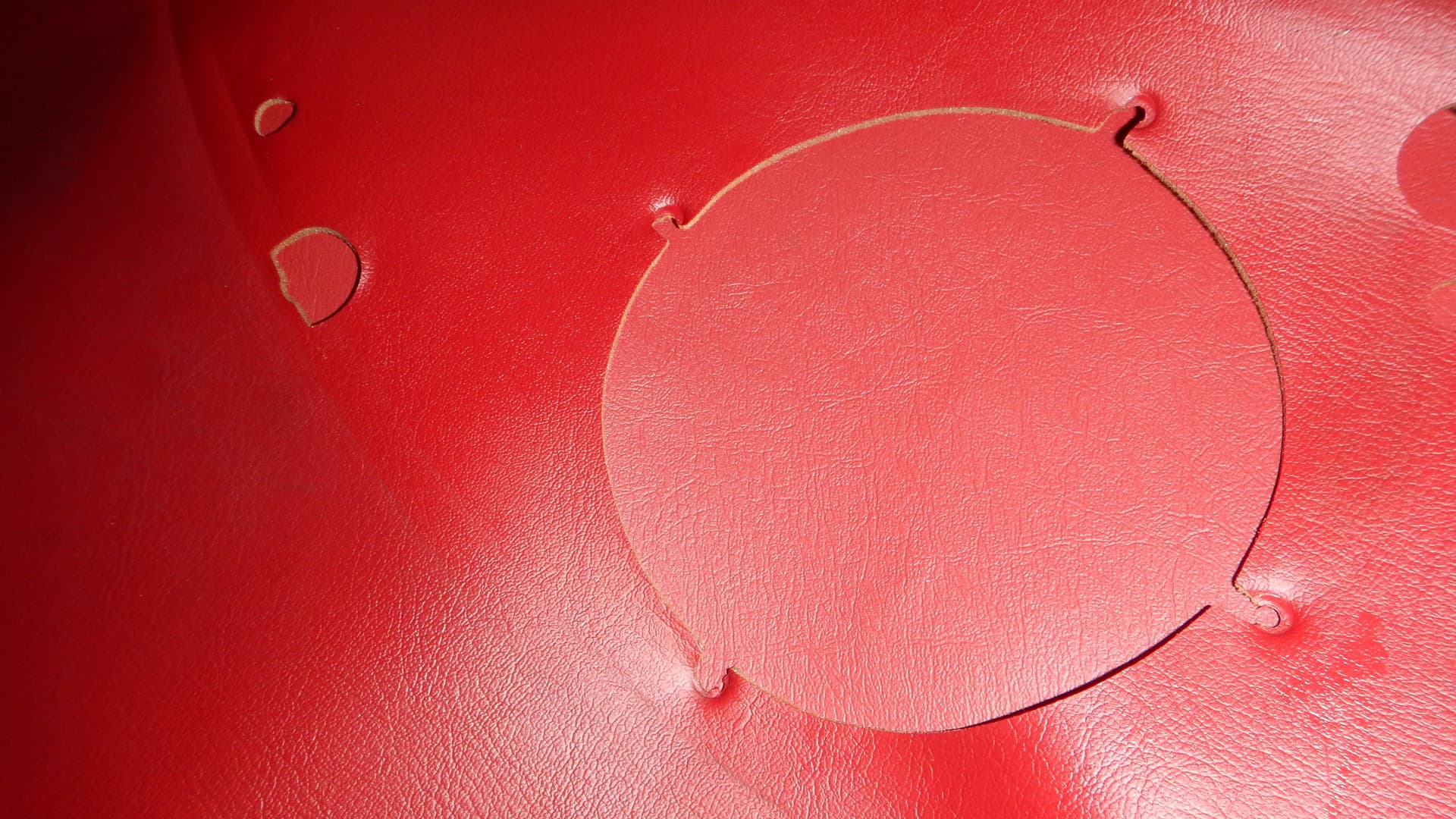

If you need to recover the door cards, Martrim;s Matador Red vinyl is a perfect match. I covered a S-Limited years back.
Bear in mind, on most S-Limited, the red plastic is really filthy, but people don’t realise. They just think its dark red.
Thanks for all the advice, it really helps. I’ve got a handle on what’s involved now and just need to get organised. Really appreciate directing me to Martrim for the red vinyl, mine is sun faded and will be replaced, now I know where to get the material, big thanks ast.
