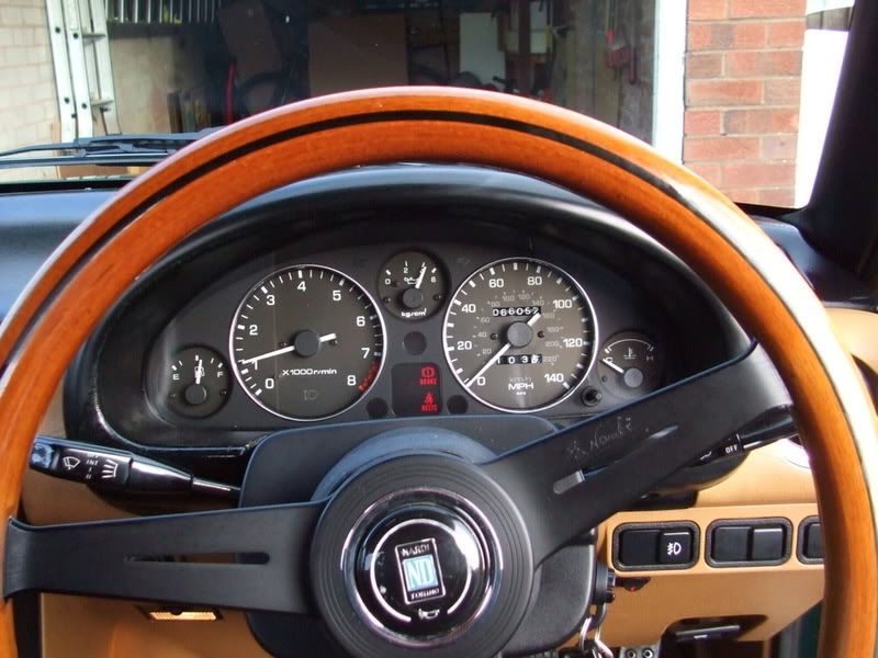

Thank you for the many replies its very appreciated.  Can someone do me a favour and take a picture of a dash showing the speedo so I can see if the needle on mine is at the same place at rest.  Thinking about it I’m sure the needle on the speedo didn’t start indicating any speed until my Sat Nav reached about 5 to 8 mph?!!
This is mine

Here you are, hope this helps. I had to use a flash as it’s a bit dark in my garage.
Yours is in a different position to mine, that’s for sure. I noticed that you had the engine running when you took your photo, can’t imagine that this would effect it though.
Hi pollyana
Thank you very much for taking the photo, I’ll print it off so I can compare it against mine while I’m sat in the car.
Thank you once again its very much appreciated.

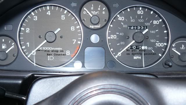

 Hi Marcus, I have just zoomed right in on the picture in photoshop and there is no pin stop on the speedometer pointer. So I double checked on the speedo in the car too. There is one on the Rev counter though. I wonder if mine or yours may have not had the dials positioned correctly when they were changed over to read MPH from KPH. Here is a picture to show you the pin stop.
Yes my speedo is the same with no pin stop, but has one on the rev counter.  I’m going to reposition the needle on the speedo so at least it will read a little faster than what I’m actually doing.
Thanks once again for you help.
Marcus.
