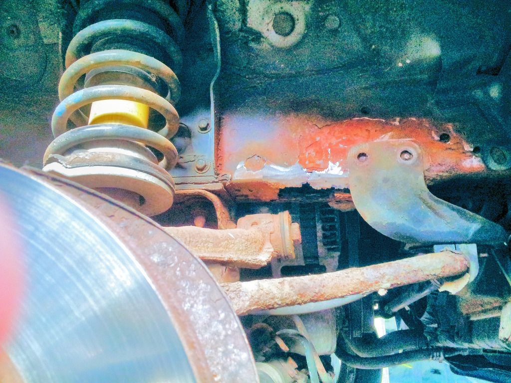

This was my old Mk2 RS Sport 6 speed, had it for 9years, shame about the rot though, to think my Mk 1 will out live it.

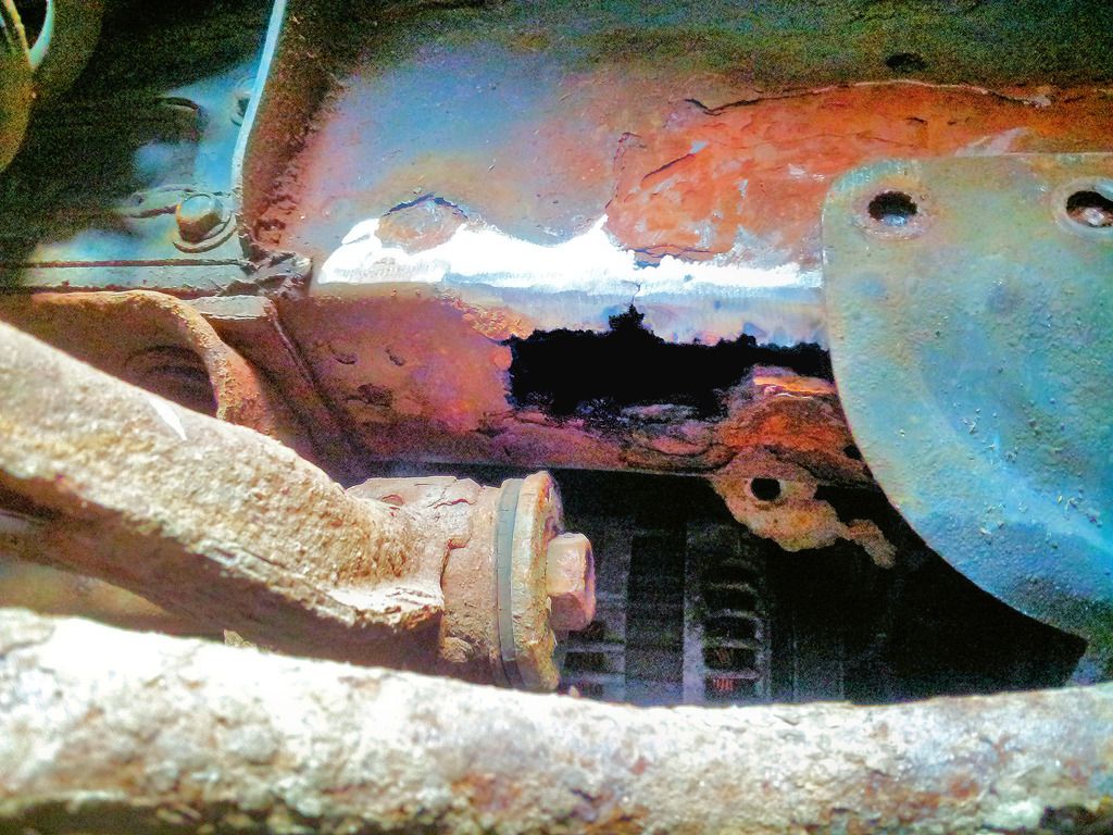

 And here is what will kill it.
I had it patched to get through the MOT, and sold it for £950, welding was visible from inside the engine bay, I consider the repair a temporary solution, though I doubt the value is in the car for a serious repair.

In my opinion the car looks great on top but thoroughly neglected down below - lots of rust apart from the obvious corrosion to the chassis legs.
I’m guessing that you are near salt water at Gower?
All repairable - specialist repair sections for the chassis legs and some good old fashioned hard work, along with rust killer, protective paint and underseal for the rest of the car’s underside.

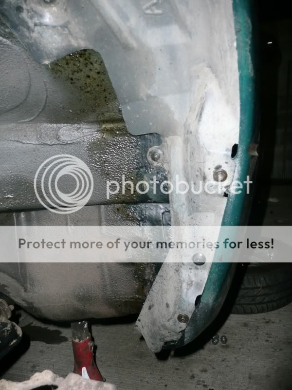

Cross section of my old ones…
I sent a nice piece to Mazda 4 years back.
No reply.

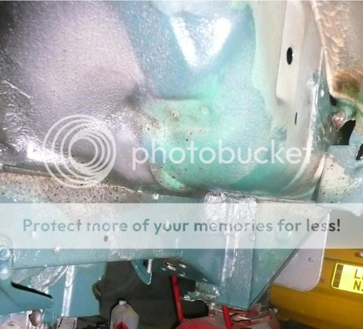

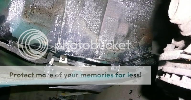

Notably, my Mk2.5 OEM chassis rails, from Mazda, are very heavy re-enforced single skins…one does wonder.

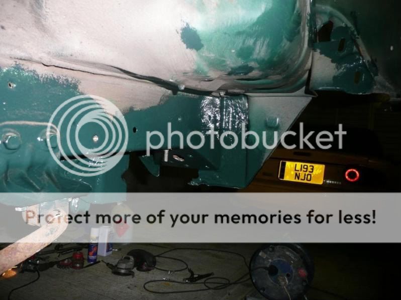

The finished article
