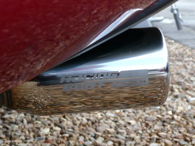

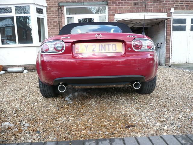

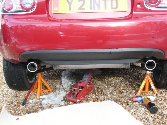

 That’s good infomration that you very much indeed.  I’ll discuss this with Norton Way Mazda on Monday and post the results here.  Thanks a lot Tim. Oh, tell me about your racing beat exhaust please.
 There’s a problem with the rear Geometry, probabally the toe angle, be sure to get a printout.
Clive… bought from Rotechniks for £345 delivered to the door, fitted on the drive in 30 mins, looks much better than the stock system, helps the engine to breath as well.  Sound is a low rumble on tickover and only noticable when it’s floored…[:D] even SWMBO said have you put the exhaust on…it’s very quite, she hated the Mk1 as it was too noisey.
This is their phone number here had them in stock last week, dispatched next day…
