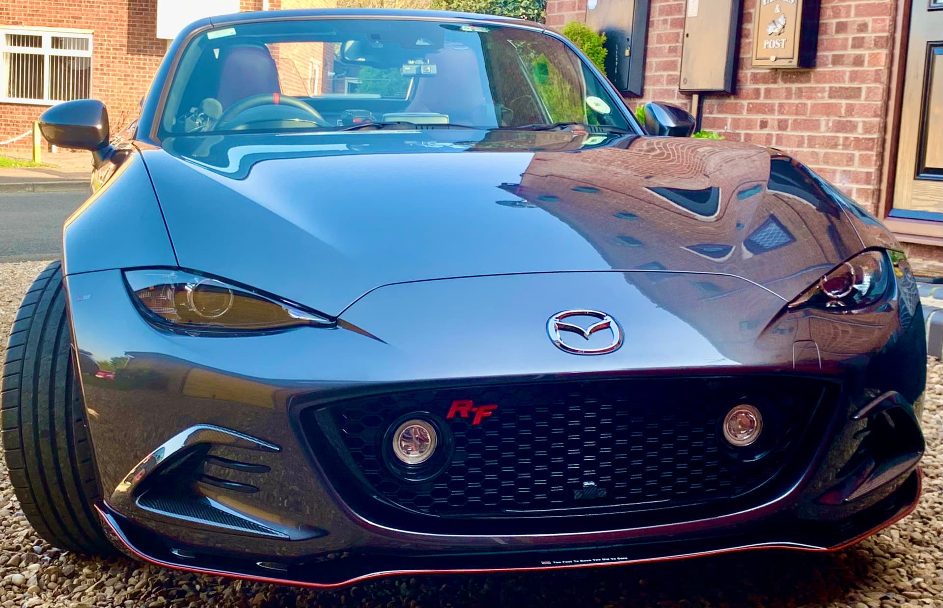

Modding For Looks & Fun 2019 2.0 GT RF Sports + New Titan Lock fitted .....!

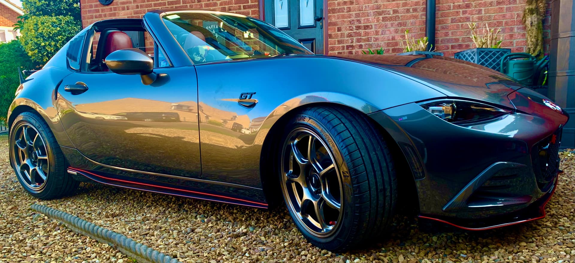

yep just emailed my mate he said this morning about the size I forgot that I had gone e from 7inch to 8 it was not till Chris on another thread said they where a stretch I still did not twig then the penny dropped he said they will order some new ones in on Monday so get it done next week going 225/45/17 hoping I don’t now have trouble with the 20mm spacers …wheels off wheels on good game … :joy:
Since you cannot get 225/40 tyres for 17 inch wheels, I’m guessing you’re referring to 225/45?
If so then 225/45 tyre is too large of a circumference increase compared to factory fitted 205/45 tyre. Both acceleration and speedo accuracy will be affected.
225/45 tyres may end up rubbing the front wheel liners due unless @exiled-viking reduces caster, potentially resulting in less steering feel.
Yes, I was referring to 225/45/17. I don’t disagree with anything you’ve said there, but it remains the case that a 225 width tyre is optimum\recommended for an 8" wheel.
It’s one of the reasons I wouldn’t personally go with that wheel width on an MX-5. But to each their own. So working backwards, it sounds like a slightly stretched 215/45/17 on an 8" wheel is the best compromise here.
well l have ordered in for Monday 225 Bridgestone Potenza Sport’s for the car so there will be 4 Brand new tyres going up for sale later they have done NO mileage probably knock 1/3 off the price … :wink: then repost up all my ND stuff for sale there’s quite a few bits …
225 is too chunky for my liking, makes the car look like a Tonka Truck, I stuck to 215 on my 8Js.

In the end I have gone for Bridgestone 215//45/17s they look a lot better going to go for a little spin out to get the TPMS working …
Good drive out around 200 miles on the clock to day but still not hit the 5k miles yet shes 6 years old …top down most of the way… Poped into Royal sterring wheels for my new wheel got it fitted all done in less 30 mins and he got the wheel nut off no problem thank you Jack+team for a job well done …Now needs a good wash …!

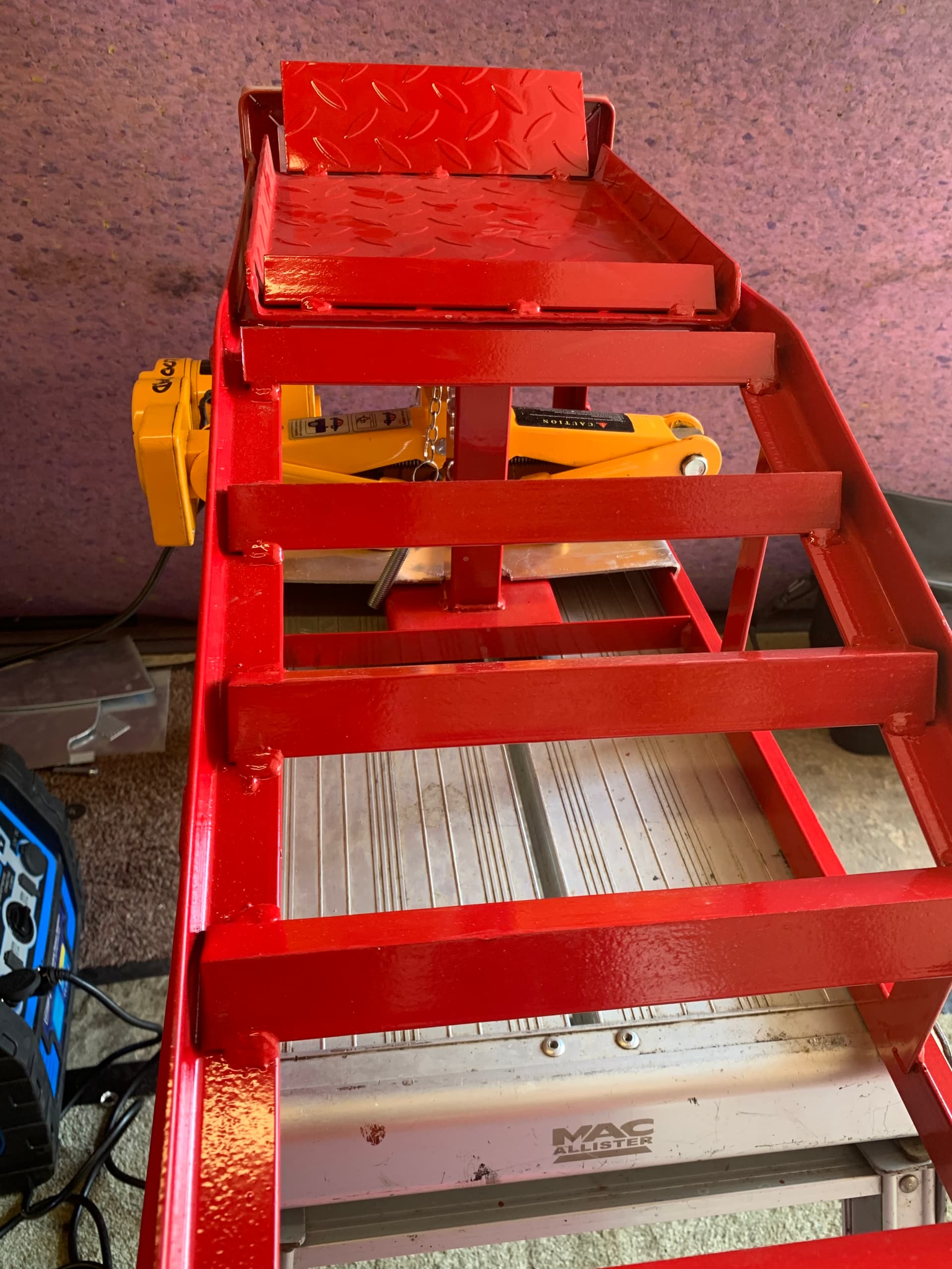

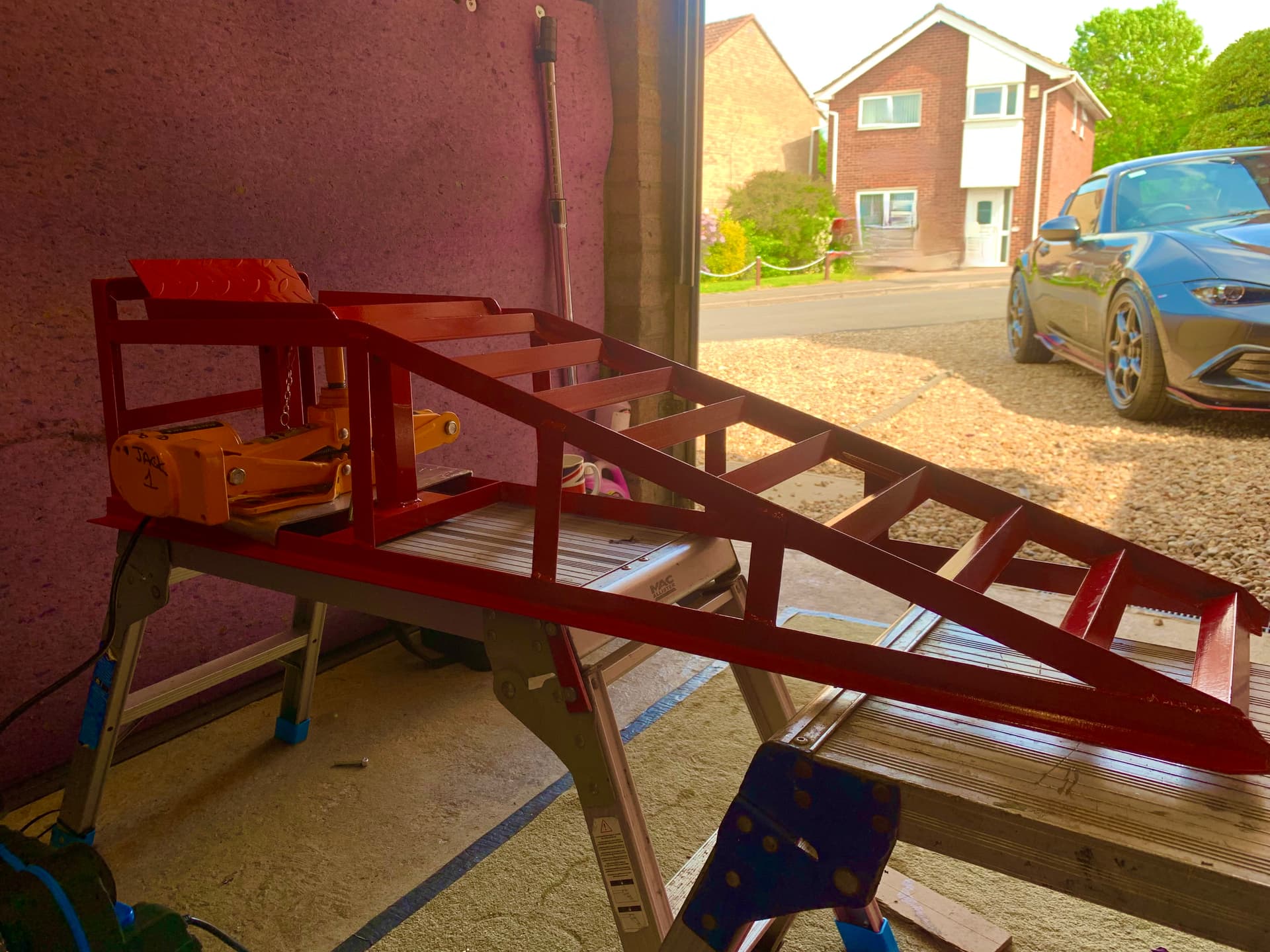

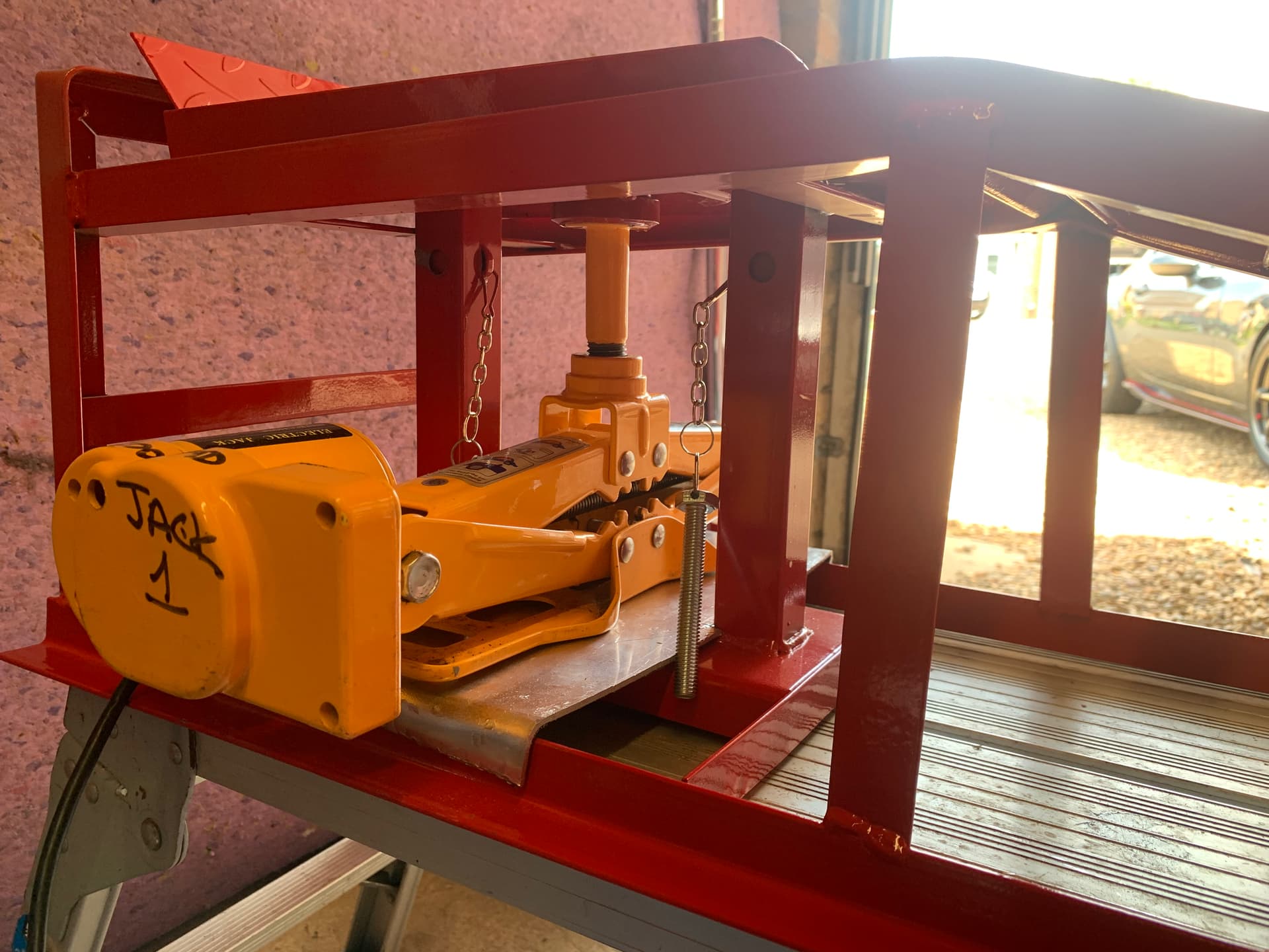

Well today I got to work on my new project Car Ramps I had theses deliverd yesterday …
But do not want to use the 5ton Bottle jacks supplied I do have two 2.5 ton 12 Volt battery bank operated jack that I have modded to fit the ramps…

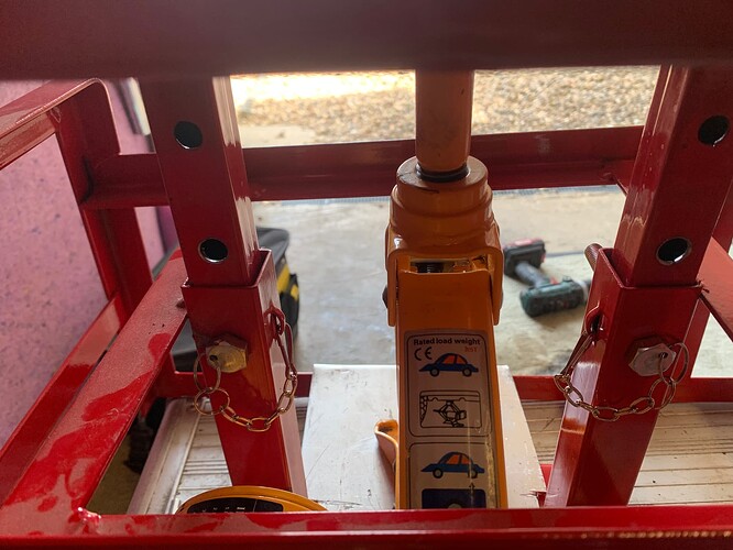

I am not too keen jacking up one side then the other with bottle jacks with the 12 volt battery jack I can raise both ~ramp plates together then lock of either side with the bolts for more safety while working under the car …
so updated the locking pins to steel bolts I like to used these as there is little chance of them slipping out of the locking holes due to the threads grip the hole…
made two small aluminium mounting plates to rest the jack on they lay on top of the bottle jack mounting plate and make the job leavel for the 12 volt jack…
weld on a locking ring on the underside of the lift plate so the 12 volt jack can be locked in to the lift plate…
few pics and some vids
plenty of width for my wheels/ tyres
Imgur
click on this picture for a small video
locking bolts in when you have the hight required
Imgur
click on the picture for small video

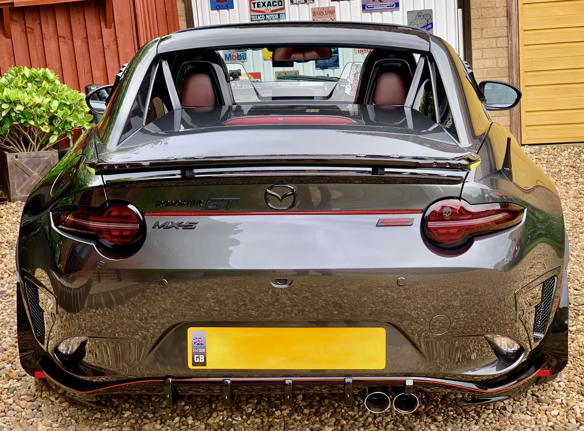

I really like the look of the rear spoiler. Where did you get that? Also, was it a pain to mount?
He got it from deep inside his imagination and fused it with his considerable skills!!
Hi John, I Made itmy self and no it was an easy fix in fact I am making two new mounts which should be finished within the next two weeks …
just for info I make most of the aero mods on the car…!
■■■ your making a dream MX-5 :heart_eyes:

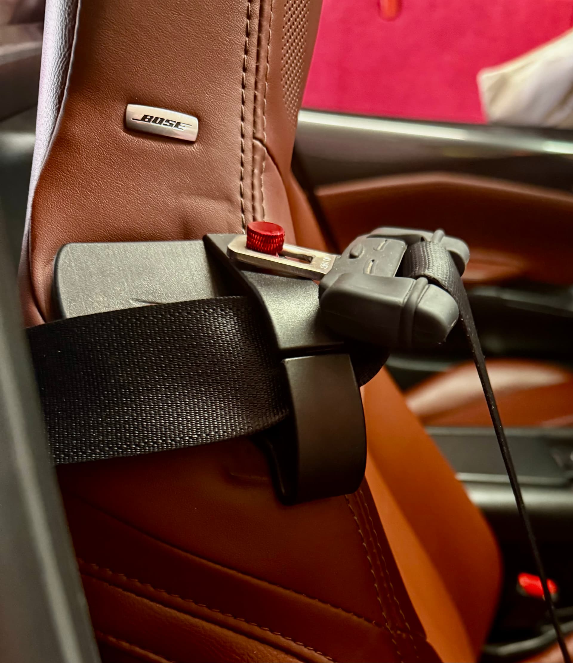

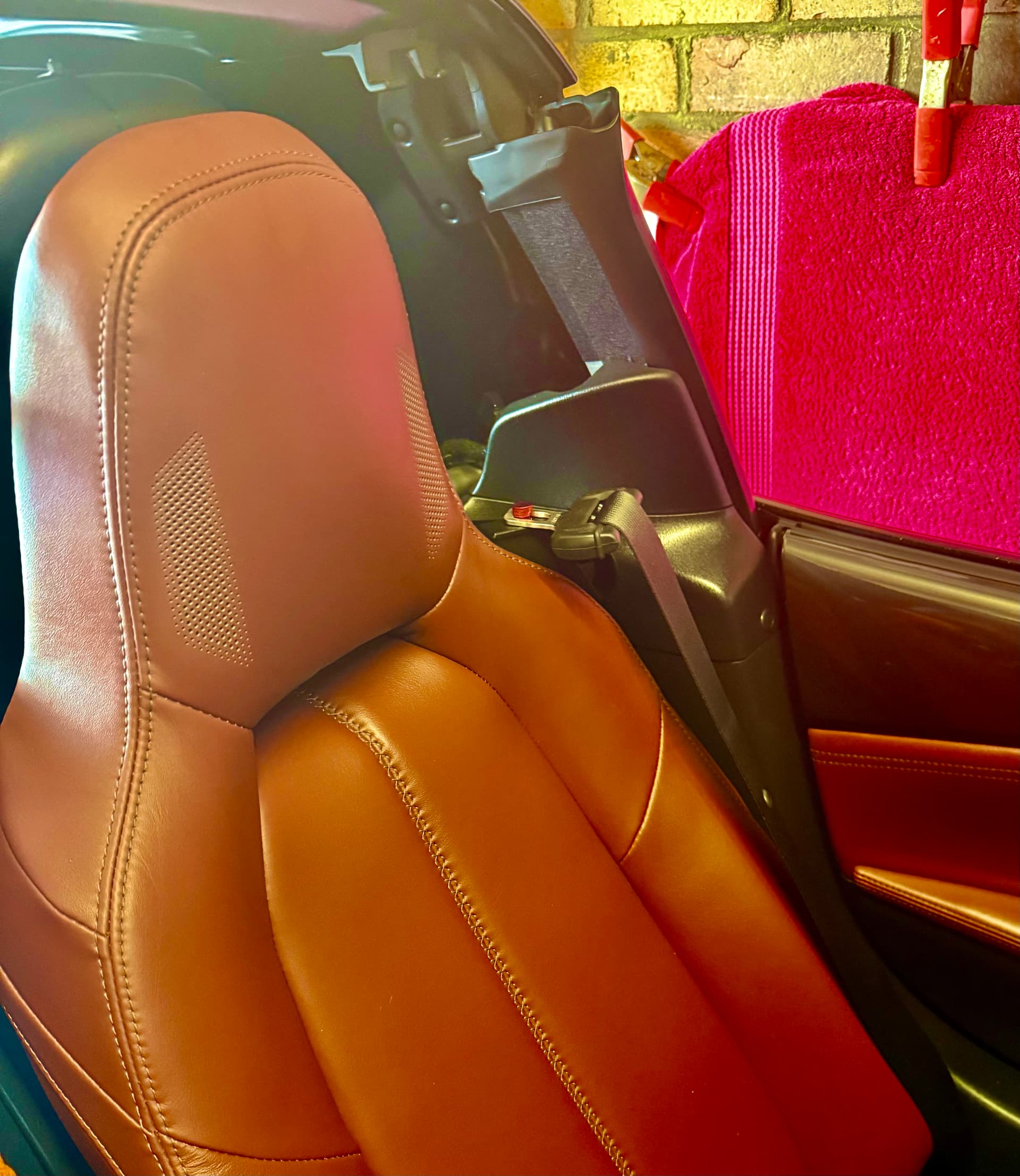

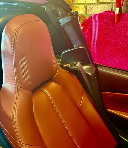

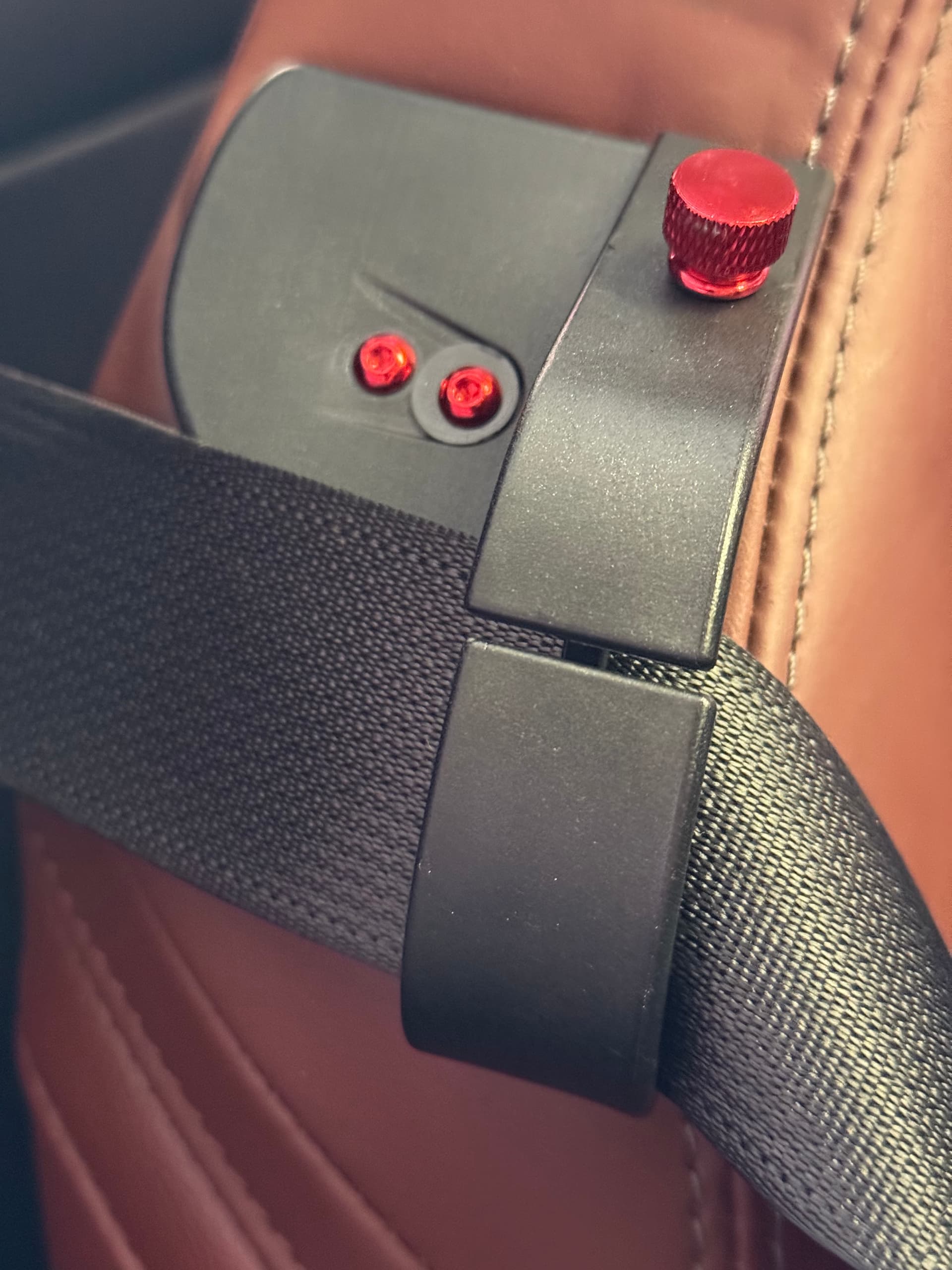

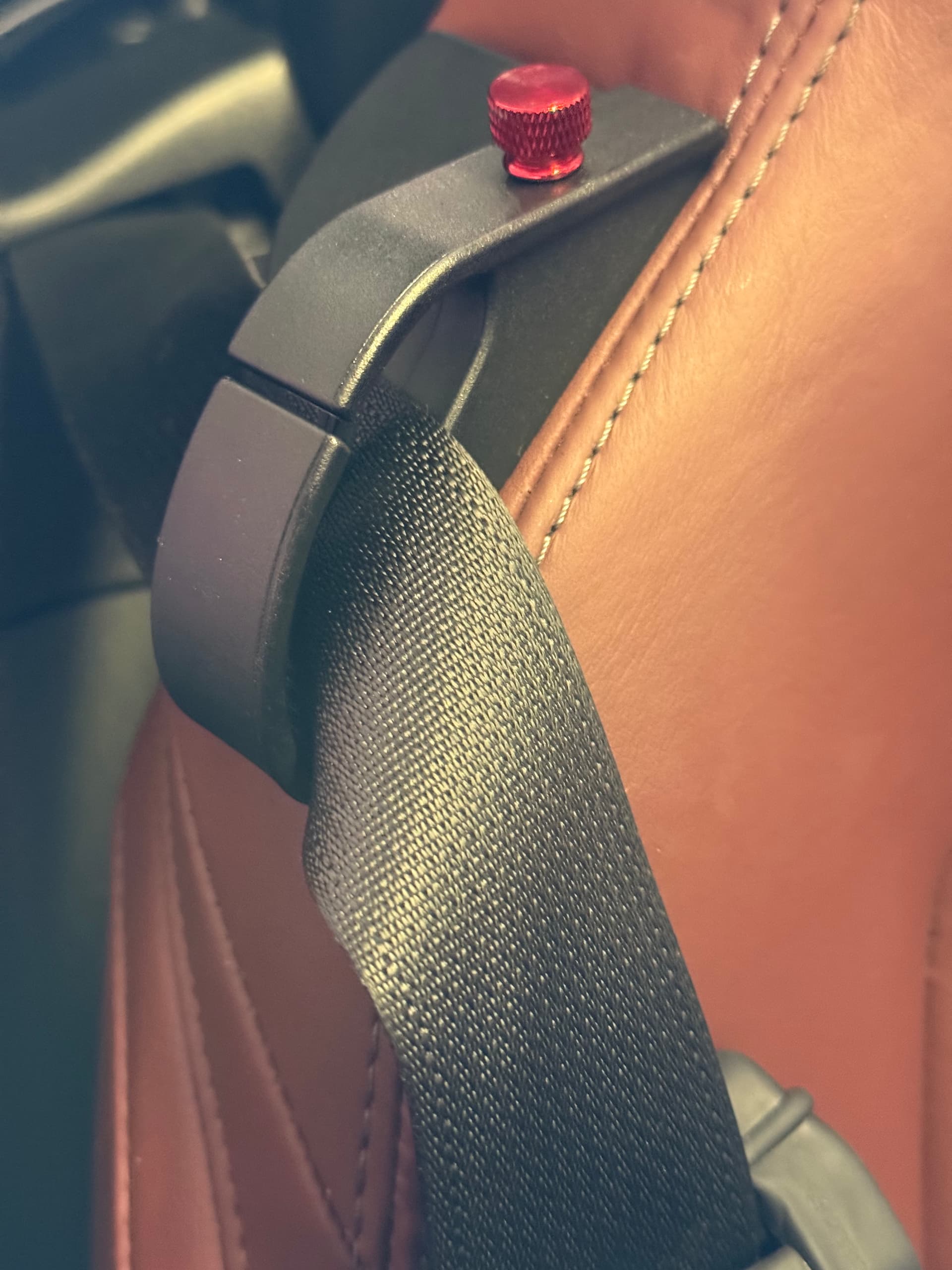

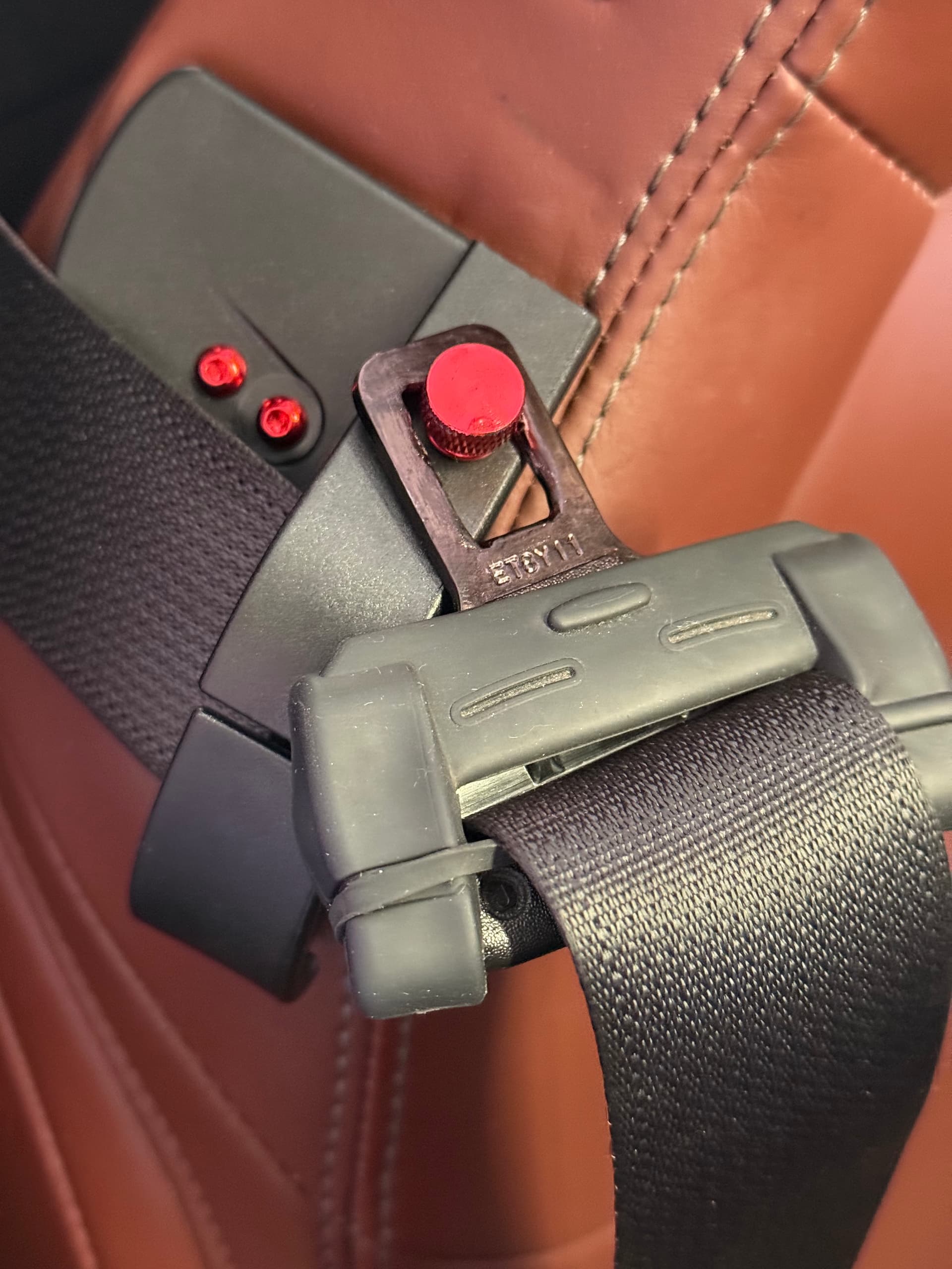

Fitted my “Copied” 3D Printed lower’d seat belt guide…works well sits better over the shoulder & kept away from my neck…also added a seat buckle holder…this the second time I used the machine/copier to do plastic parts its been very enjoyable …
there are quite a few people doing these small 3D printed mods

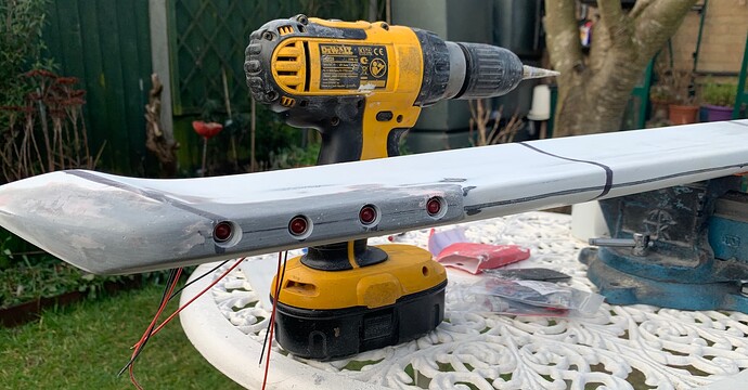

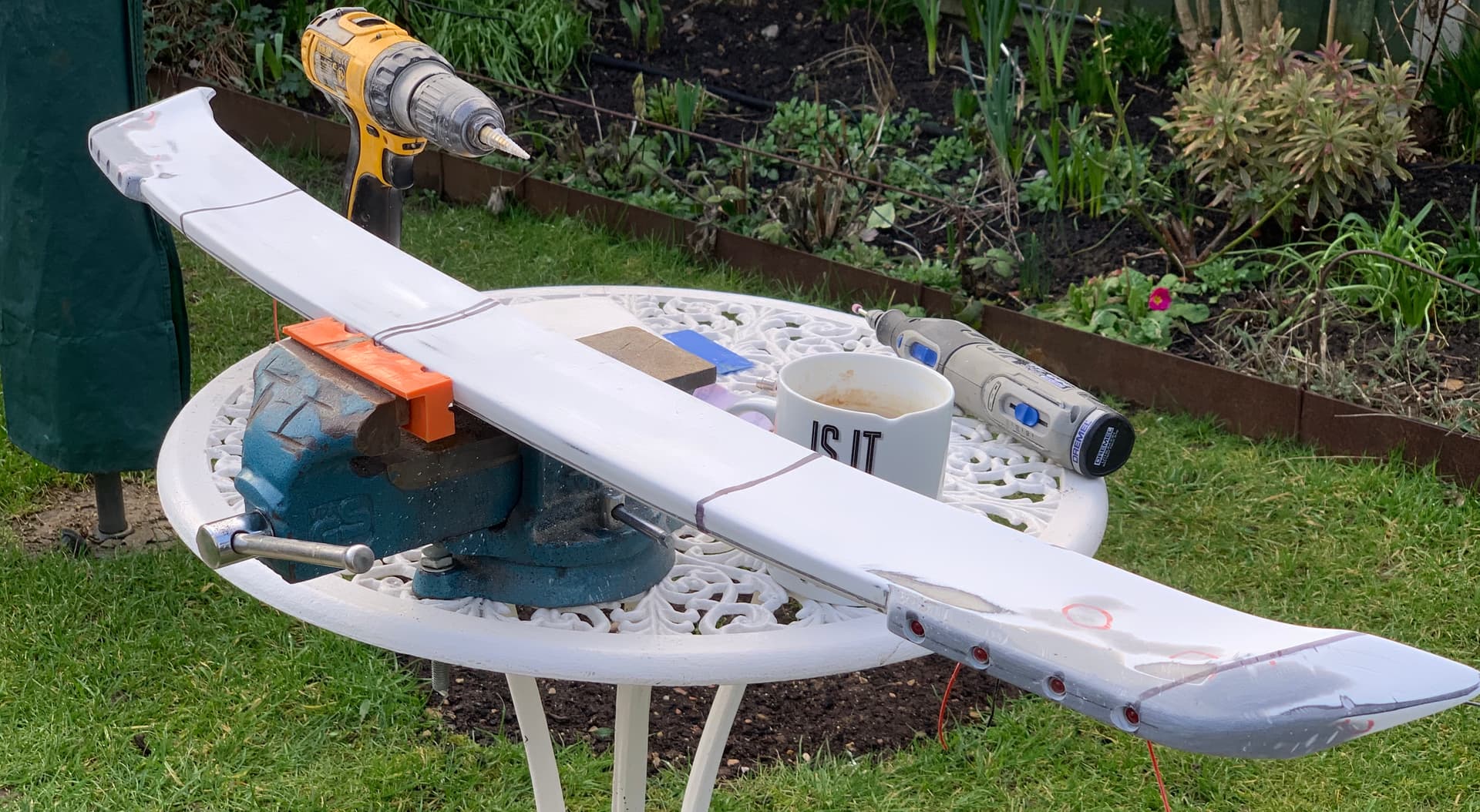

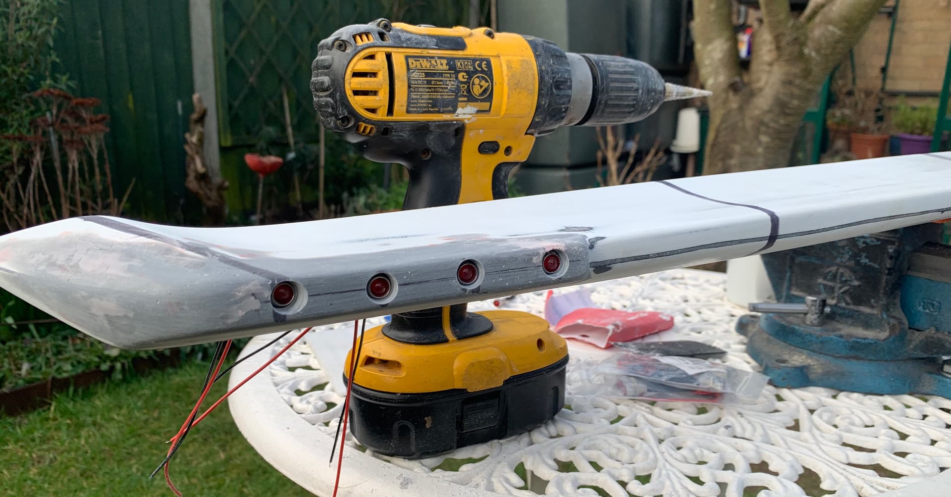

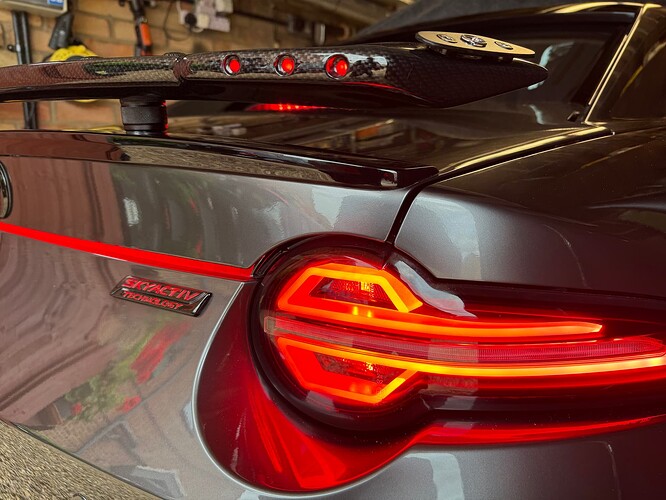

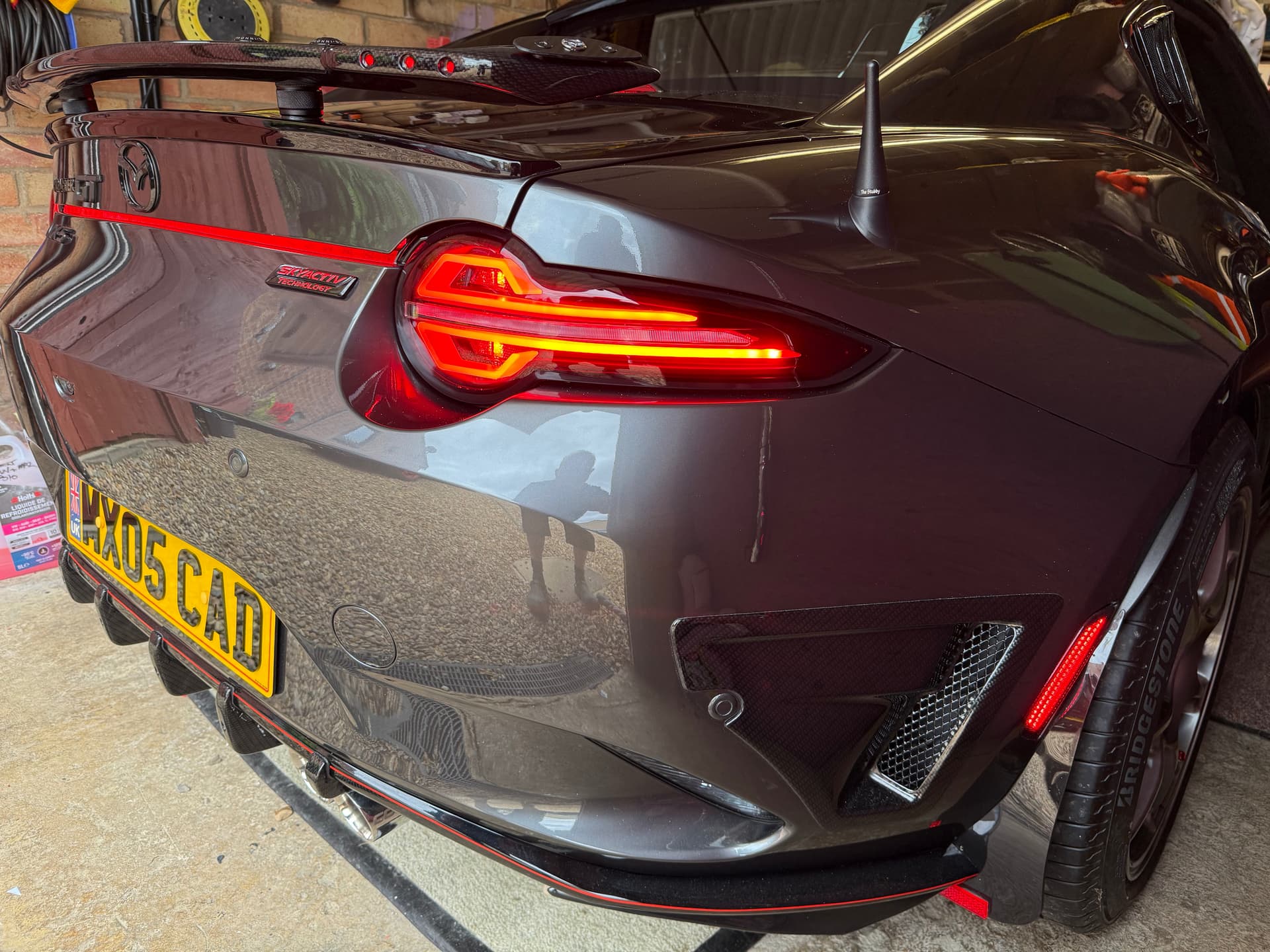

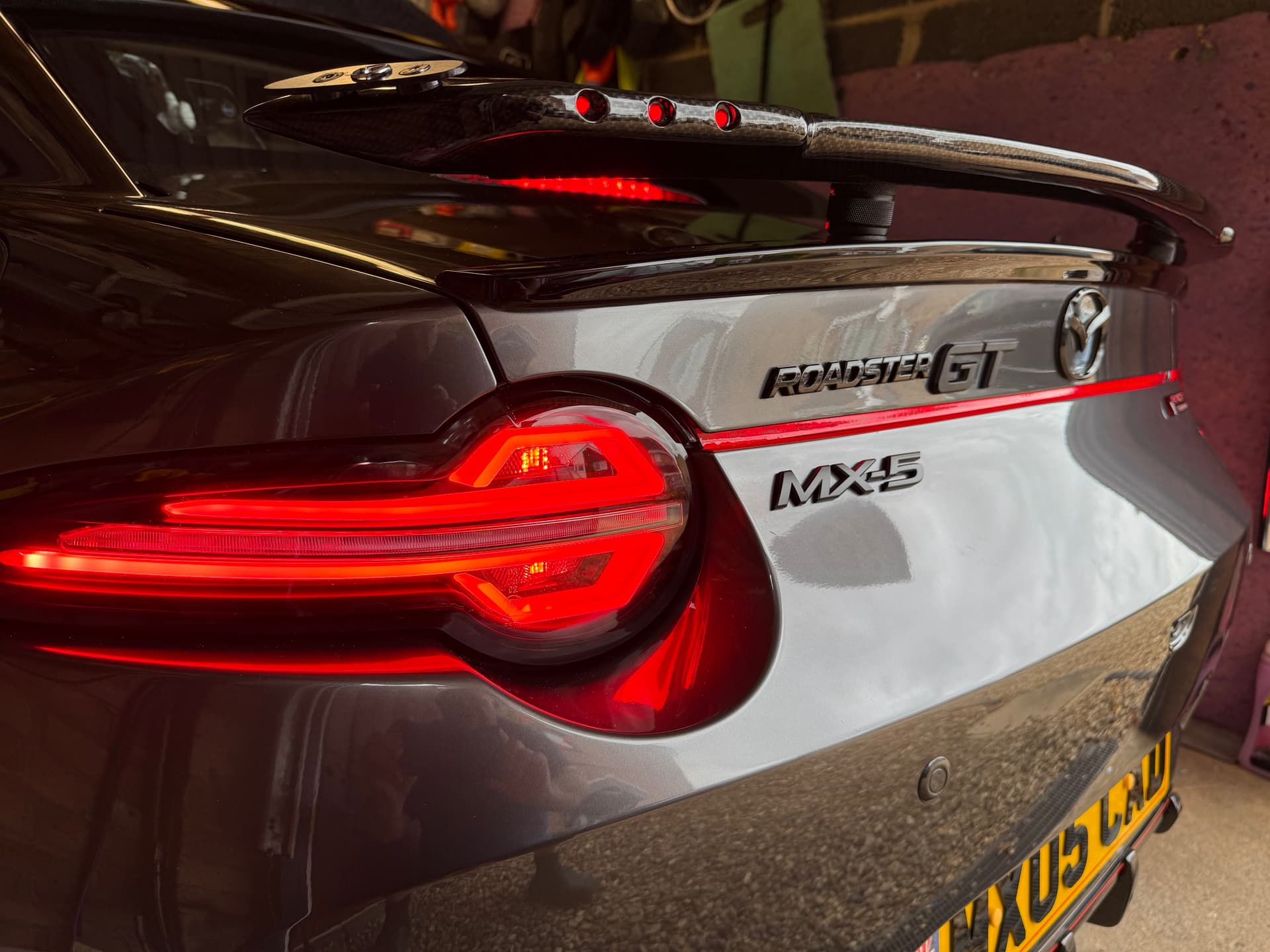

over the last 3 weeks I been updating the rear handmade Rear spoiler the rear wing has been updated with new LEDs and the spoiler mounts have been remade with small rubber washers to take out some of the vibration some photos of the revamp project in two parts
rear spoiler look before update of new parts

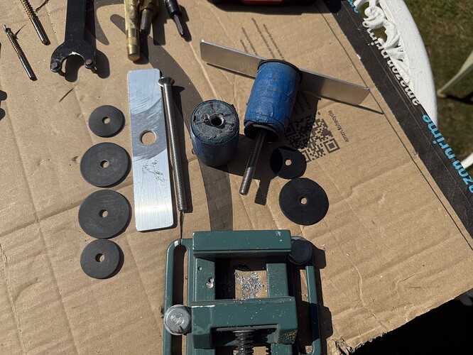

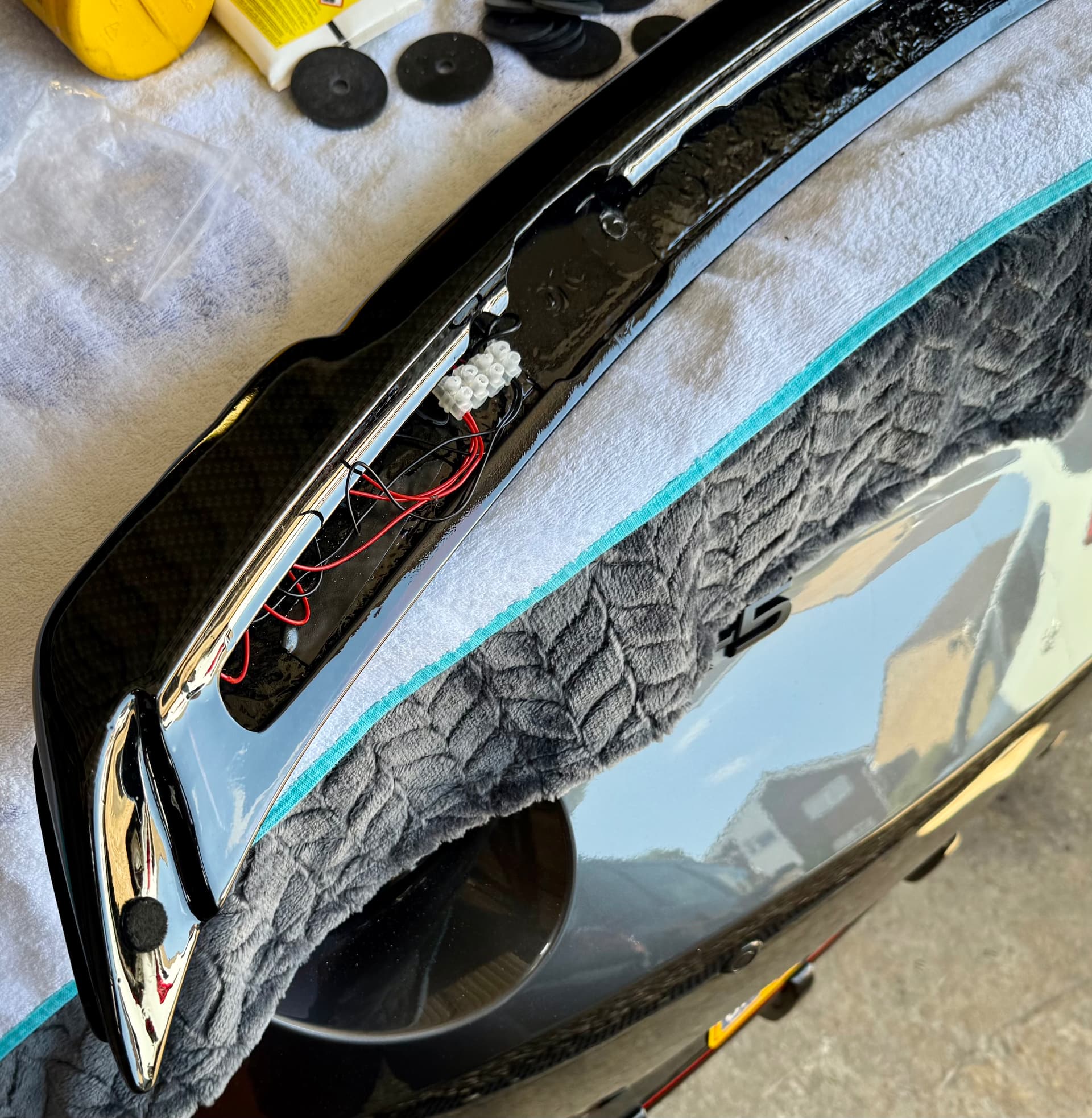

part one today …24 Aug strip down and make new mounts

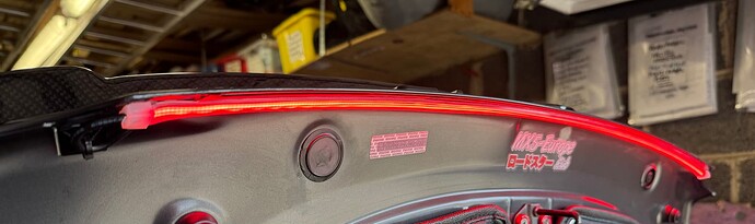

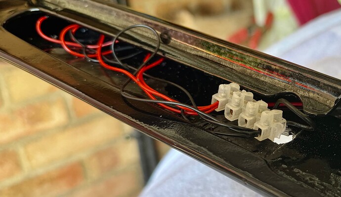

takeout wiring replace and fit new leds and connectors

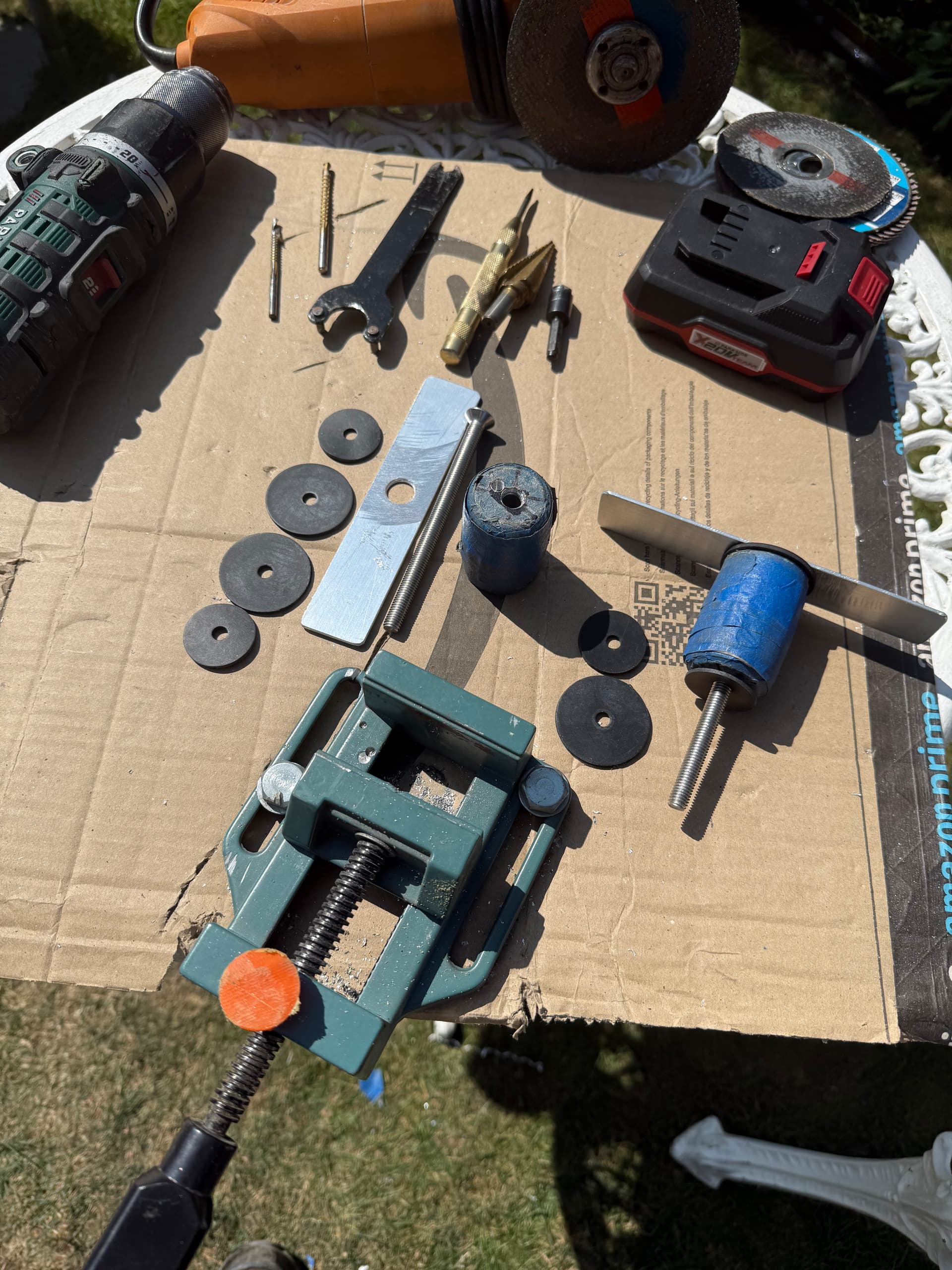

New mount hollowed out aluminium tube with plastic insert for wiring and one bolt through mount per tube rubber washers to take out vibration to be added to the rear boot tomorrow
thank for taking the time too look … :wink:

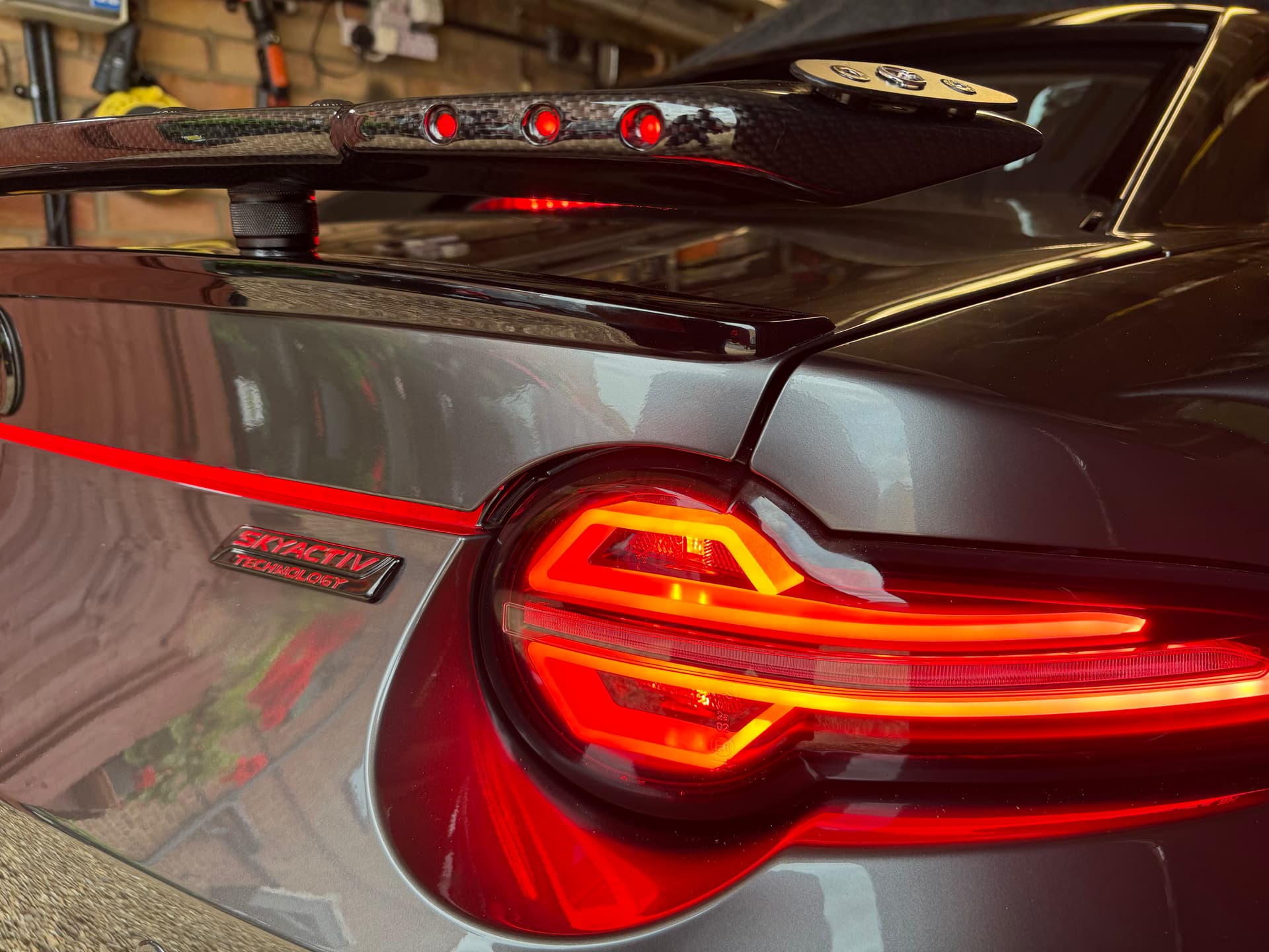

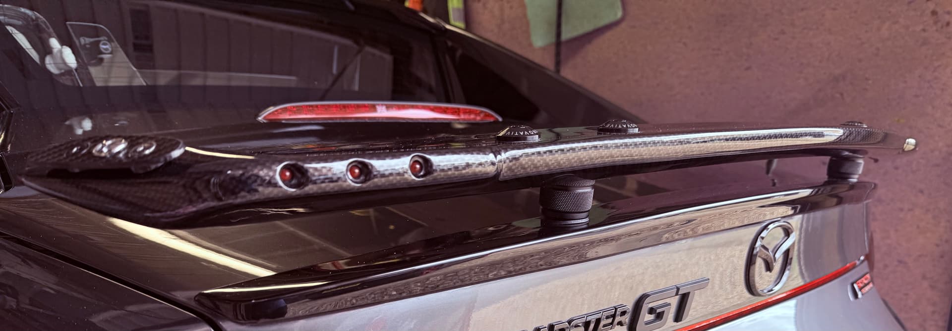

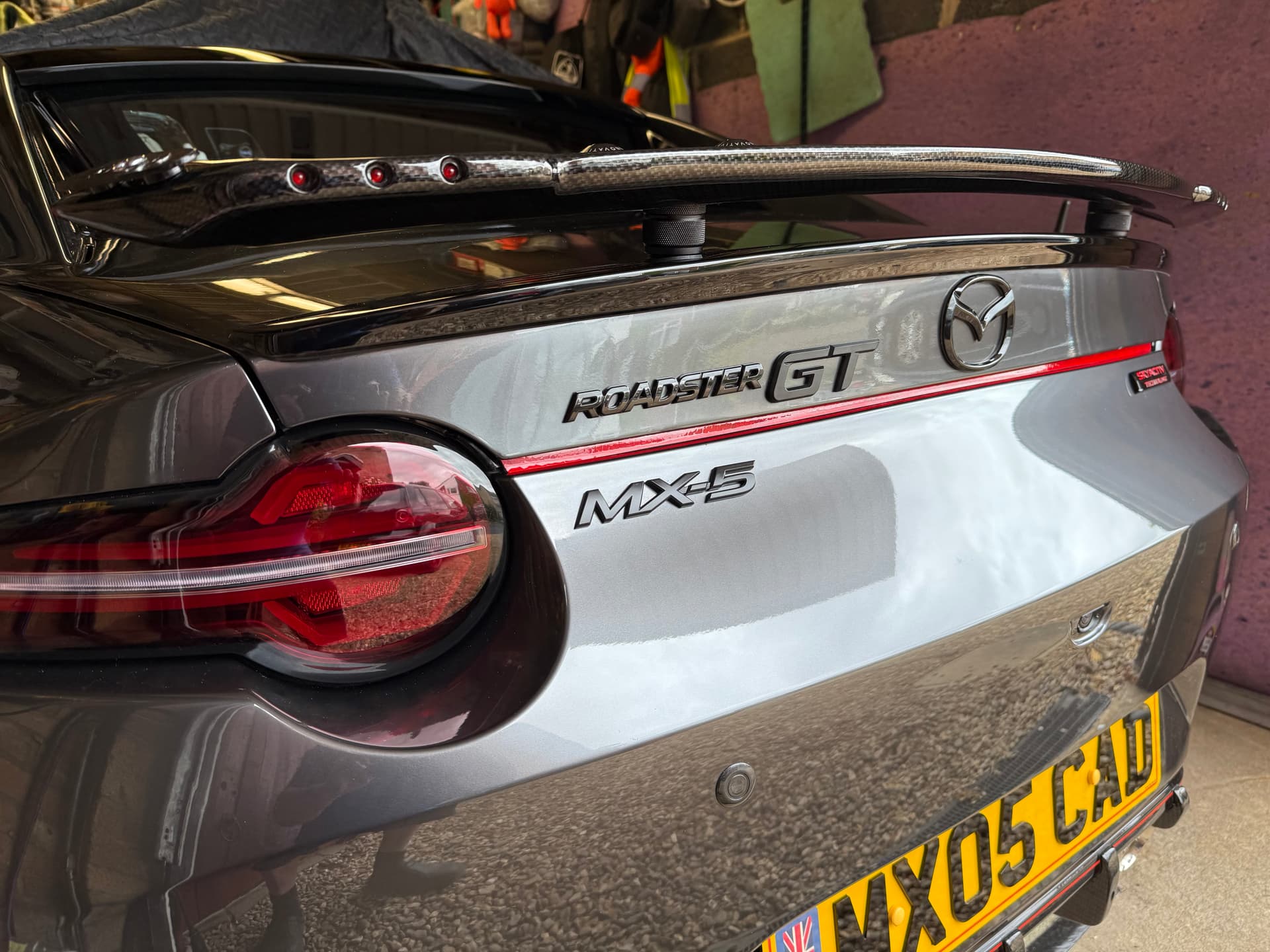

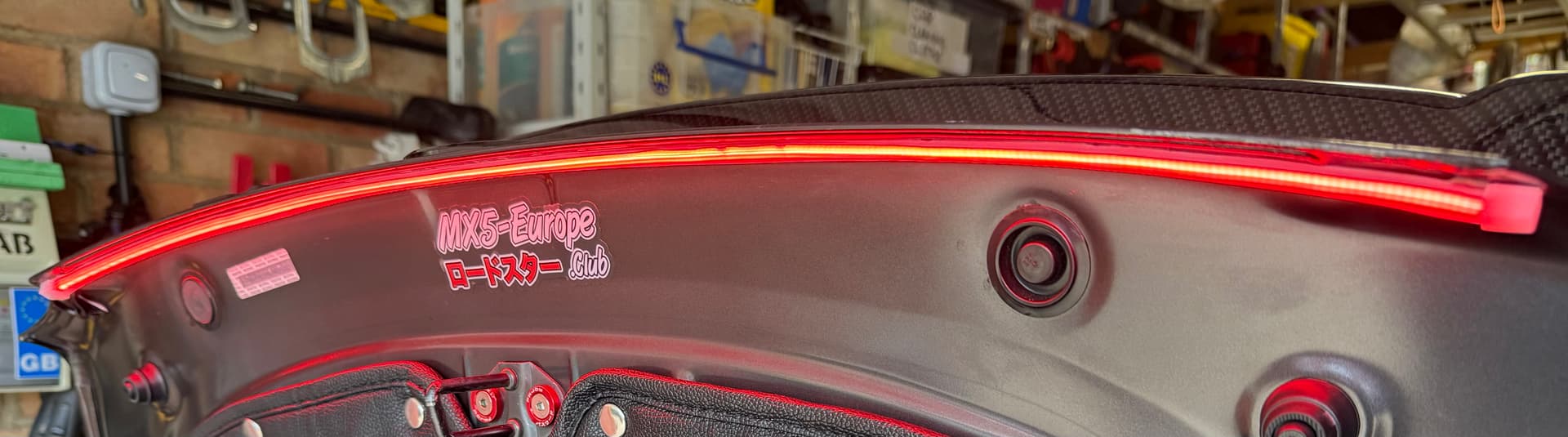

Part two now fitted new boot strip brake light new high power spoiler led’s fitted new spoiler mounts with rubber anit vibration washers its all come better than I had hoped boot spoiler now completed …
