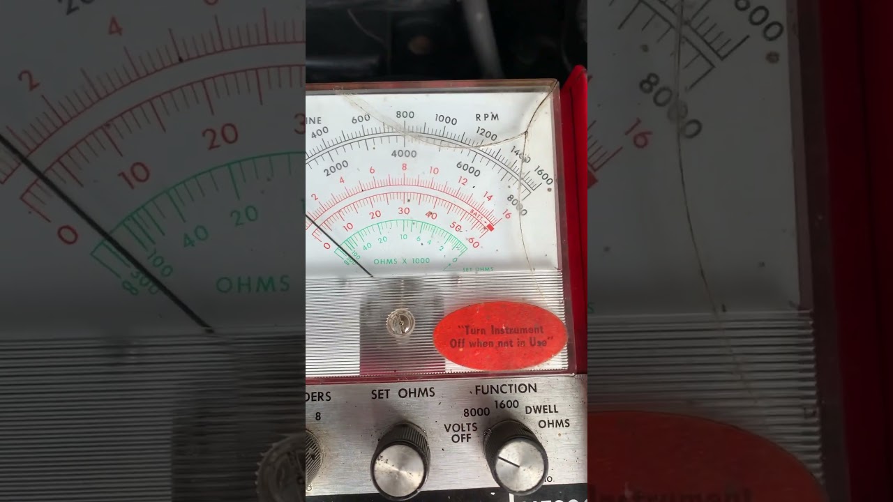

Couldn’t work out how to use the diagnostic plug but here’s a link to a video I’ve made using my NA. The O2 sensor plug on your car should be on the front of the engine. I pushed a bent paper clip down the side of the wire. With a warm engine you should get that swing in voltage from the blue wire. Slowly at idle and faster at 2000 rpm.
Interesting, my mk1 was borderline O2 last MOT. I plan to check the output of the sensor with an oscilloscope in two weeks time. If I can find a way to capture the waveform I’ll post it.
