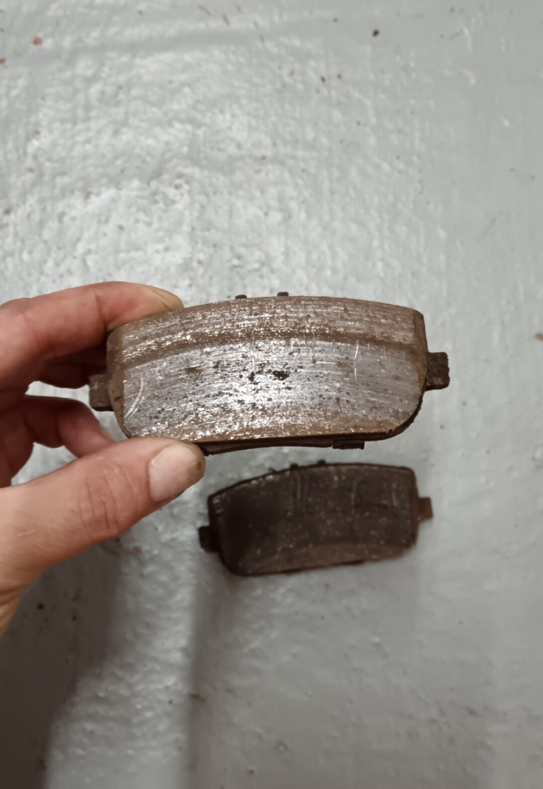

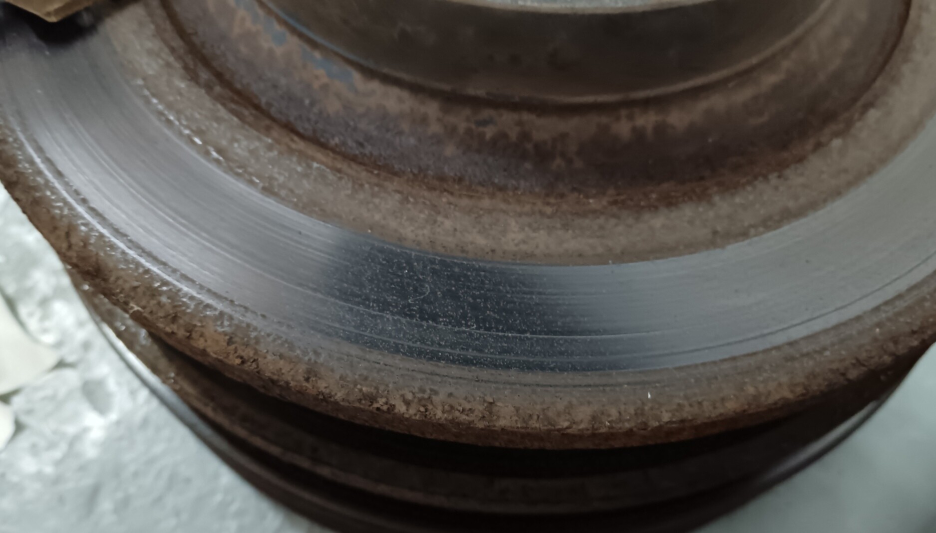

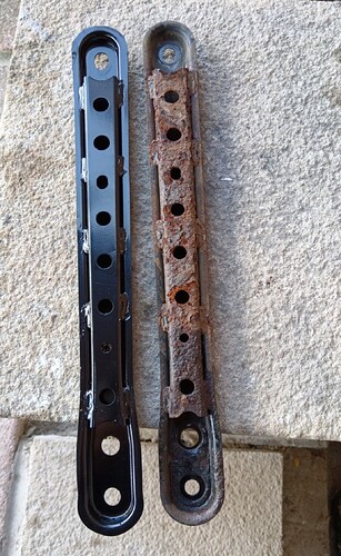

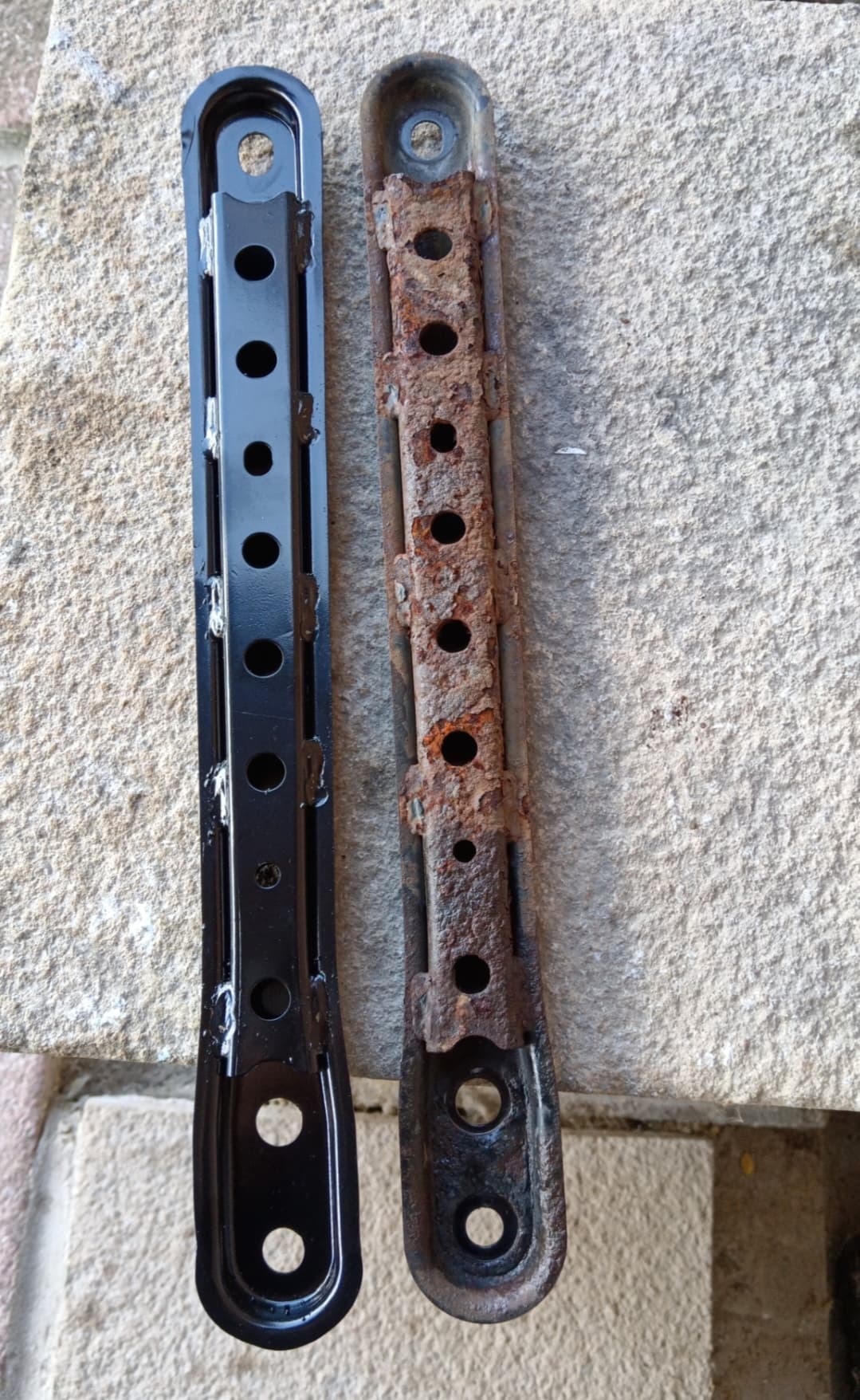

Those subframe braces aren’t an indicator of the overall condition of the car. My car is in great shape generally but they were rotten - I replaced them both for 60 pounds with brand new items. Brakes are probably where the car has been sat and the discs and pads have suffered from heavy rusting causing the fluctuation on the machine, another common thing for what is generally a second/weekend car that also may have been sat on a forecourt for months. Aside from the items mentioned you’d have to note the condition of the underside, subframe, body etc in general but for 8k on a 1.8 I’d just keep looking for one without the issues.
Edit: these items came from an otherwise really nice car, first things I did when I bought it.
