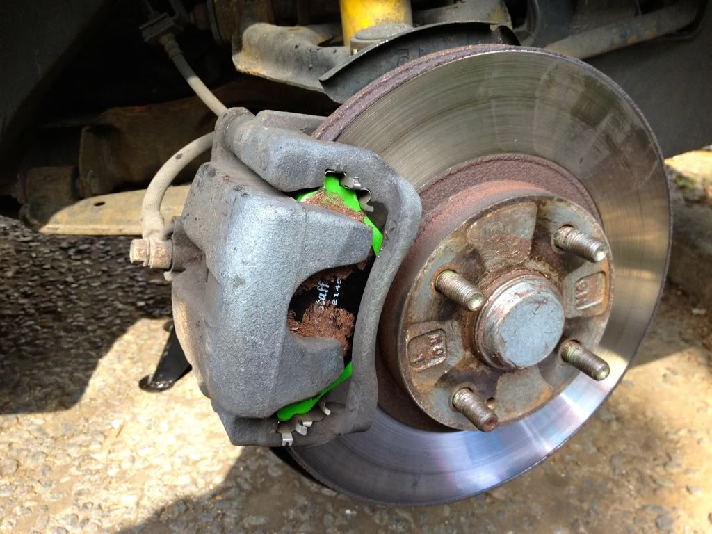

Finally fitted the brake pads today, they were indeed the correct ones and fitted perfectly:
New pads installed
