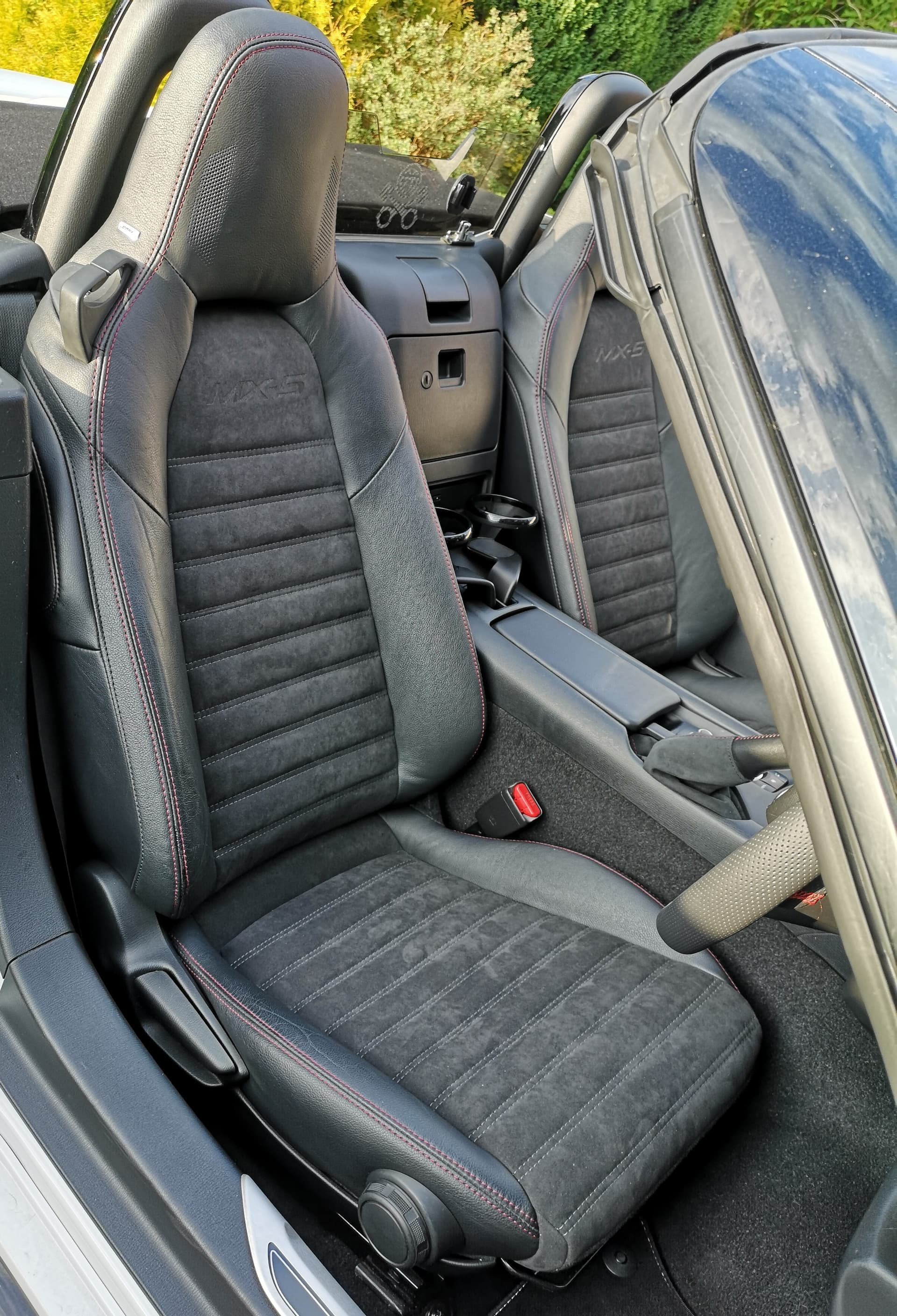

Hi, sorry to go back a couple of years in your thread, but I want to ask about your seat upgrade prior to the recaro’s. I feel the seats have low lateral grip and with the air bag, heated and Bose, options are limited.
How did you find the seat long term with the alcantara? Would you do it differently if you did it again? For example the side bolsters in alcantara instead of the centre?
Thanks in advance
I’d do it exactly the same way mate. Maybe add a but more padding to the base but apart from that they were really good. Instantly felt stuck to the seat rather than sliding around and they looked miles better, pretty much the same as 124 abarth seats. As for bolstering, that wasn’t any better but there’s not a lot of room to play with in there - seats still felt a but narrow and flat. Bolstering would need changes to frame to have any real support.
Thanks, that helps a lot. Think they are the perfect modification for the seats without going down the replacement route. Like the recaro’s but boy they are expensive even 2nd hand😳
