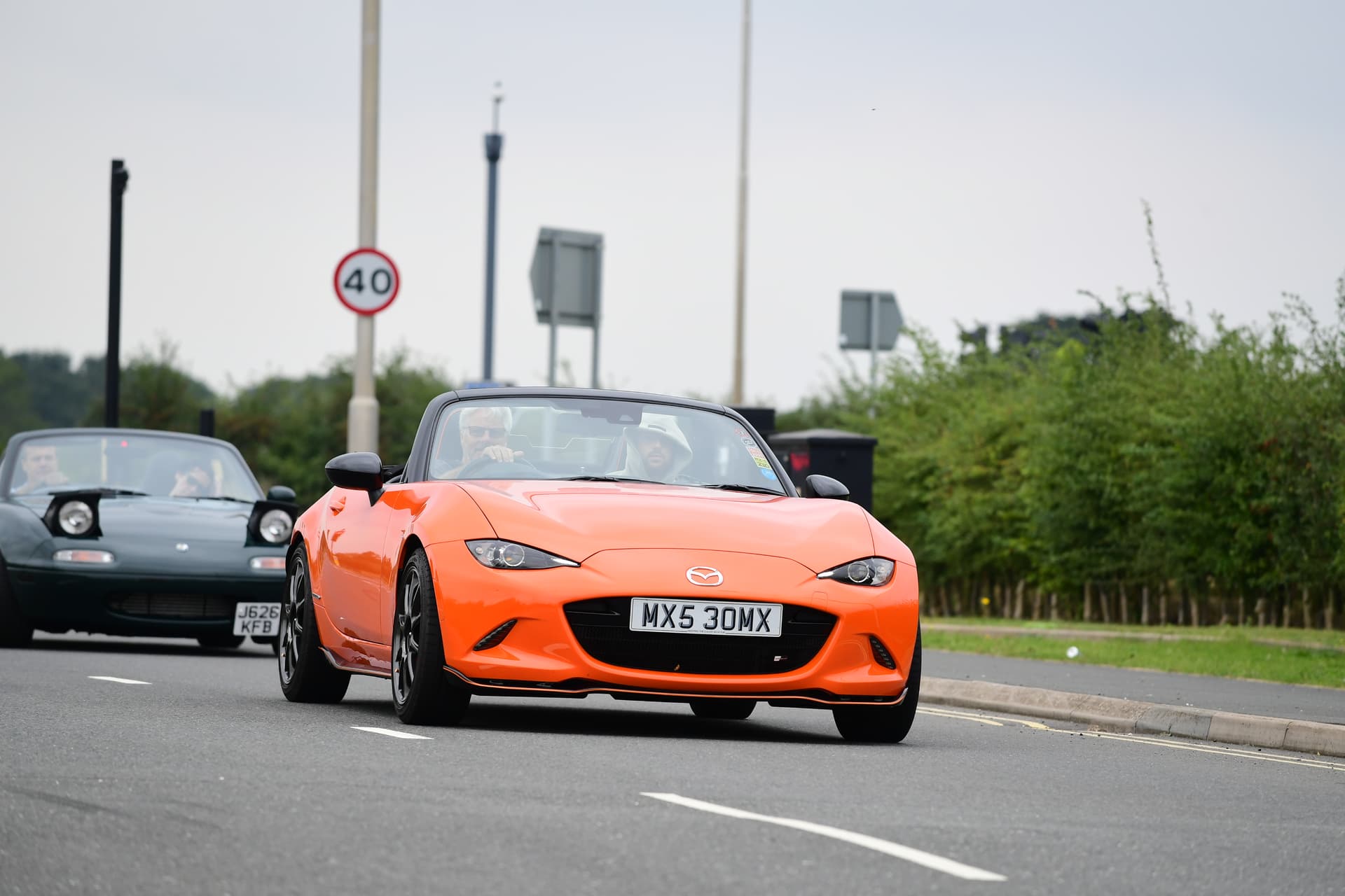

I’ve not noticed any excessive tyre wear and Ive been running this for a couple of years now. after fitting 25mm spacers front and rear and included a picture of how it sits and looks on the road.
Can you remember what boot spoiler you went with? Yours looks a little more aggressive than the genuine Mazda one.

That’s a rather ‘ happy accident’ of a number plate👍
