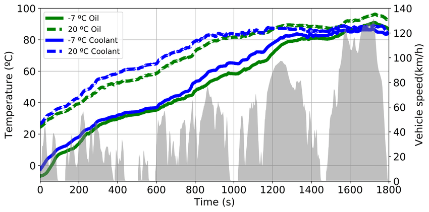

A quick search and I found this graph to show coolant temp versus oil temp over warm up cycle
My understanding is that the temperature gauge shows the temperature of the cooling system, not the oil temperature which is more important. To illustrate, a liquid cooled motorcycle may show that the engine is up to working temperature but if you put your hand on the crankcase (the equivalent of a sump on a car) it may only be warm rather than hot.
In addition, if the engine remains at tick over or even a fast tick over, say 1500 rpm rather than a normal driving load which may be at 3 or 4000rpm, the oil is unlikely to reach its correct operating temperature.
Interesting. I would point out however, that a stored vehicle in a garage is unlikely to reach 120 kph*
*unless it is on a rolling road
