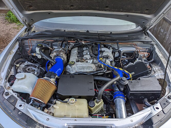

This is how the engine bay will look
Had a couple of issues, the egr surface wasn’t prepped correctly, as it had to come off to get the engine in, do with a new gasket it had a coolant leak
The main radiator hose also had a hole in, thankfully it was at a place I could mend it, if it was damaged behind the engine then chances are the engine would if had to come out, but fixed this with a hose connector and cut out the bad bit, this was probably caused by all the movement around there when lifting and dropping the engine.
This has stopped the leaks from what I can tell at this point, collect has gone around the system, but won’t be able to find out more till I start her up and add more pressure (blew down into the cooling tank to get it round at this point)
Another issue that might be an issue, will find this out later - the oil filter turns out to be a bad placed one, unlike a lot of other cars, the filter housing is permanent and the filter comes out of this, meaning it may need to come down the length of the filter… If this is the case I’ll probably have to switch this out to the mx5 filter housing as the gasket looks to be identical for this… I’m struggling to get the filter loose at this point and will attempt this on a car lift.
I also found 4 pin hole leaks in the down pipe, this is going to be fixed in the next few days (I hope)

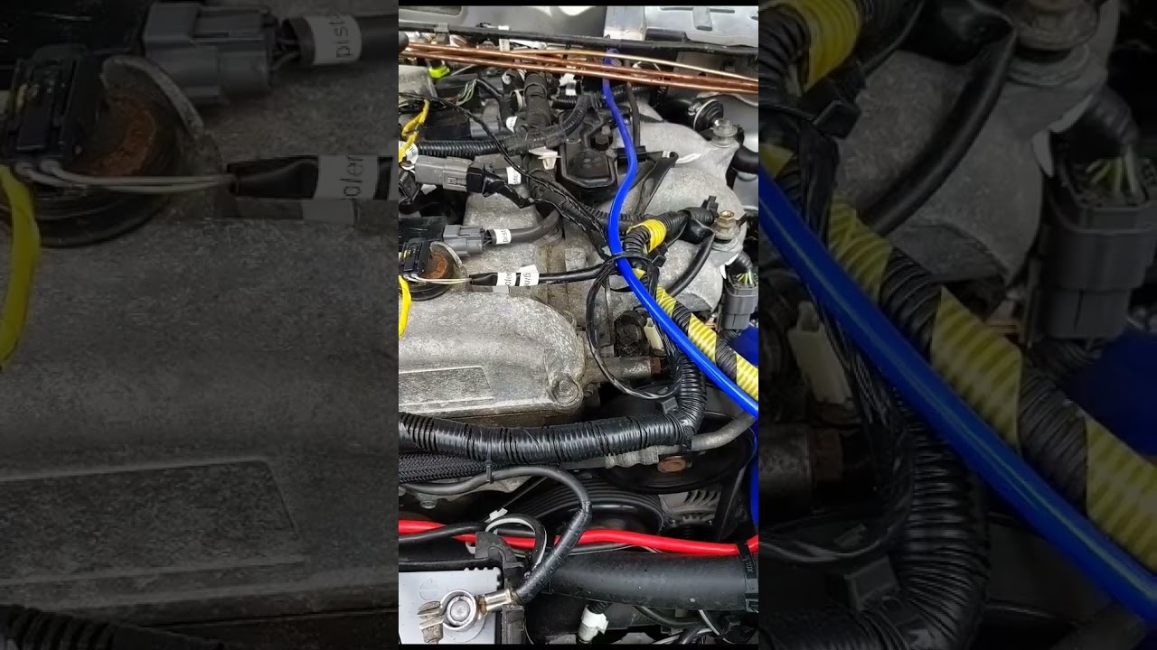

Another day (week) another update, this one is the best news yet for the project - after a few setbacks including the above I have today, finally, got the engine running and idling
I still have some issues to resolve but the big question of if I had made any major mistakes and was the engine just going to blow up or have an issue are fading away!
I got an engine coolant sensor issue - I think this is just a connector come lose after tuging on everything (I belive I may of damaged the plastic houseing for the connector so would explain why it came off)
Turns out the issue above was a ground I missed, due to its position I think the throttle body connector was not in properly either, that seemed to move on a little more and after that the engine started, at first rough, then idled really high for a few seconds but after a few min and a few more restarts you get the above sweet sound!
Still got some work, things are temporarily held by cable ties as I wanted to keep them from ratteling or getting too close to the exhaust, some things to round of so they dont cut into stuff and welding of the sills - which means more updates to come!
