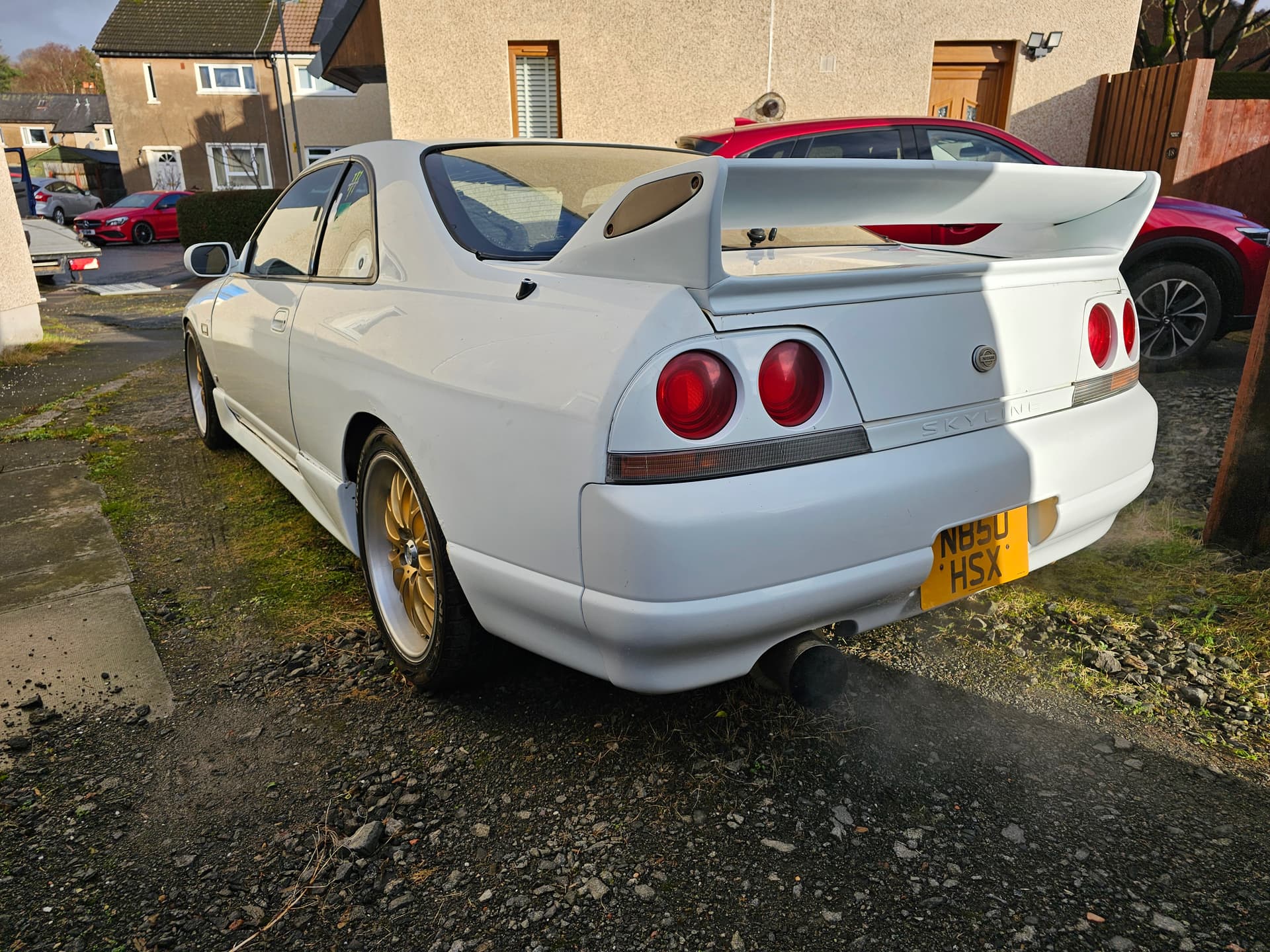

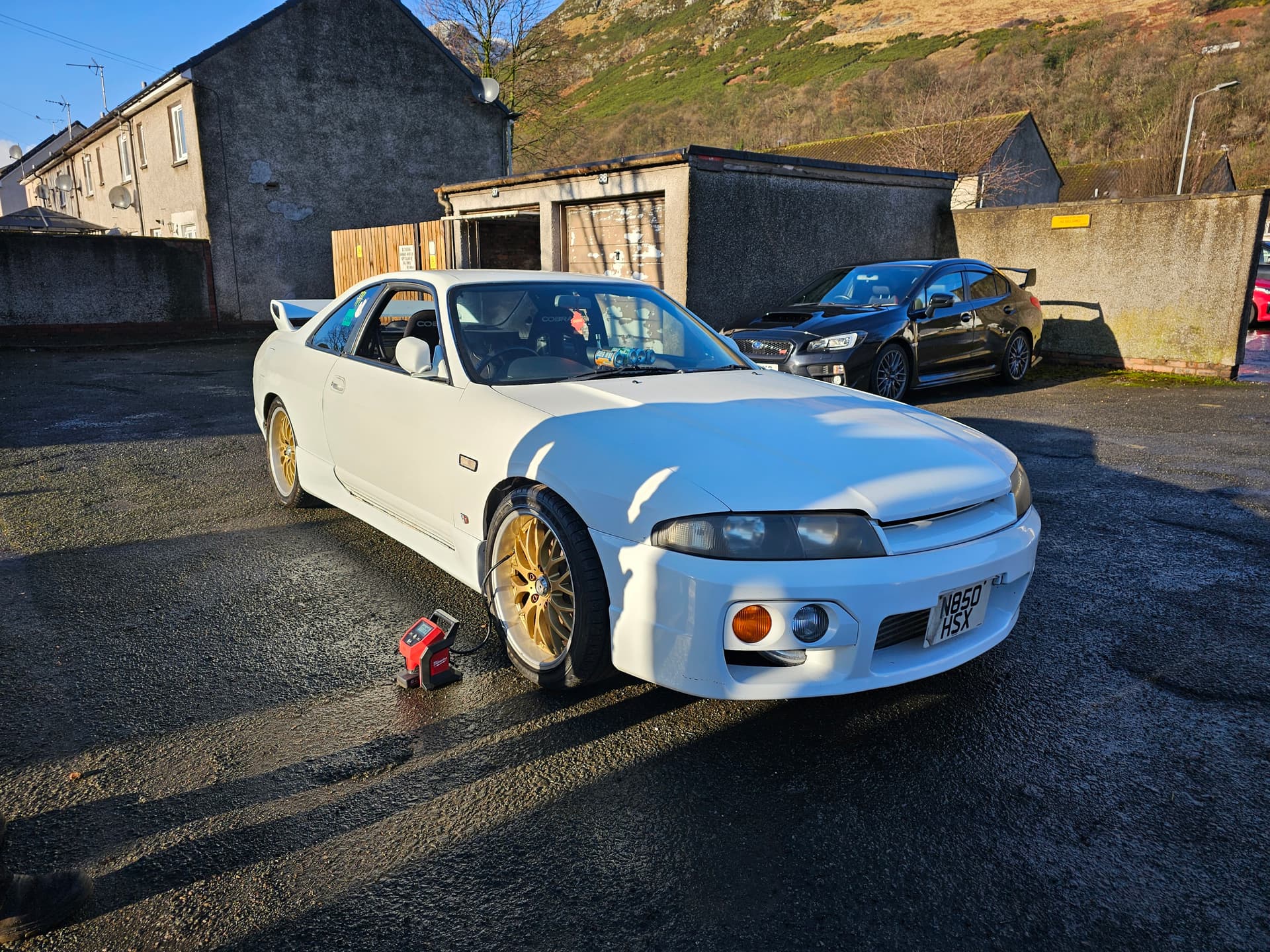

A new project has come up for sale which im going to have a look at on saturday.
Updates soon
