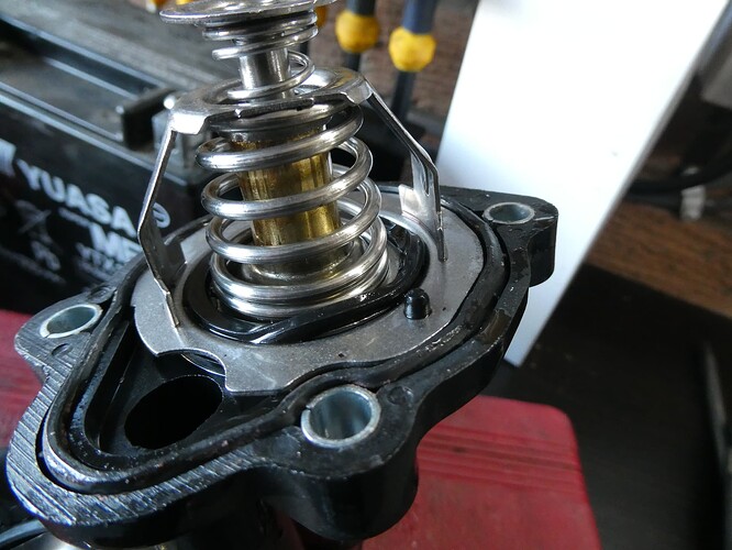

The one that came out had somehow dislodged its seal and was always open a little.

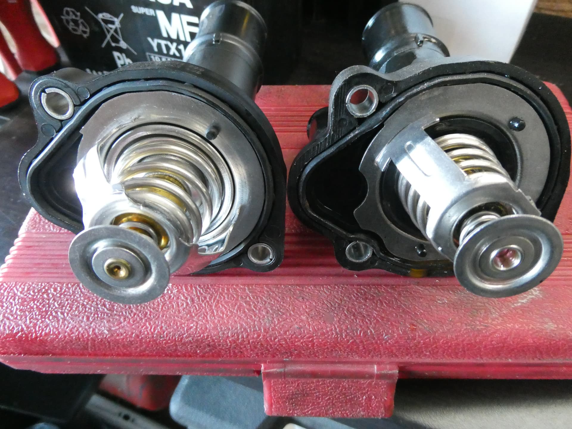

The removed one on the right - with a rubber seal vs the genuine Mazda one on the left ( no rubber seal just a good fitting piston )
