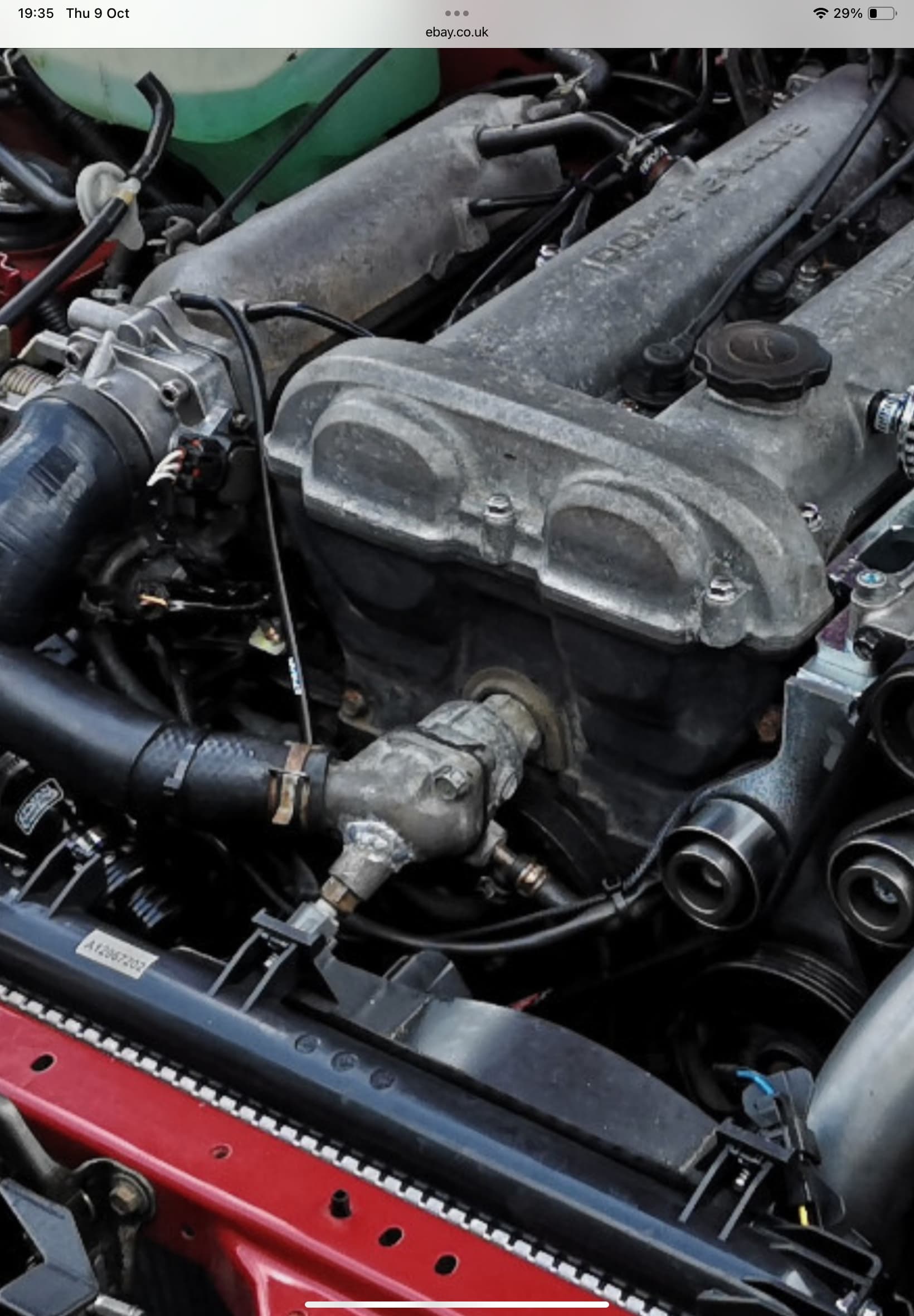

The thermostat is on the front of the engine it looks like this.

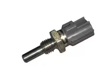

On the back of the engine there is a water temperature sensor which looks like this.
Which one was replaced?
The thermostat housing is in the centre of this photo.
Sorry got confused, it was the temp sensor which was at the back of the engine. Thermostat was 100% replaced at the same time.
