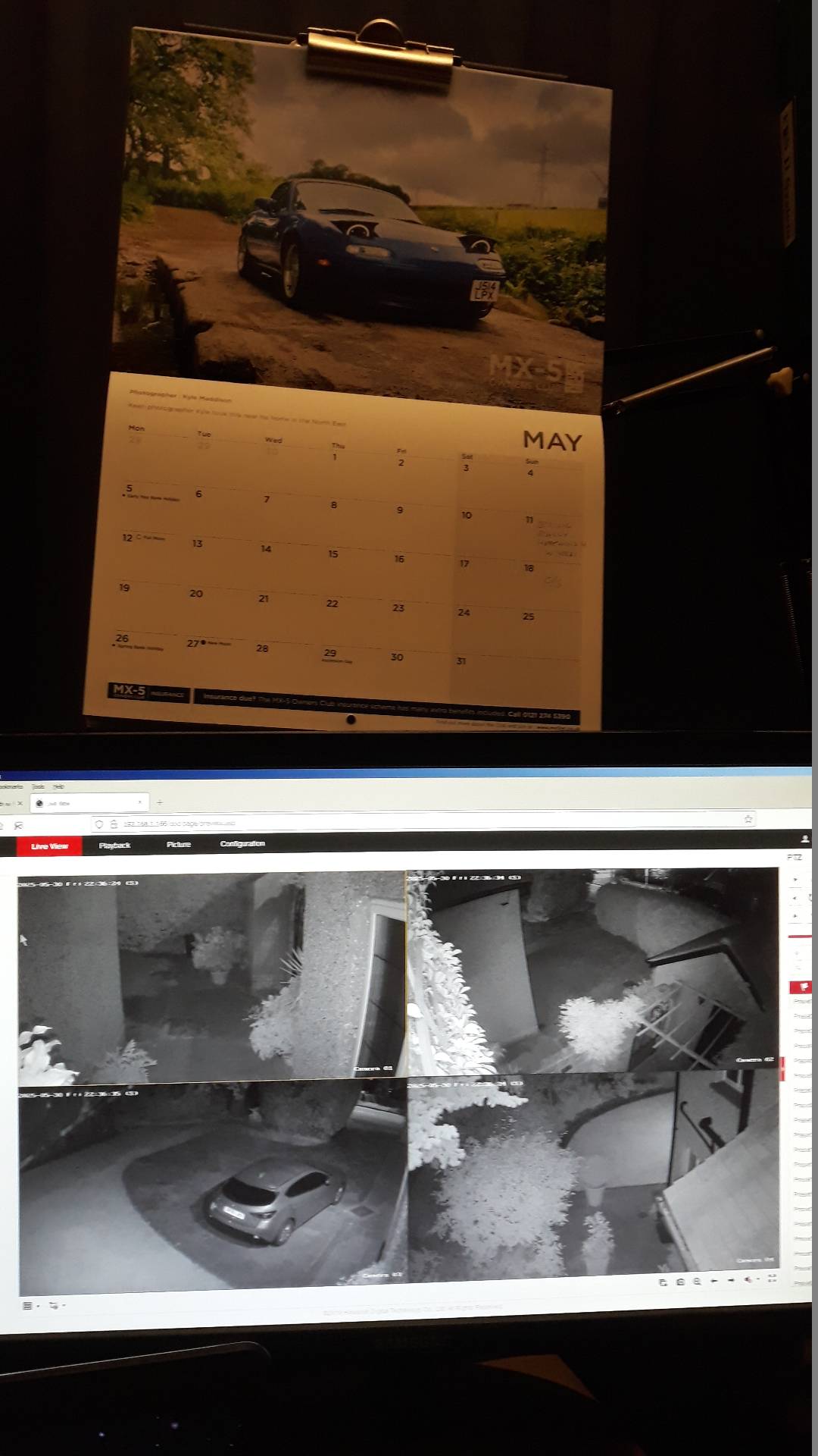

The benefit of the hard wiring connectivity meant that the third generation of cameras were plug and play while now being full HD and with superb night vision, and I can have up to eight including POE (Powered Over Ethernet) and PTZ (Pan Tilt Zoom) before the recorder wants to be upgraded for more channels.
Alas, now the excellent Hikvision (made in China) system I use has been heavily frowned on (rightly or wrongly) by security conscious people. So I don’t let mine have internet access.
Here’s a lower res phone photo of local network showing nighttime views taken a few minutes ago gathered on a PC screen. The TV’s in bedroom and downstairs also can watch this HD output. Useful to see who’s calling
