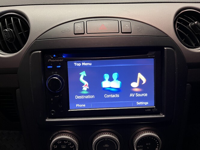

The Current Head Unit is a Pioneer AVIC-F710BT, which is not hooked to the steering wheel controls & does not support Apple Play. Has anyone recently replaced this head unit (direct replacement) with a unit which supports Apple Play & can interface with existing controls on the steering wheel?
I have been recommended a Pioneer SPH-DA360DAB, but not sure you can connect to steering wheel controls. Any suggestions will be welcomed.
