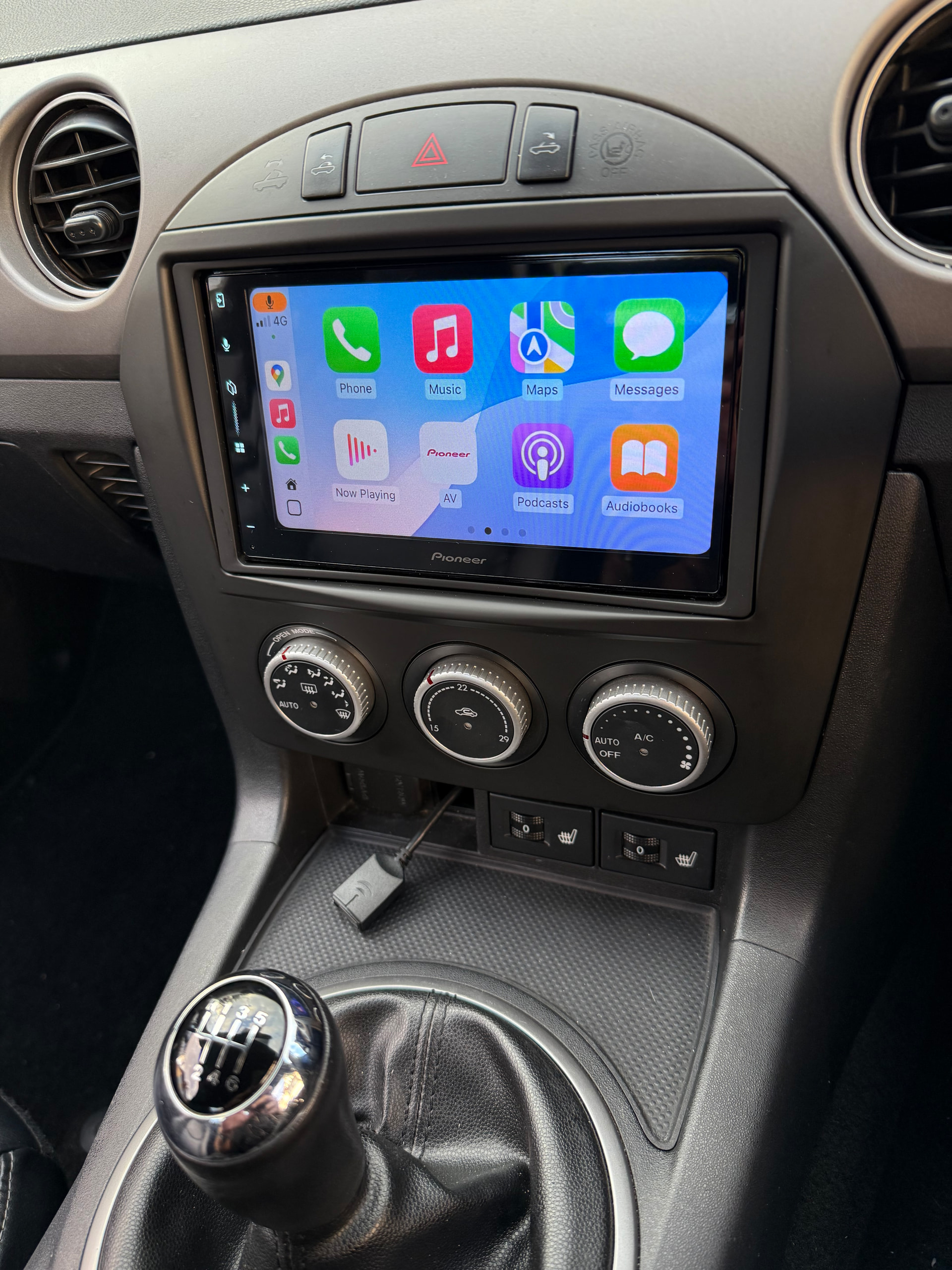

Been modifying my NC for about 10months now, may have to start a thread, the head unit this has been a brilliant upgrade.
Went with the pioneer SPH-DA77DAB, sounds amazing with the existing Bose speakers.

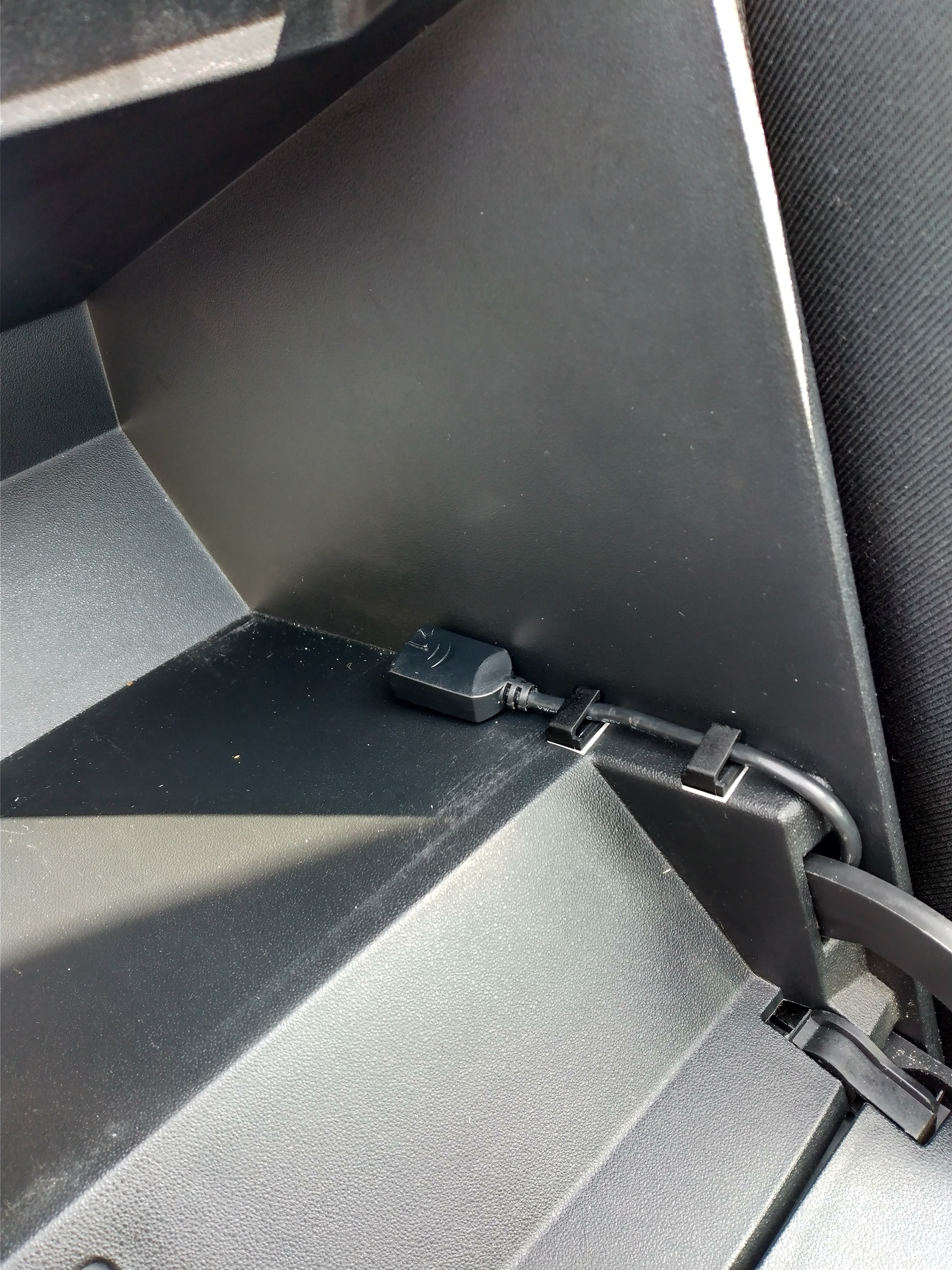

I routed my usb to cubby hole through the centre console.
I have the same unit in my NC3, pretty happy with the sound. I routed the usb to the centre console & wired in a cheap reverse camera- definitely worth the effort.

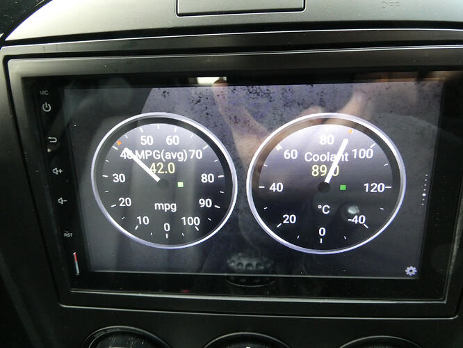

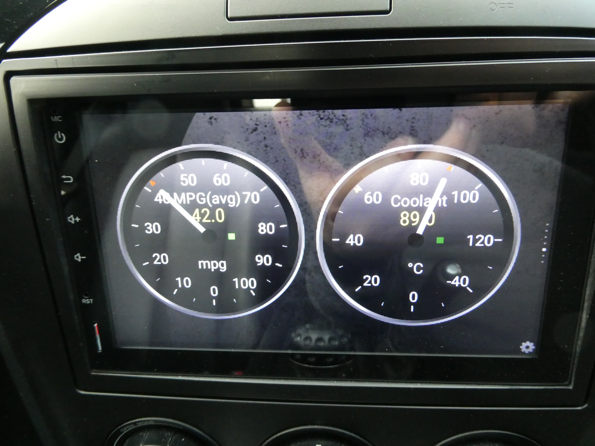

Hi I regularly use the Bluetooth OBD2 dongle connected to my phone to check for problems & monitor readings. I would like to have the option of those few real time pids & gauges for monitoring on the fly & on that 7” screen- just because it’s there really.
Of course an android head unit would have worked perfectly for that but I wasn’t very clued up about these things at the time ![]()
That’s a nice clean job.
I wanted to 3d print something for the hole to keep it looking OEM+

That was part of my reason for installing an android based head unit.
Torque is installed and operated just like on the phone.

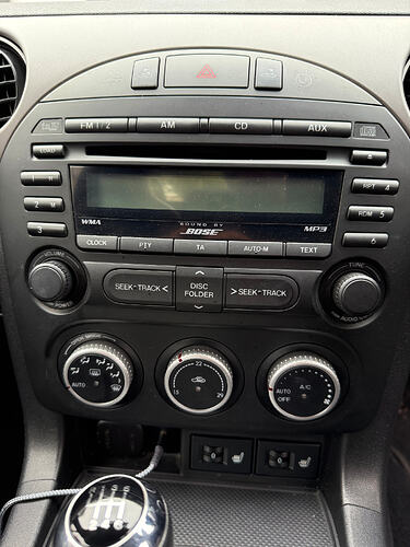

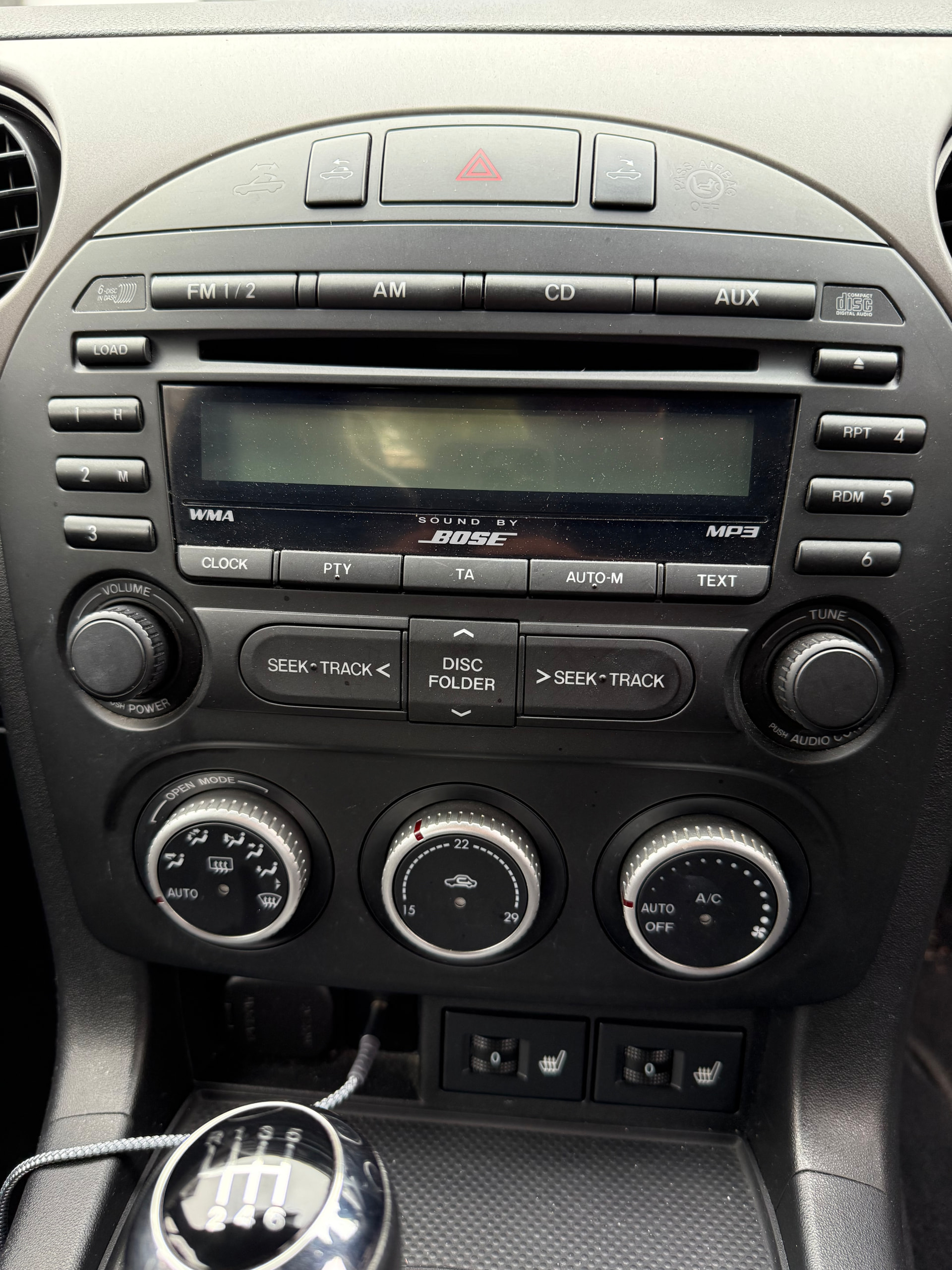

What did you do with the old Bose radio?
Boxed up in storage, are you looking for a head unit?
Whilst mine is still in good Nick, it is the non Bose version. Just wondering if it’s worth upgrading
The BOSE head unit also requires the amp from the rear to make it work and the matching speakers.
