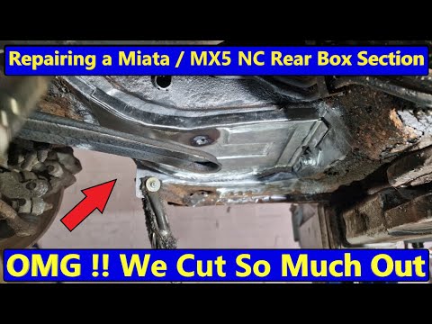

Hi @FE_Kitchen. Felix, I had some welding done to fix that hole, fairly straight forward I was told and they see it a lot! Had both braces changed, the one pictured was rough, had to be careful not break the nut welding inside the frame.
The other side was done by DFTR in Dudley, they do they all the time but honestly I’d managed to loosen 2 bolts myself. The petrol tank sits above it so you have to be careful if you want to heat it.
Welding, parts (from MX5 Spares inc new bolts), labour and include a gearbox and axle box oil change, £400 or just under.
Hope this helps. Iain

Welding was for a hole as seen in the picture, common fault.
Loosening them, lots of WD40, some heat and a long bar on a wrench!
The guys that did it fully have a special tool that breaks the tightness somehow…. Plus they had it up on a ramp which helps massively.
Find a good guy and I reckon let them do it. If you snap anything in your drive, it’s not going anywhere!

Here a good video of a box section repair, it can be done its just time and money.
