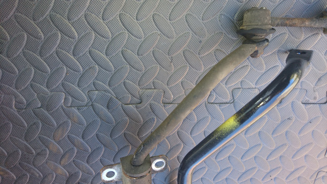

Front 26.5mm:
rear 16mm:
Haynes manual says you need to unbolt and tilt the radiator but this isn’t necessary, careful maneuvering from one side and you can remove it. The rear has loads of clearance.
It only became apparent how much beefier the yellow ARBs were when I compared them:
Hope this helps.
