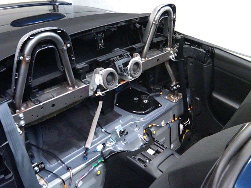

The parcel tray, a plastic shell behind the seats, is also a common source of rattles, especially with modified exhausts.
On my first canvass MX5 I had a similar rattle and eventually traced it to the rear plastics behind the seat. I took out the full plastic cover, behind that is the plastic bay for the storage, the feet on this bay were touching the metal directly and could move about, so I added rubber pads on all contact areas, sponge on all the plastic panel overlaps, put it all back in & silence.
That sounds like it is worth exploring @Olaup although, odd that mine doesn’t rattle when the roof is down.
@richardn is there anything that can be done to the rear shelf to eliminate it?
Exactly what mine used to do. I’ve never got around to taking it all apart but i put some foam draft excluder in between the vertical panel directly behind the seats and the horizontal shelf below it. Stopped the rattle straight away. One day I’ll take it all out and do something more permanent.
Take it out and put foam underneath it

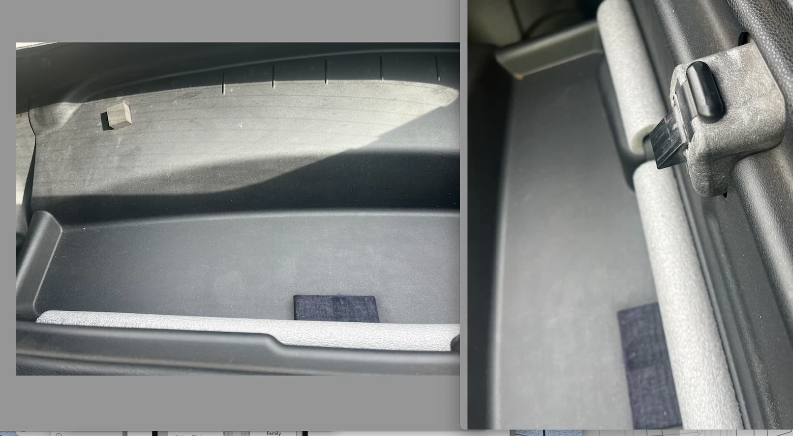

Found this also.
That was fixed way easier than I thought it would be.
I bought some 15mm x 13mm x 1m foam pipe insulation and side it over the end of the shelf and it’s totally stopped.
Cost 94p from Screwfix and I didn’t have to take anything apart or use any tools (apart from a knife and a tape measure) :smiley:
The only thing I don’t like is the colour, I’ll see if I can find some black.
The long section is 20 inch and the smaller section is 7 inch. Just slotted over the edge, no adhesive.
The roof can still fold down but slightly snugger fit.
I’m so chuffed with this, I’ve a long journey at the weekend and was dreading it with that noise it really grates after a while. And no noise at all now.
Thanks for your help all!
The only other thing that might be worth doing is putting a warm iron over it with a towel to flatten it down a bit.
If you cut the foam so that it only fits between the panels and not above the panels then your roof should clip down easier.
