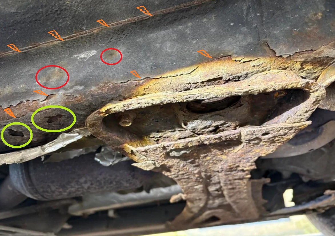

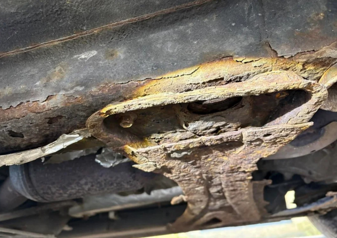

These images are the worst of it. The rest looks like its just got some surface rust, at least as far as I could tell.

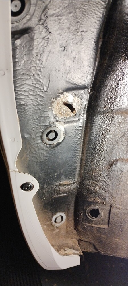

It does look like that chassis rail is holed, it’s not the normal place for it to rot as bad as that. I’d be looking very closely in the rear lower wheel arches, they in part are covered by the wheel arch liner. Right under the car at the wheel arch meets sill too, a prone area to rot…..
Here, this pic wheel arch liner removed…

The MX-5 rusts from the inside out and looking at that photo, it looks like rust is well established on the chassis rail.

Realistically from the picture you posted, I see rust pinholes in the frame to the left of(and likely under) where the sub-frame attaches. This indicates that the metal has rusted through entirely. Even if you remove all the rust from the bottom side and coat it…the inside of the frame rail will still have a compromised surface(pitting is rust) and compromised strength. Will it slow the rust down? Sure, it will slow it down by 50%, but its going to still be there until it is patched….and to make things worse, after you get it patched, you still have to find some way to paint it from the inside of the frame rail or the process will just start again(and no, weld-thru primer is not a solution…the process of welding burns the primer away, its a zinc coating that is meant to applied to a fresh weld, not prior to welding). You still paint the back side of the patch as much as possible before welding, but you can still expect the weld bead itself to have burned away any paint within an inch or two during welding. There are small sprayer tips meant for spraying inside frame rails, or you can make your own from something as simple as plastic tubing with holes poked in the sides…but no matter how you do it, painting inside of frame rails is a blind process. The times I have done frame rail patching were on cars that I could actually get to the inside from the end of the frame rail, but from my perspective its never been that much of a problem if you have a MIG welder(and other fab tools), some steel, and the time to work on the car. At this point, I just expect to have to to do rust repair to old cars like any other repair. In areas where salt destroys cars…don’t get attached to a car unless you can repair rust(or have a friend who can) because it quickly becomes more expensive than the car is worth.
Now, after all that gloom and doom: If I had to rate your rust damage on a scaled of 1 to 10, it would rate about a 3 to me. Requires repair, but not bad enough to justify getting rid of the car yet. The crossmember is in worse shape than the frame rails.
Hello again :slight_smile:
I think the two green circles are where it looks like the metal is perforated. Maybe clutching at straws, but I’m not convinced it is: It looks to me like they are holes in a layer of detached underseal, rather than holes in the (undoubtedly rusty) metal. You won’t really know until you can get under the car and have a scrape at it.
The orange arrows are where the underseal is peeling back, and is (IMHO) typical of what happens on MX5s. It really needs scraping off, and I’d expect you to find more rusty metal underneath.
The areas in the red circles show rust staining, and are also probably hiding rust scabs - again scrape it off. It’s possible that these are holes emerging from the inside.
I would try and remove the brace (to give you a clear run) and clean the area up (i.e scrape off all the loose material and get back to metal if you can). If it hasn’t perforated, and is rusting on the outside, remove as much rust as you possibly can by mechanical means (angle grinder with knotted or twisted wire brush and/or stripping disc) and apply rust converter to what ever rust that’s left. Paint it well (epoxy) and keep an eye on it. It will buy you a year or two - more if you do it well, and keep it maintained. You will then be in no worse situation than you are now (in this area, anyway!!).
I’ll stress that you need to remove the rust if at all possible. Rust converters only buy time IMHO, and they only do this if you’ve already got rid of most of the rust.
Ideally replace the brace with a better condition one from a breaker / aftermarket rather than waste time and effort trying to clean it up.
If the metal has perforated, it could well be an MOT fail, if within 300mm of where the subframe braces mount.
You could probably get an ‘MOT’ standard welded repair fairly cheaply, but be aware that this is often done by welding a sheet of metal over the holes. It then means that the car passes the current MOT, but it locks in all the old rust and moisture, meaning that the corrosion under the patch carries on regardless - possibly quicker than it would have done otherwise. This leaves a much more extensive area of rust and a bigger, more difficult repair that may well prove uneconomic down the line. The better way to do it is to cut out the rusted metal and let in new pieces, paint everything and use cavity “wax” of some sort, but that costs more.

Looks quite bad to me, I can bet when you start cleaning it up it will gradually start to hole and when that happens your screwed really as it just gets bigger.
As said you would need to remove the brace to get good access.
I would not use a converter on it personally, you can buy more powerful rust removal solutions but i cant comment on how good they are.

The two holes circled can be as you say, just flaky underseal. My concern and I’ve had it on my NC previously, just under in that picture the two holes is a flexible heat shield, that’s held in place by those plastic pop rivets (tree) type clips. On mine it started to rust around the clip holes, I had to remove the shield partially and grind back the surface rust and then paint. I put some new clips in and also removed and painted that cross member, it was rusty under and around the fixings for that too.
