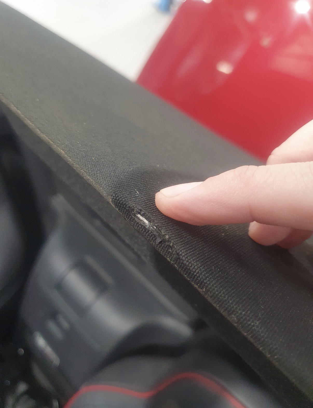

I found 2016 2.0 manual from a Mazda dealership. One owner, low mileage and they’re refurbing alloys and a couple more things. Very happy about these but I’m getting a little concerned about a tear caused by the soft top rubbing against the rollover hoops. The seller says there’s no water ingress but they can’t do anything about it. Should I worry/push harder or should I wait and open a claim with Mazda through the approved used warranty? Thank you in advance for your help and knowledge.
It’s probably a cosmetic rather than water integrity issue, you could patch it with a sealant material.
I wouldn’t rely on the approved used warranty as a it was present when you accepted the car.
This is a known issue that resulted in some soft tops being replaced under the original warranty. It comes about by the incorrect procedure used to lower the roof.
It is up to you but I would not buy a car with the cloth damaged to that extent and it may affect the resale value when you come to trade it in. On the other hand it is a 10 year old car so it is not going to be perfect. Always worth calling their bluff.

My 2016 ND is slightly damaged like this, but I’m not sure if it’s that bad. I can go in the garage and look if you like. Other things to check (which are evident on my Soul Red Sport Recaro) would be for rust on the black vertical metal pieces between the main window glass and smaller piece on each door. These vibrate and rub against other parts of the car and will rust over time. Fixed in later cars. Also look at the underside of the boot lid as mine has a bit of corrosion. The boot lid is aluminium I think so it’s not going to rust away, but check all the same. Finally get underneath if you can. It will have rusted unless it was treated properly and the question is just how badly.
Is the one you are looking at a Sport Recaro? I think I’m seeing the red piping on Recaro seats and the numbered sticker below the centre cubby.

So far all the NDs I’ve seen have got a similar tear so I probably won’t be able to find a mint one. If water starts getting in then it would be a warranty issue. The dealer is replacing the rear hubs bushings too.
It’s a Sport Recaro (good spot!) with 30k miles and 1 owner. Full Mazda service history too done every year.

To be honest I’m very happy so far, the soft top tear is the only thing that bothers me but I could always get it repaired if I don’t have any other option.

I did a DIY repair on my ND1 soft top using this
seemed effective, bonded the loose threads together and wasn’t noticeable. It’s cheaper on Amazon or eBay. Just applied a thin, flat bead along the worn section. It was still good when I traded the car in with a Mazda main dealer and they never mentioned it on inspection.

Thank you so much! This is exactly what I’d need!
Out of curiosity, did you start opening the soft top from outside or did you get the 3D printed spacers that lots of people in the US seem to install?
