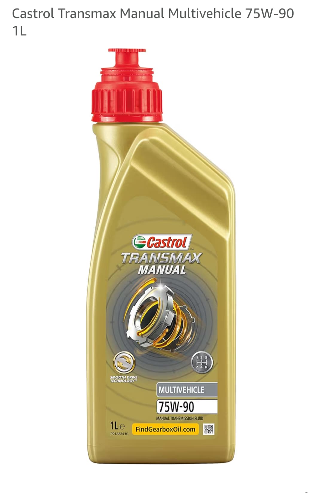

Now gearbox oil, well there are plenty of oil threads, some have been combined into one if you find them. One dedicated to the ND gear oils and engine oils you should be using. Opinions what’s correct what isn’t, what works what’s not so good rumble on. The oil that’s favoured ATM is 75w 80 or proper Mazda gear oil.
I’ve just bought some Castrol 75w 90 GL4 to use in mine, jury out whether it does the job, I can only report on that when it’s in. It’ll probably be a few weeks/months before I give it a go.
Misread the 75W80 vs 90 on the bottle. I might try source a bottle of that over the weekend so my guy can do both on Monday.
