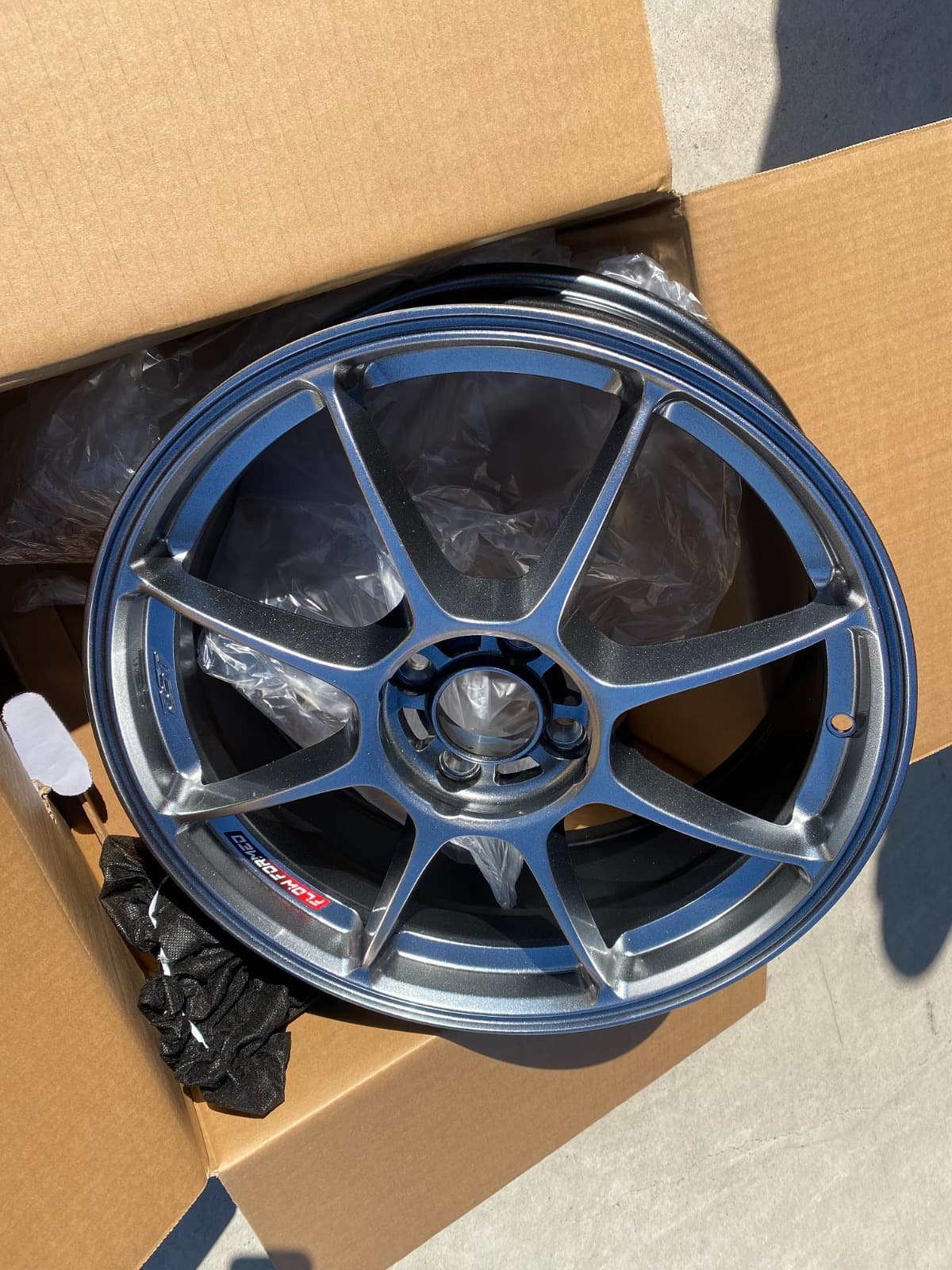

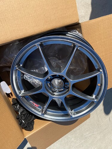

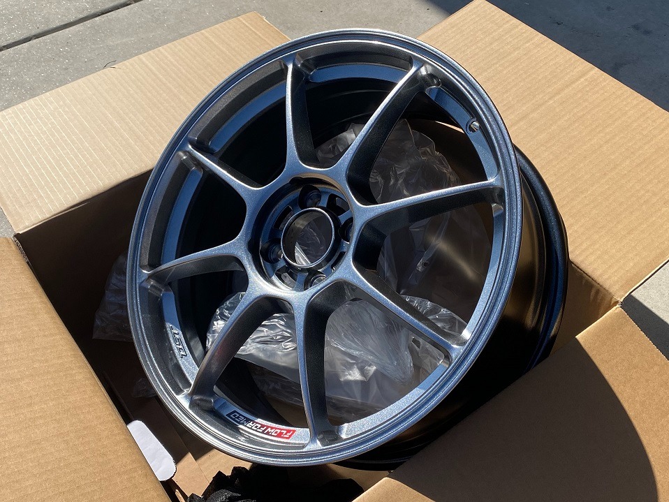

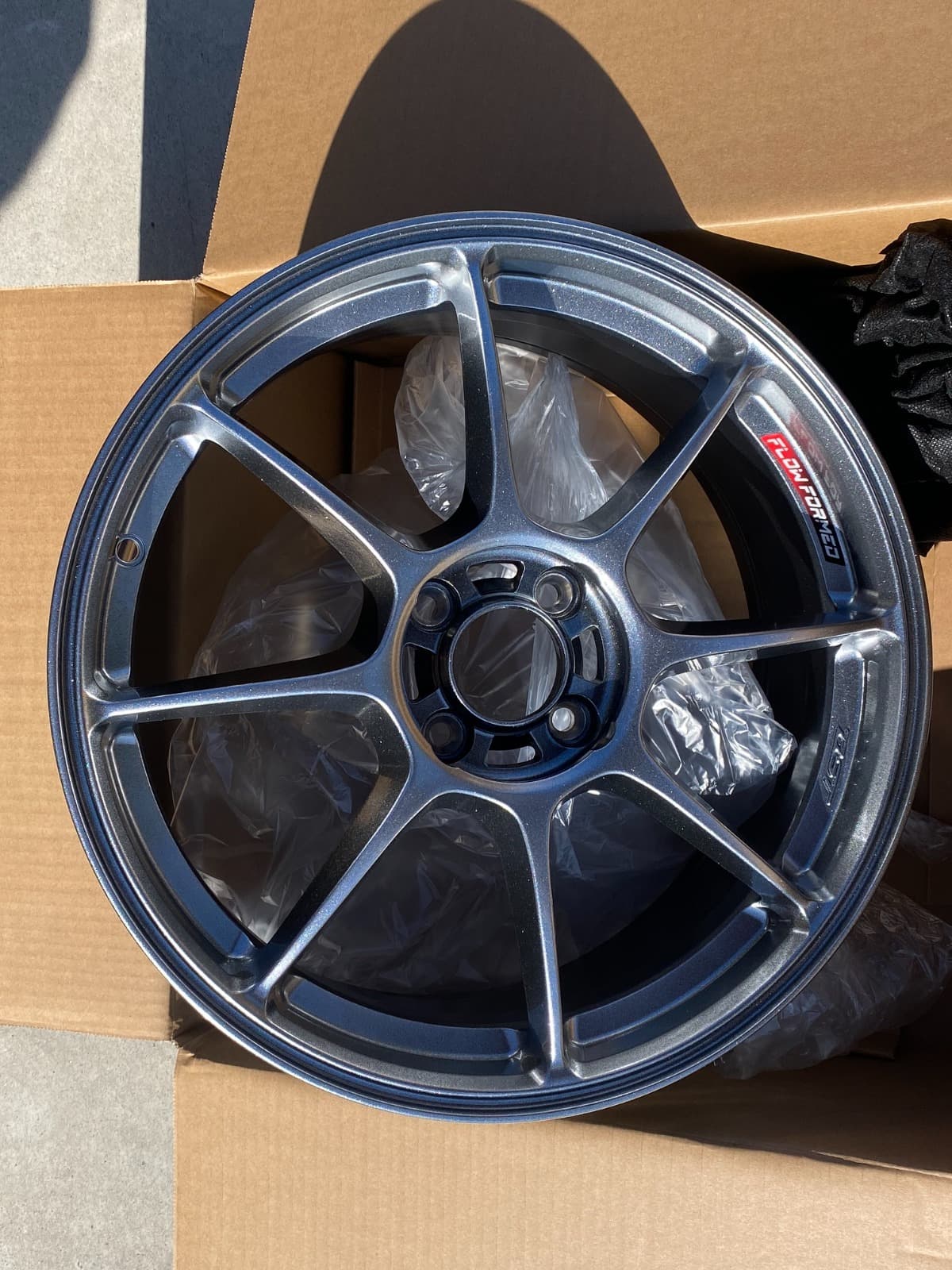

Chosen a wheel!
Slept on it. Got a local quote in case i dont like the colour :smiley: spoke to wheel supplier to check they had stock.
Sleeping on it again tonight, pushing Buy Button tomorrow.
arrives in a few weeks.
Thanks for the input guys. much appreciated :+1:
And they are…?
