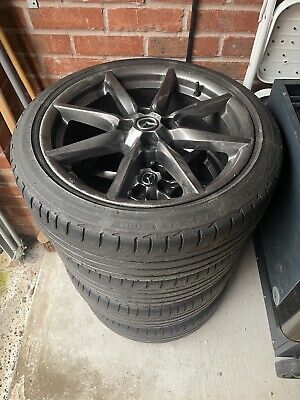

These might be of interest and dump the tyres.
Thank you, S.

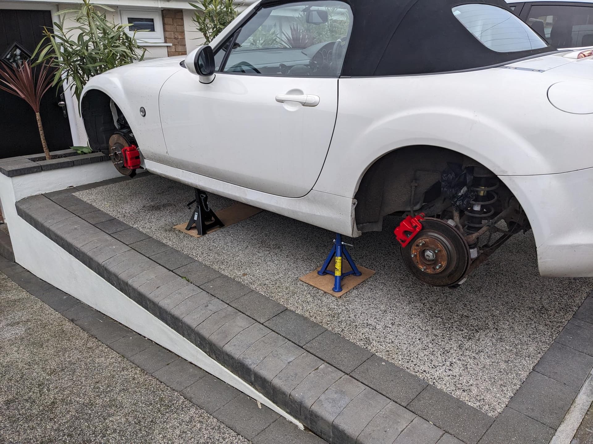

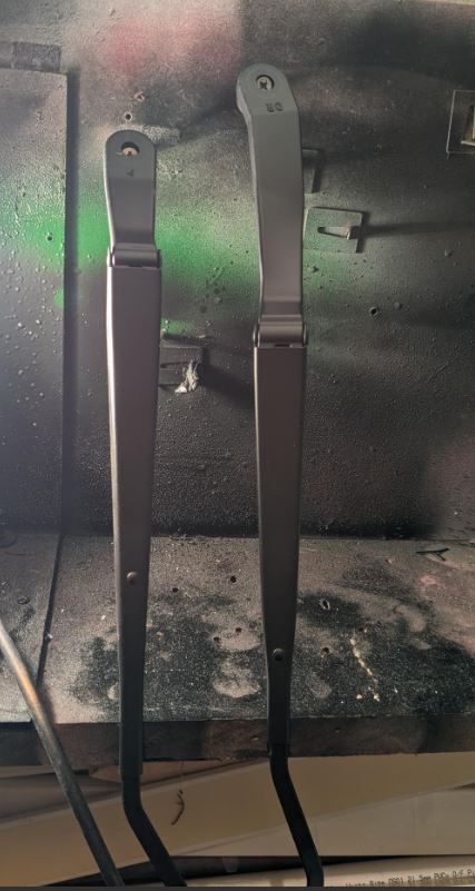

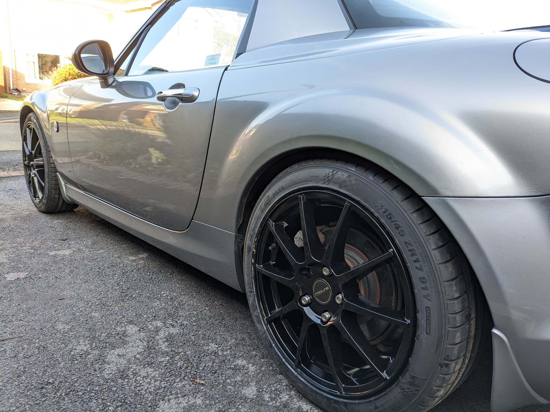

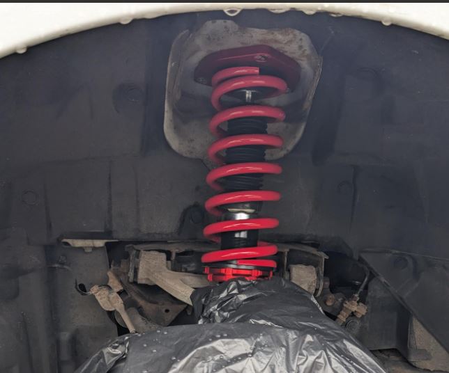

Bake pads done, all oils changed, new oil filter. Wheels powder coated glossy black, fitted with Pilot sports 5’s. Painted callipers. Meister R’s ready to go on. Have loosened all the relative nuts and bolts so should be fairly straightforward. Gravity rear box fitted. Fixed the dreaded leak into the passengers footwell. Painted the rear headrest things white. Still plenty to do but getting there slowly.

Meister R’s fitted. Took about 3 hours to get 3 done yesterday and did the last one today in about 40 minutes. Got a front one jammed which took a while to free up and struggled to get a rear out. For anyone fancying a DIY project, nothing to be scared of but definitely , drop the rear anti roll bar - makes getting the old ones out a lot easier.
Also don’t do the bottom bolts tight until the car is back on its wheels
