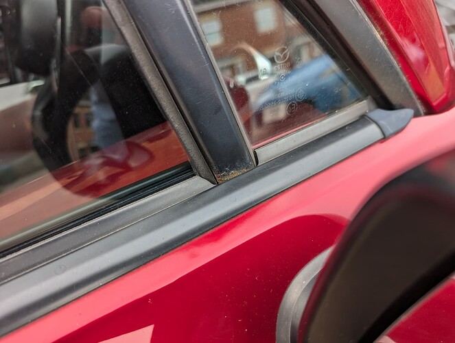

  1. My model of MX-5 is: 2018 ND RF
  2. I’m based near: Coventry
  3. I’m looking for technical help or recommendations on: Rust
I’ve noticed rust on the black window slider (not sure what the correct name is) where it meets the rest of the door. Putting aside my annoyance that Mazda still haven’t sorted what seems to be a common problem (I had the same on my NC) and Mazda’s refusal to replace it under their one-year approved warranty, does anyone know of a guide on removing it so I can sort the rust out?

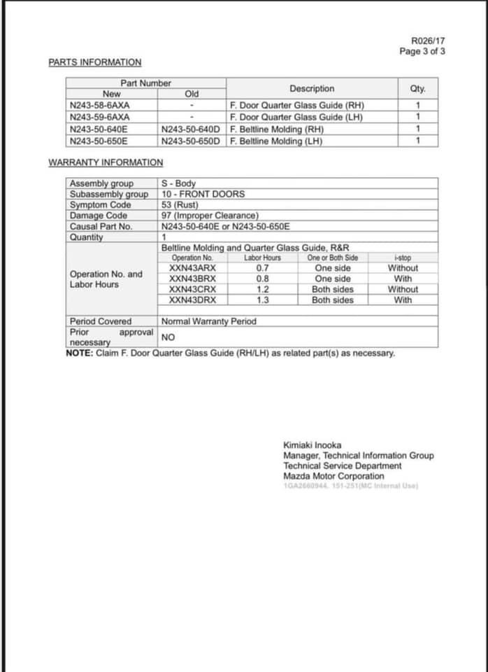

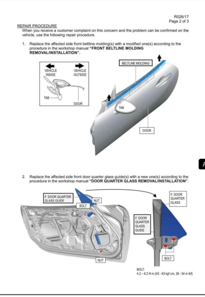

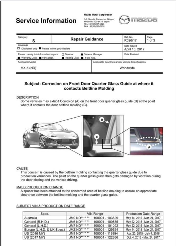

I need to do mine so saved these from a post on Facebook ages ago (last year actually). Do they help?
Just what I’m after, thanks very much!
The tsb for that issue was issues in April '17. Yours is a 2018 plate, so surely it was rolled off the production line after April '17.
