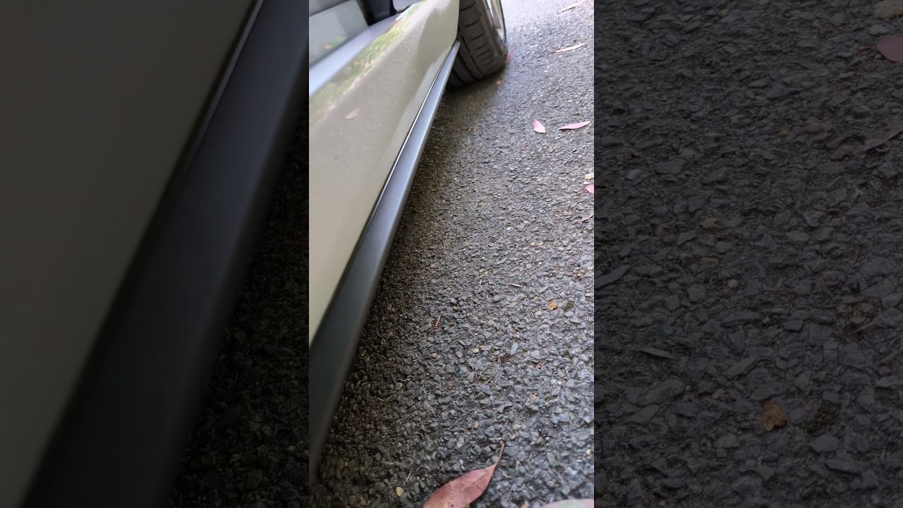

For 3. I finally recorded it
Yeah that really doesn’t sound normal.
Just diagnosed by Lodge Garage in Aylesbury today. Requires new gearbox!
Well, mine has done that idle clutch down stop noise, clutch up noise for nearly 8 years and is no different in that time. Same deal in many an ND in real life (as described above) I tried after listening to internet paranoia. Reading this earlier I asked ANOTHER person in Tesco carpark if he could try his (3k miles, 24 pate Exclusive line!). Bingo, did it too. There also was a TSB for the NC, when similar users also might have thought the sky was falling in too. TSB said it’s fine.
I admit that more whining sound when pushing the accelerator sounds different to mine though.
Still though, if they’re getting you a new gearbox etc. Says it all mind, even the supposed bullet proof ND2 V5 box isn’t really that. Saying that, I think the ‘glory’ ND2 boxes were '19-'21. Yours of course is later than that.
Sorry to hear that, if its any consolation my v1 gearbox was replaced by Mazda with a v5 at 10.5k, the car is going strong (despite now having a lot more power) without issue at ~24k.
If they said it needs a new box, did they say why? i.e what has rendered it needing a new one?
They said it wasn’t going into gear well (though I have to say it seemed fine to me - maybe new one will better?!) but also that gearbox oil was black and had swarf/bits in it. So def knackered. Symptoms mainly my point 3 and the video.
