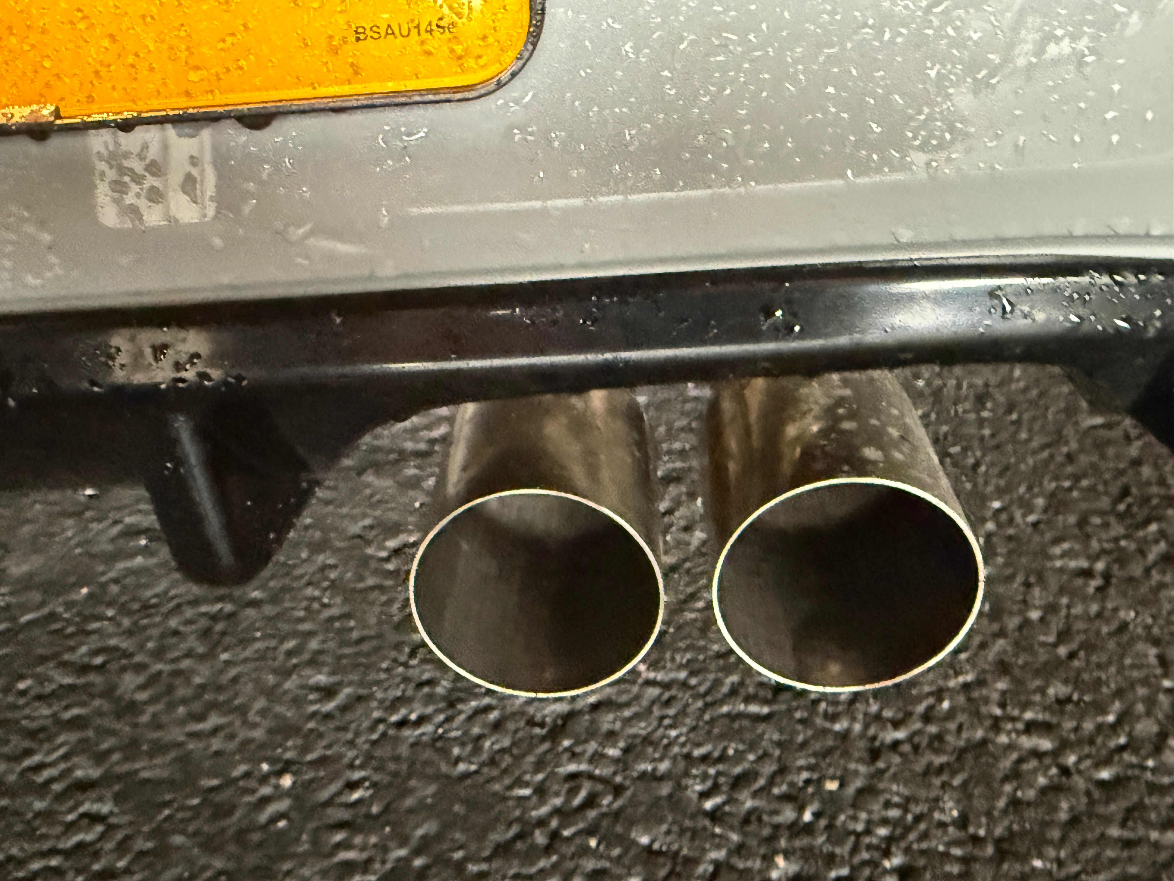

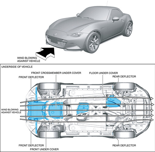

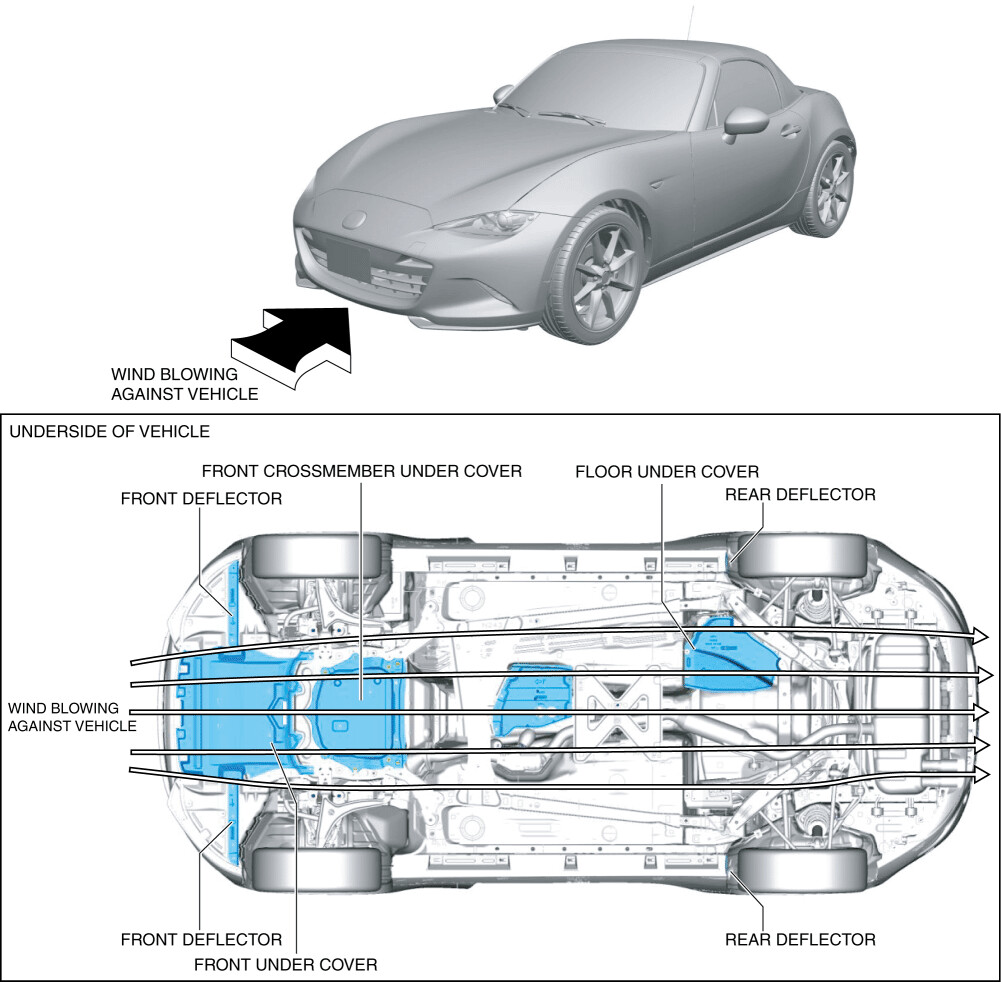

My Under Cover Aerodynamic Performance may be to be blame. Or in other words transitioning from 60mph to a stop the hot exhaust air is suddenly trapped and rises, somehow getting in to the car.
So between my stealth undercarriage and the dangly flaps I’m getting the dutch oven effect.
Found the smoking gun as it were. A quarter mile dual carriageway, a torrential downpour and straight into a supermarket car park, my favourite spot under a flyover in the back corner. Went to get the bags for life from the boot and saw the pipes steaming away moisture and a slight shotgun effect of the last of the exhaust gas rising lazily and disappearing back under the car. I would say that it’s just physics and not anything serious. Will sort out the flaps on the next sunny day.
The engine is running here and the breeze from behind is pushing any gas under and up.
