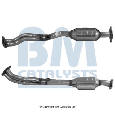

Fitted a BM Cats cat to our Mk1 about 7 years ago after it failed emissions on original cat.
Still passing tests on the replacement but needing more coaxing with a longer hotter drive directly before test.
Probably need a new replacement in next year or so, but not done too badly.
Since the car is post March 2001, it needs to be a type approved cat. (The BM one in the ebay listing above isn’t, but they do sell them).
I’ll need one soon, and am torn between buying a used cat from a low-ish mileage breaker or a new, type approved BM one.

When you are sure the fault lies with the cat and nothing else only get a type approved cat , I have not experienced the BM one but it has been mentioned positively here before.

I know that BM make type approved ones, and that they’re available on ebay.
I remain sceptical about the quality of all aftermarket cats though!
