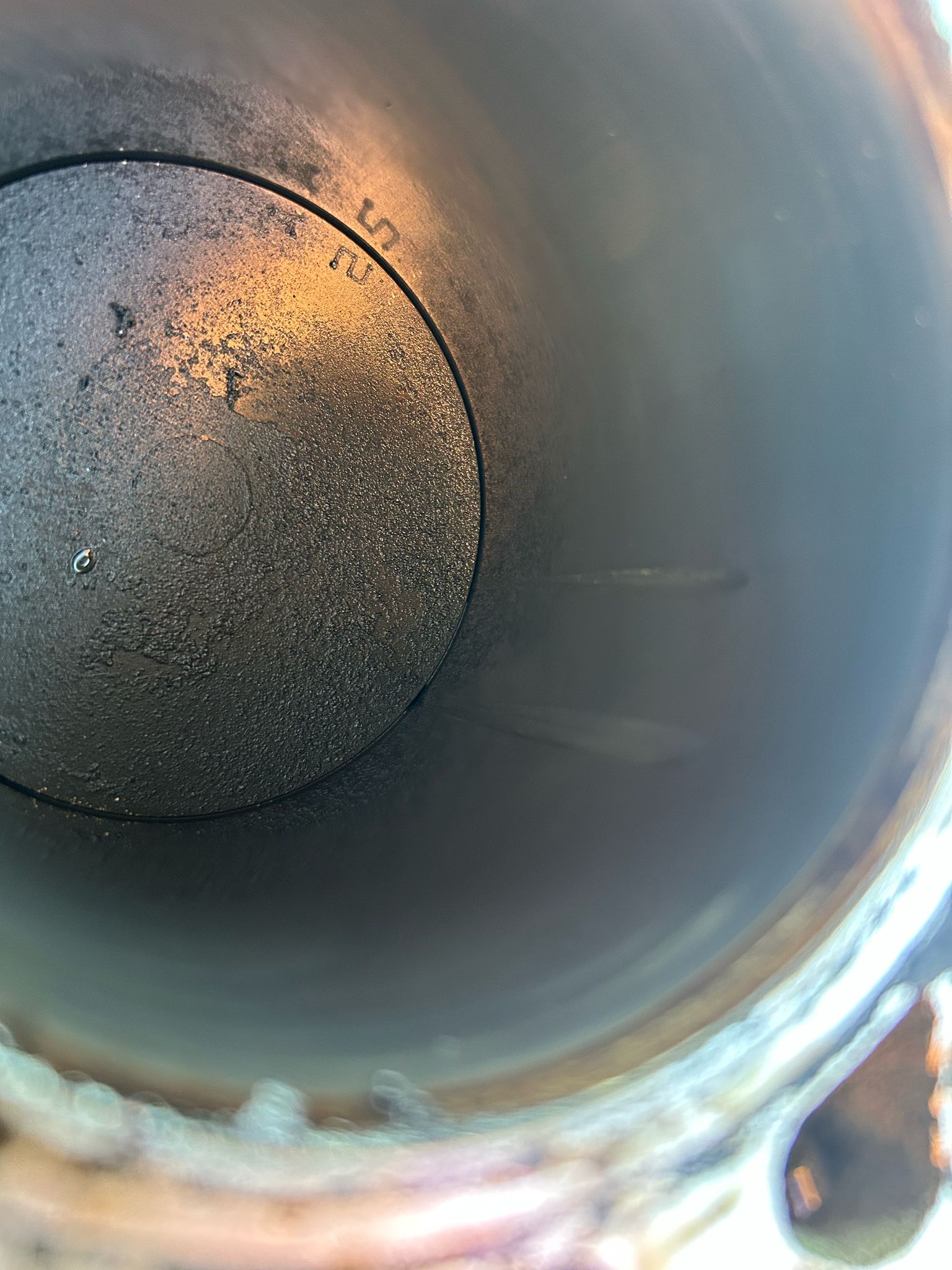

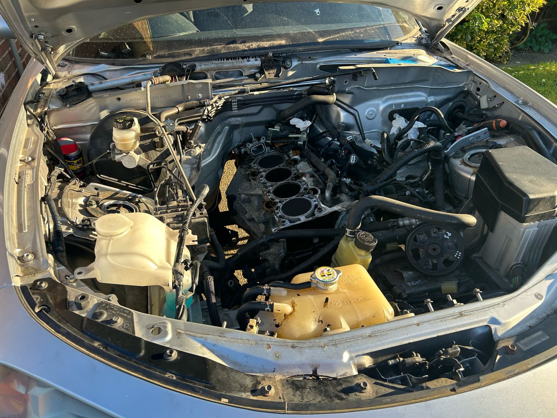

I have just taken a gamble and rescued a neglected 2007 1.8L MX-5 at the reasonable cost of just under a grand. A real beauty, with minimal rust, and 80k miles on the clock. Sold as seen with a “ticking” (tapping/knocking) engine, with exhaust coming out the oil filler cap and clouds of smoke coming out the exhaust.
As my first project car, I’ve been having a great time disassembling the engine, and the top end looks great. The bottom end, unfortunately, looks a little cooked. Going to need new piston rings, and there’s some deep grooves carved out of some of the cylinders. I’m yet to pull the block, but just thinking ahead I’ll either need a new block/full bottom end, or some machine shop work done.
I suppose my question is - are there any reputable machine shops reasonably close to Reading, that anybody would recommend? And is boring/re-sleeving the cylinders even an option on these engines? Any experience in this area would be greatly appreciated :smiley:
