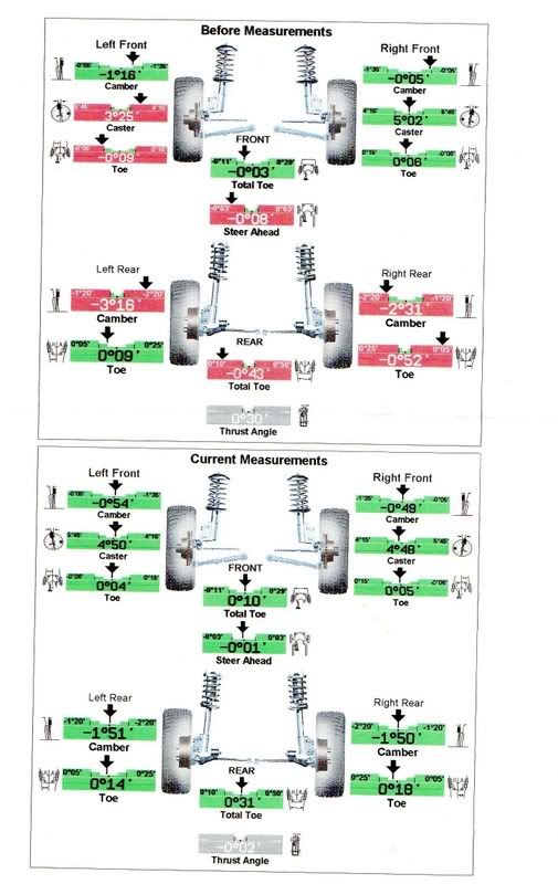

i call this morning after having new puredrive suspension and new bushes al-round fitted to the car, on arrival Pete was their (what i friendly bloke ) got my car on the ramp set the alignment equipment up. then asked how i would like the car setup and then proceeded to make a quick call to some bloke that i don’t think anybody on here will have heard of Tony from WIm (ha ha only joking Tony) who proceeded to rime of setting for my car of the top of his head!!!.
Pete then setup my car and got me all greens :slight_smile: (he got me 13 thats 2.5 day of my veg done with). All i can say is thanks very much Pete for the work and i would recommend anybody in the area to use him he is a all round great bloke, THANKS PETE !!!
Also not forgetting Tony for giving Pete the setting he had no reason to give them to Pete he did not get anything from it other than a lot of respect from me THANKS TONY !!!
Now the car what can i say i live about 30 mins drive from Pete’s garage it tock me 2.5 hours to get home and then only because i had a previous engagement with a niece who wanted to drive the 5 so we went out for another hour and a half, I eventually got home at 4 o’clock that means it tock me 5.5 hours to do 15 miles ( thats some heavy traffic). Somehow i managed to do 90 miles today not bad for a 30 mile round trip it handles great its like a completely new car sticks to corners no more banging from the suspensions only problem is all i want to do is drive it and then drive it some more round any twisty road i can find.

thats a fair bit of camber on the rear no? i run mine at a degree all round with about 0.3 toe front and rear.
i was also told that running as much caster as possible would benefit. is the one at the top 4 something deg because the n/s wouldnt go to 5 deg+ ?
luckily i have access to a 4 wheel aligner for free [H]
Stock rear camber for that trim is -1d 42’ so 1d 50’ is hardly a violation.
Your -1d front/rear reads odd, why have you decided on this position?
i was reading it was a good compromise on tyre wear for road use, the settings on that car would eat the tyres.
