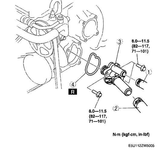

Quick question, anyone know the nut size and torque on the thermostat housing?
From memory an 8mm head and probably 8-10Nm.

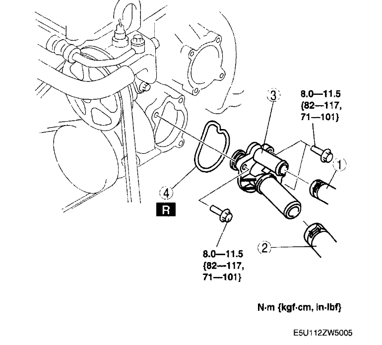

Here’s the definitive info from the Workshop Manual
Good luck getting a torque wrench in there!
