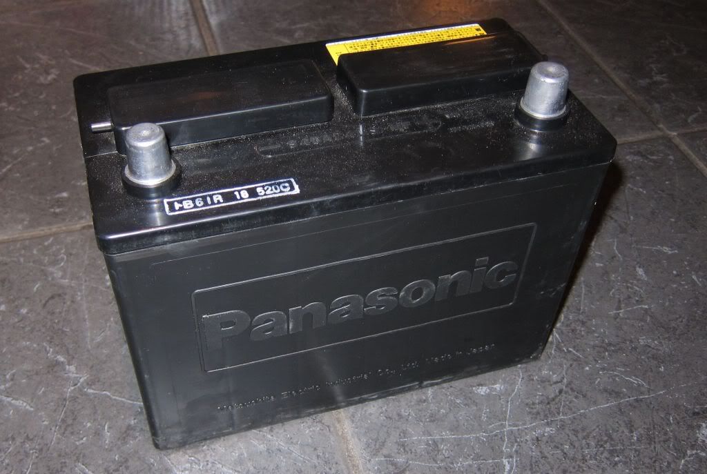

Hi, picked up a pansonic battery from Perrys this afternoon.  Not going to be trying it on car until tomorrow.  It’s a different shape and size from the battery that was on car.  Does this look like the one?  I seem to recall the other fitting the the battery tray properly.  This is still smaller than a usual car battery, but looks longer and narrower than one that was fitted.
I’ll know for sure when i try it but wondered if you could tell from photo.  If it’s not right it can go back in the morning. Thanks Ray
 That is the one!  Numbers on the top S46A24L[S]-MF
     Regards  Geoff Peace.
