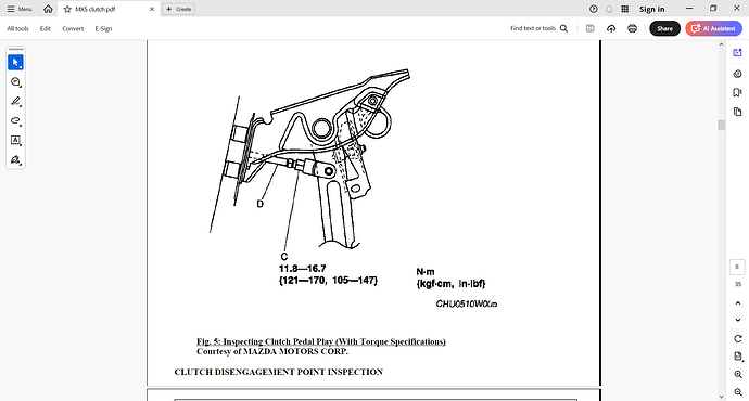

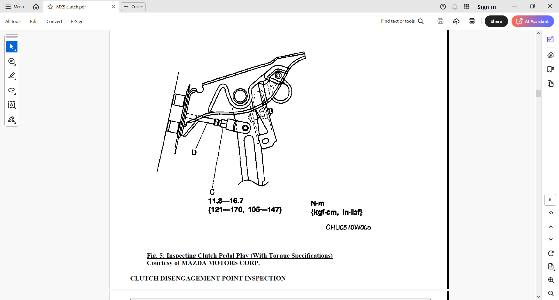

How do you adjust the pedal to bring it up a bit?
Undo lock nut “C” - adjust rod “D” - re tighten lock nut “C”
I found 1/2 turn was enough
