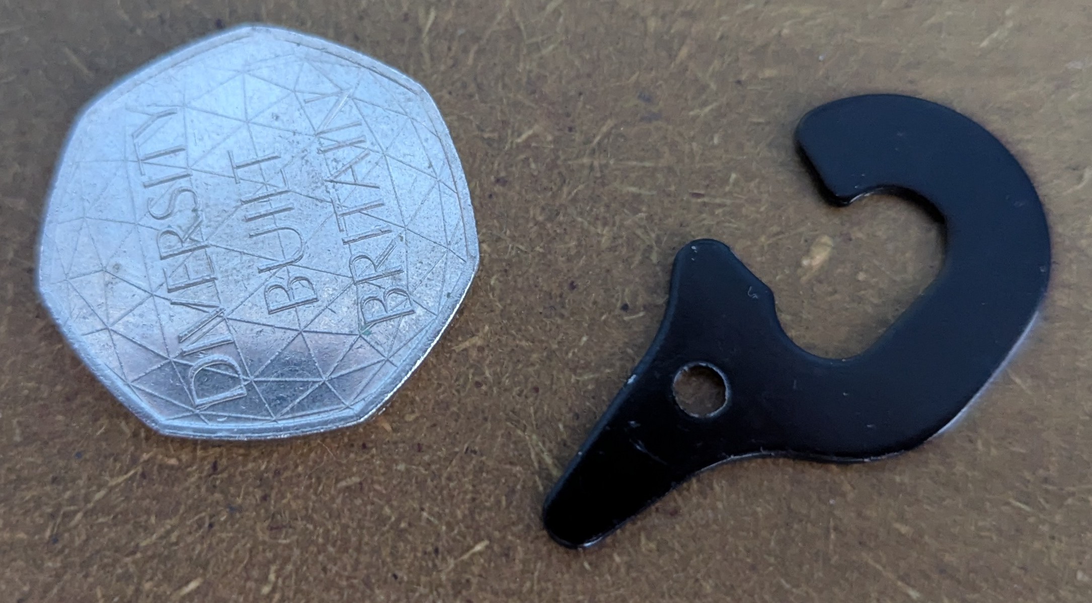

  4. I have had the rear deck removed and painted along the leading edge to get rid of the scabby appearance and when I valeted and polished the car, found this item on the rear carpet behind the roof. Has anyone any idea what it is, could it be a shim that’
    s dropped out when the deck was refitted by the body shop?
    many thanks in advance.

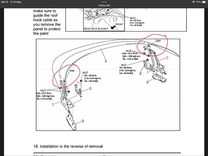

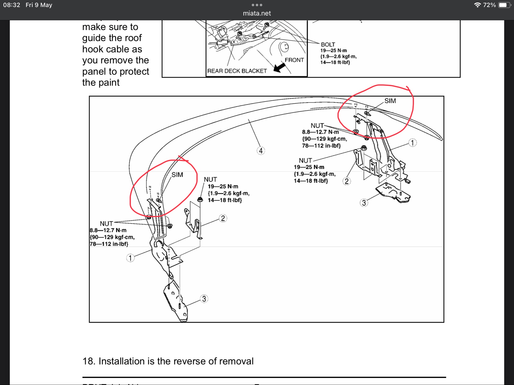

Morning Scott , yes it’s a prht roof shim. See here
Location circled in red

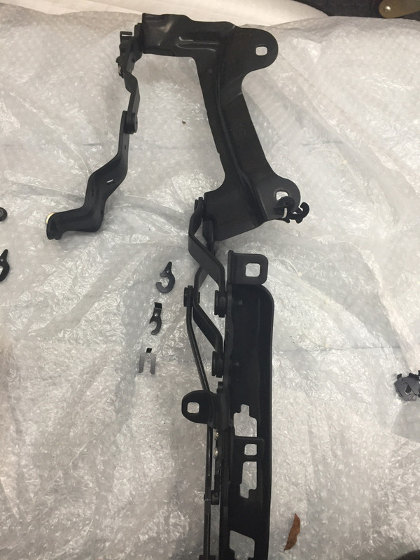

Also a pic off a roof in pieces
UK Penfold, Many thanks for your reply . Will the lack of this shim be likely to cause any operating or leak problems in the future and should |I return it to the body shop for correct re fitment.
Best regards
Scott
Hi Scott , your welcome , not sure but I assume it was there before , so if it was me I would refit it looks simple enough , so yes I would have a chat with them and show them the shim and diagram and see what they say …
