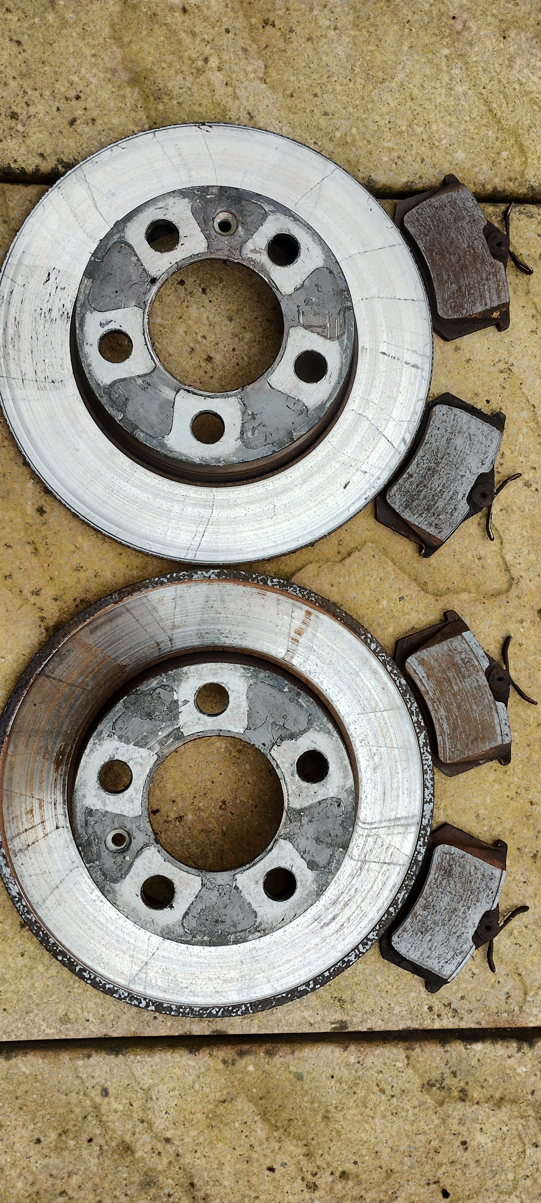

My son bought a car with so called “Full Dealer Service History”
It had a fresh MOT on it as well.
He was complaining that he could feel a pulsing in the brakes.
This is what I took off the rear of his car !!!
And the very reason I now do everything myself.

I hope you are taking those parts back to the car sales who sold your son the car? NO way should the brakes have passed an MOT with those discs!..Just “visually” they should have failed an MOT!
Their current attitude is “you can’t prove they came off the car we sold”
If my son hadn’t been going on a holiday in the car I would have made him take it back as it was.
I took the stance that I wanted him in something safe and reliable.
For me the £80 it cost was peace of mind.
