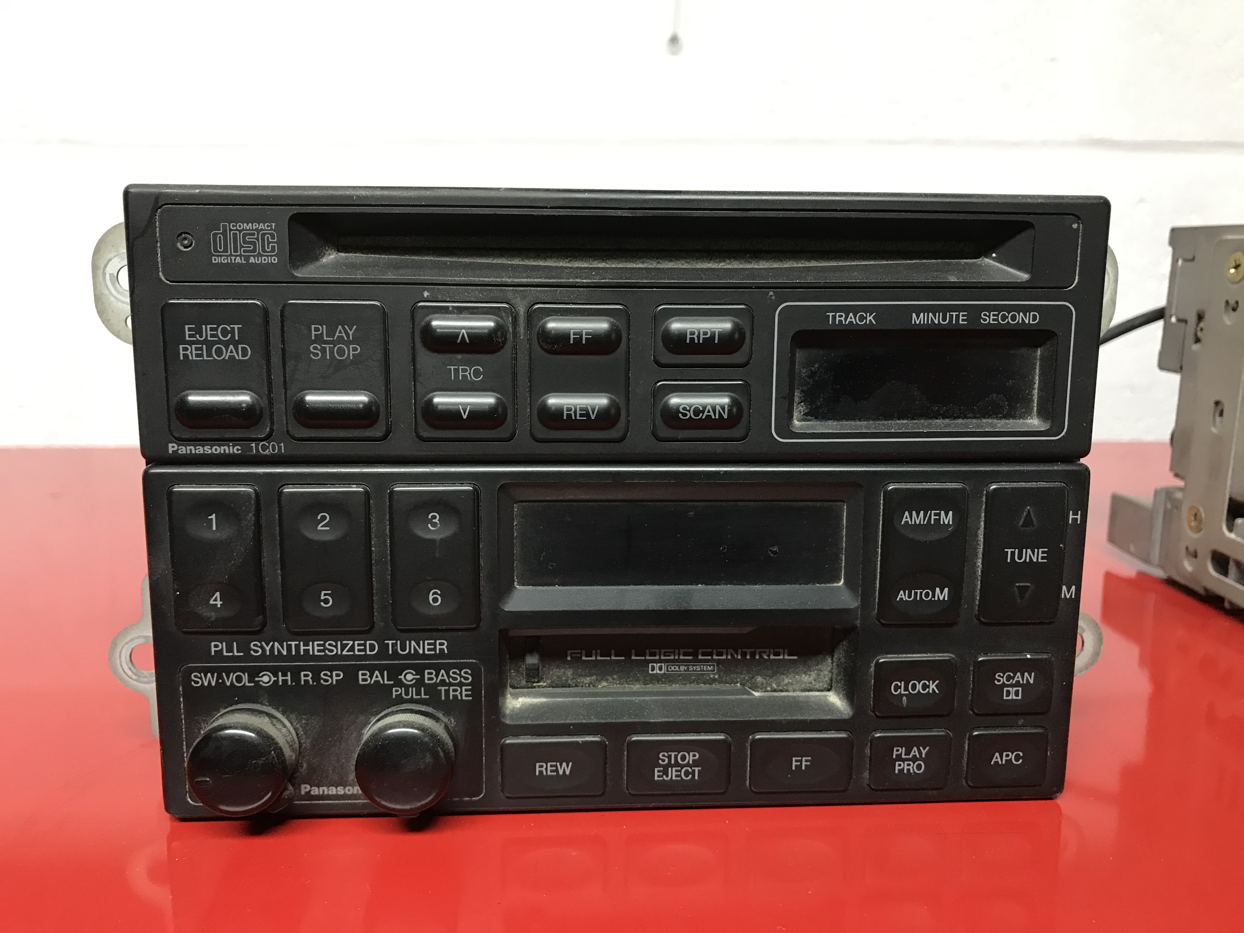

Assuming the amplifier part of this unit works,
What would be the possibility of being able to solder in a 3.5mm jack lead so that something plugged into said lead would play through the amplifier/speakers?

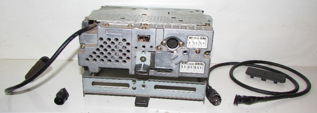

I think the CD player connected to the main head unit by a DIN socket:
But this is 13 pin, not 7 pin

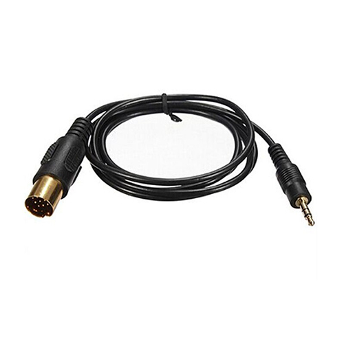

Such leads obviously exist:
I like Saz’ options, but they are for different HUs.
Simplest solutions are always the best, and if there is a socket on the back then it is best to use it.
Failing the presence of a connection on the back, if you can find the service manual with the circuit diagram and board layout etc for that 1C01 Panasonic (their manuals are usually very good) then I can tell you where in the circuit to make the connection. It will probably have a different and more useful reference number hidden on the back of the unit.

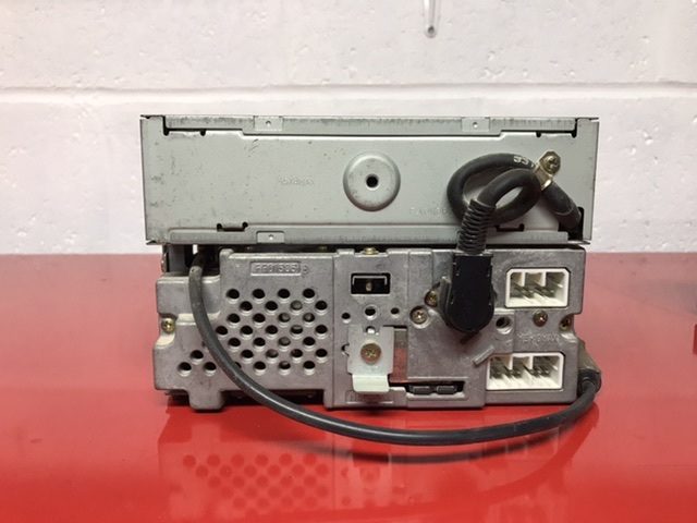

Have you a good photo of the back?
It is the same unit as in Saz’ post but has the CD player with it. The CD player is a separate unit.

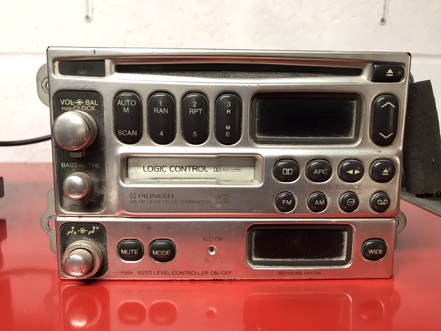

So, what about this one :thinking: :wink:
Ah I was fooled by the components being the other way up, CD at top, vs CD at bottom.
That DIN plug on the back is the obvious solution. DIN plugs are readily available in a vast range of pin configurations. You just need the pin connection data to be able to put in a signal or even power another module hidden in the CD chassis. I gather the laser dies in those and they are made of unobtainium.
The same logic applies to any other units however; if you can find a ready made lead that will plug in, then that is the answer.

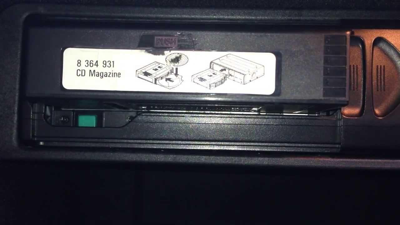

In the Jag XJ, the Alpine system fited as standard, is a complete electronics nightmare, completed with fibre optics. Obviously state of the art at the time. The multichanger (commonly used in Mercedes, Range Rovers, BMWs of the same vintage) is fairly unreliable now, requiring sometimes specialist tools from Glok or Makarov.
