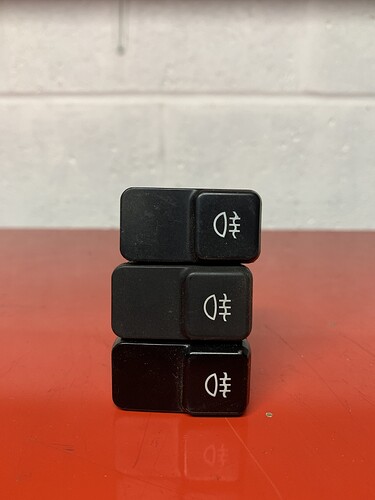

Are the 4 wires going to the connecter plug White/Black, Red/Black, Blue/Black and Red (or black if a 1.6).
I’m a little bit surprised to see 5 terminals on the switch. I have 3 switches here all with only 4….
Being as the beam is pointing to the left on “your” switch, I’d guess that it’s for a front fog lamp, although I’d also expect the beam to be angled down slightly if it was.
This is a dual fog lamp switch from an NB.

To be honest I also got a second Switch, which in all honesty might be the one from the NB (not sure, since it was some time ago) but it didn’t match any of the pins or form of the current one.
But the switch doesn’t illuminate in any scenario. I also noticed your switches have a white plastic surrounding the pins, mine’s blue.
