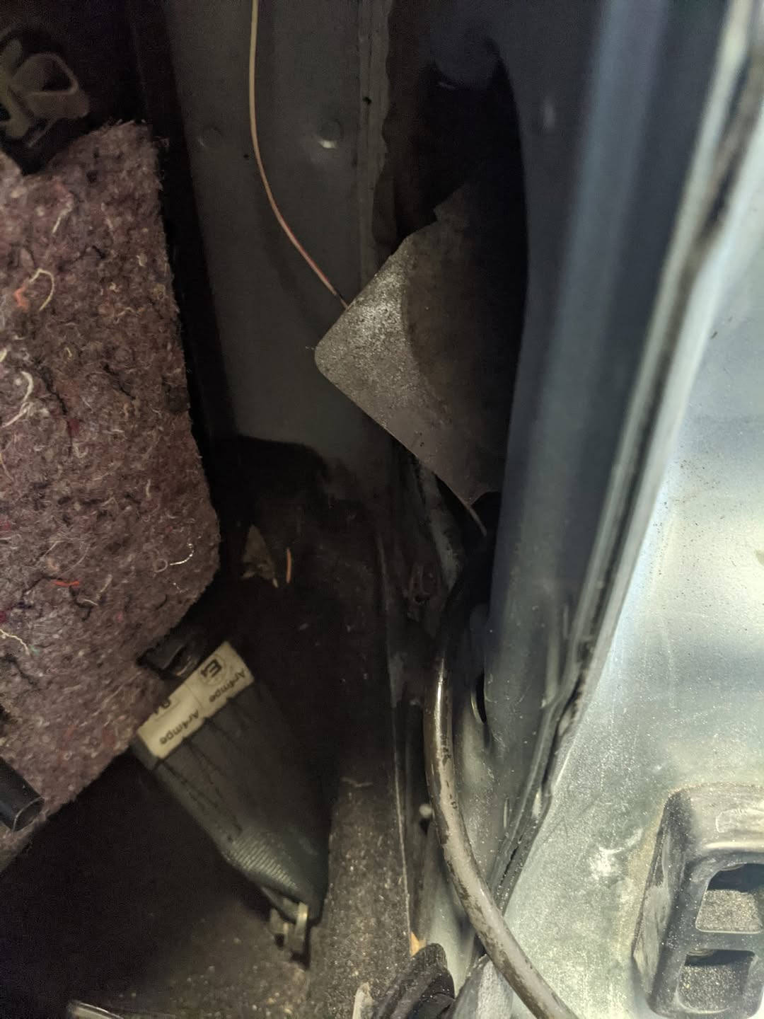

I am a great fan of Dinitrol ML. I have used this product in all my NCs. My first one was WU56 WSL in 2019. She was sold to a chap in Edinburgh, and so far, she has survived six Edinburgh winters. I remove all the wheel linings and then the grommets. With the extension hose, I empty around five cans into the inner sills, subframes and chassis rails. Any possible rusting areas on the floor are ground back to bare metal and treated. My recent addition is to remove the trim over over the lower seat belt anchorage and treat the box section.

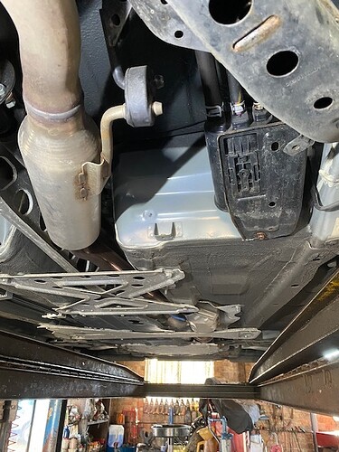

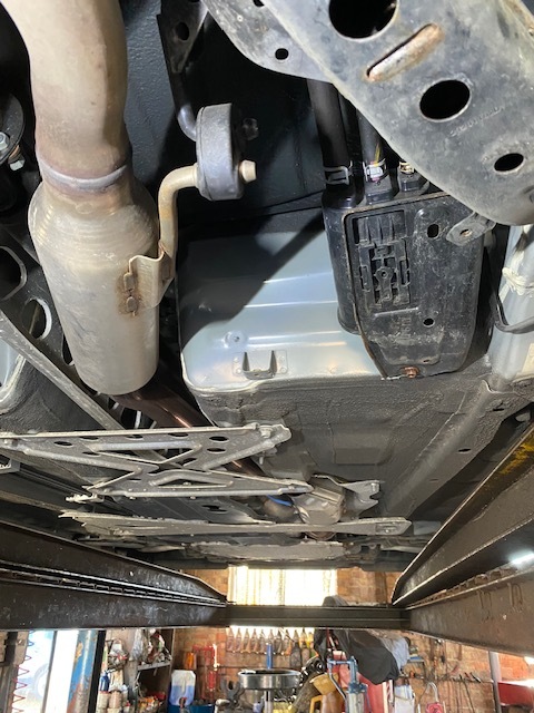

This is my four year old ND. The MOT tester commented that it’s almost as clean underneath as it is on top! That made me smile. :slightly_smiling_face:
