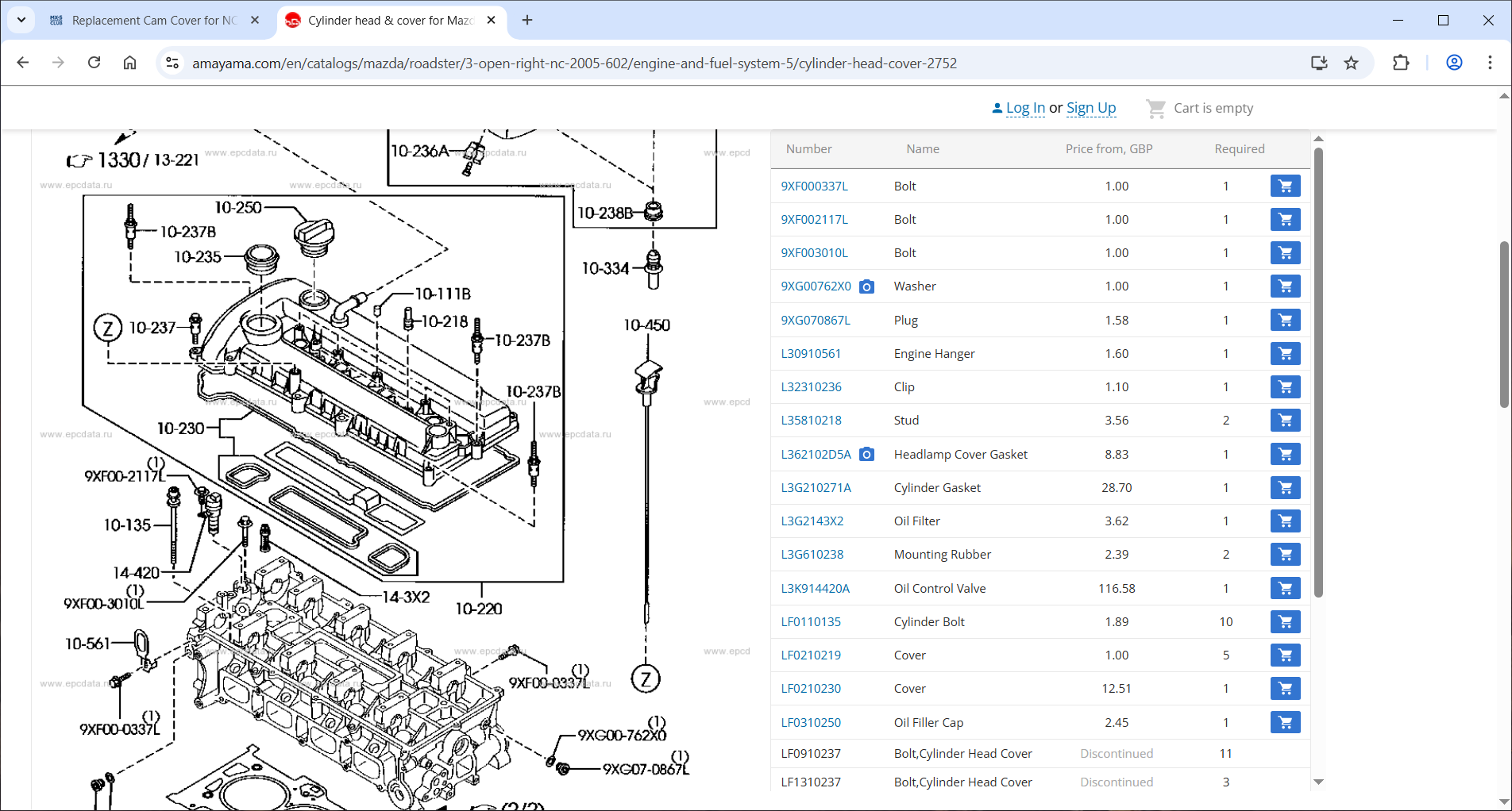

This would suggest it is an insert where the VVT goes
