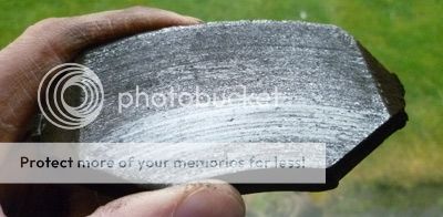

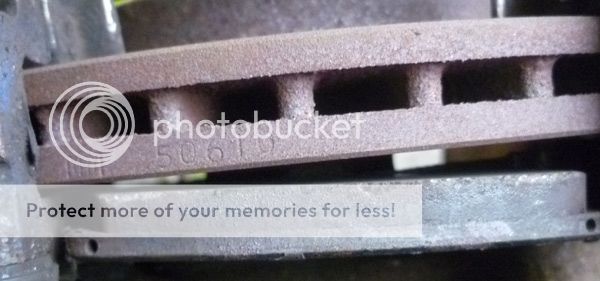

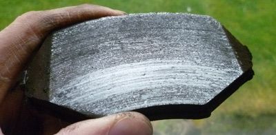

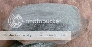

I’ve posted some pics below, what you think of the condition of the discs and pads (if you can tell at all from photos). bearing in mind Kwit-Fit said they needed replacing due to heat damage. Is there a minimum width for the discs? The pads are more shiny on the lower part — is that normal?

Can’t see anything wrong with the discs or the pads - they aren’t worn at all, assuming the disc rotates flat and hasn’t actually warped (unlikely).
Brake hose looks fine too, but I wouldn’t be surprised that the caliper piston is a bit rusty under the rubber and might well be seizing slightly.

Hi Andy, They look quite likely re-usable. The disc min thickness is stamped on the edge, just out of sight before MM in the pic, and the pads are nearly full thickness though they may need bedding in a bit if they’ve been running at a slight angle.
Looking at the pic of the caliper the piston seems to be coming out at an angle, more at the picture top. If that’s the case, that is the side which applies pressure to the pads at the inner part of the disc face. That part of the discs and pads show signs of having been doing the braking so that would fit with a siezed piston being forced out.

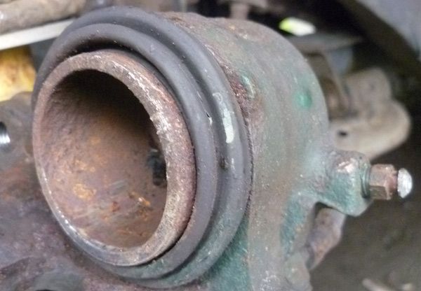

I’m going to replace the piston and seal at the weekend so this is only for interest, but I pushed the piston out a little tonight and took a quick pic of it in the dark on my phone. There’s quite a bit of rust in there. It wasn’t difficult to squeeze the piston out with the brake pedal though, so perhaps not seized just sticking.

Job done! Replaced the piston and the seals, refitted the caliper and bled the brakes (copiously). Tested for leaks then took it for a spin … carefully at first! It’s braking fine, no pulling to one side even under hard braking.
