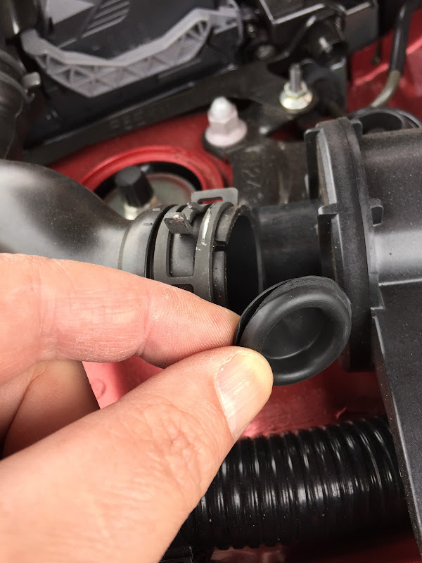

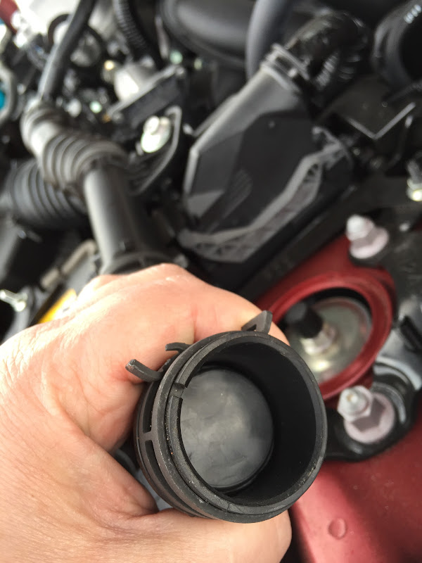

I blocked mine, like this;
Thanks for the warning Paul, I like the approach Ian has taken as it makes no visual difference in the engine bay, I’ll probably try that first.
Looks good - is that upstream or downstream of the resonator and what are the noise effects through the range ?.
Engine side of the resonator, improves the cabin ambiance allowing you to add your own soundtrack in the exhaust department…
Quick, cheap and instantly reversible, give it a try as a first option.
Thanks Ian, yes will give it a go, need to look at piping as there is suction , surely wouldn’t it be better on upstream side of resonator ?, isn’t there (very remote chance) grommet could get sucked down into manifold if it broke up or even pivoted in pipe (is that possible ?), will have to go & dismantle & explore, b rgds, Paul H.
Reasonable points, must go and have a look at mine after a year and a half and see if it has deformed at all, it was a fairly solid grommet/blank that went in.
Thanks Ian, have pulled break down of the ducting system, seems complicated for a bit of noise although I understand the resonator (I removed my ducting on the Mk3 and fitted a Moss cold air system -bad move 4000rpm booming & droning, not good) think I will put my blank on the upstream side of the resonator, will advise how it goes etc, that’s tomorrows job, b rgds, PH.

I understood that none of the 1.5’s had the sound tube, not even sport in the UK, the US guys that carry out the delete use this part I believe.
Guys, personally I like all the noises my ND 2.0 Sport Nav makes. However if you don’t like the induction sound pipe (which makes the car sound like it is fitted with Webber carbs. If you remember those), wouldn’t it be safer and easier to plug or cover the sound tube aperture where it enters the passenger compartment? I would think that the resonator is a diaphragm that isolates the sound pipe from the induction system and  transfers sound waves from the induction system but prevents air bleeding into the induction system. You also need to be aware that not all rubber grades/types are resistant to petrol and if fitted to the induction side may be degraded by petrol fumes and soften. I would be very careful fitting anything into the induction side as someone has already stated, there is always the possibility it could be sucked into the inlet manifold (ouch!)
Paddyman, both the standard clear and the IL Motorsport units that MX5 Parts sell are, just been on the American site shows sealed units in variety of colours ?, but odd I have just looked at MX5 Parts listing for the smoked items, says that the bulbs are changeable unlike the original Mazda fit, when I put them in they certainly seemed like sealed units to me, couldn’t see a way of changing the bulbs, may have to pull one out tomorrow and check again, do remember it said 12v 6w on the moulding, the plot thickens, I will be back, watch this space.
First rider off, that sounds (pun !) more sensible - blank the pipe at the bulkhead, tomorrow’s job, will report back.
Another thought, being as the “resonator” need flow through it to dampen out the intake pulses etc, could the pipe be removed from the bulkhead (bulkhead sealed/closed/blanked) and the pipe be ducted into the engine bay to still allow free flow of air, also, presumably this system only operates at highish (4K rpm up ?) to allow air / noise into the cabin for effect,but surely then it is sucking air into the inlet manifold from the cabin area ?, doesn’t this mean that at that rpm it basically opens up another way for extra air to enter the inlet manifold (albeit unfiltered ?)being as it is a negative pressure (sucking) does this have any effect in weakening the mixture, ECU will compensate I guess but then that must mean that the “resonator” is a sort of non-return valve ?, just thoughts from an idle mind.
