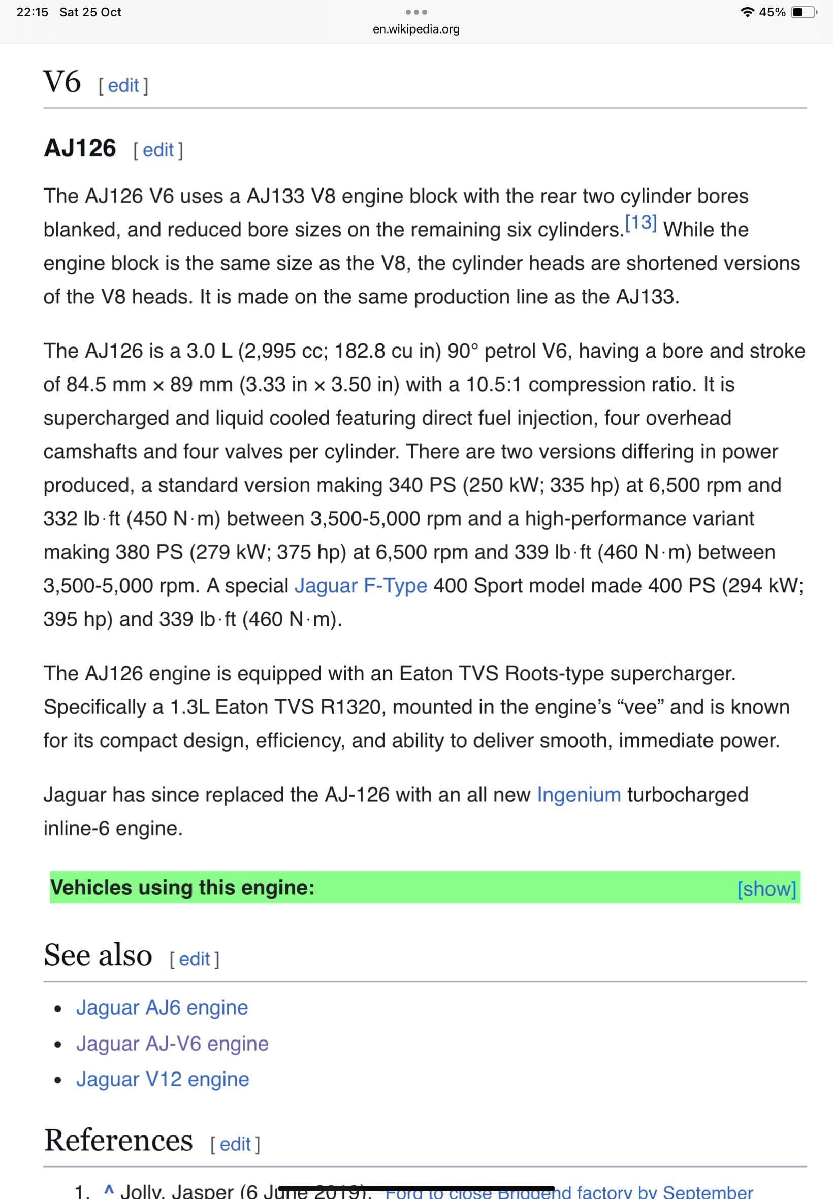

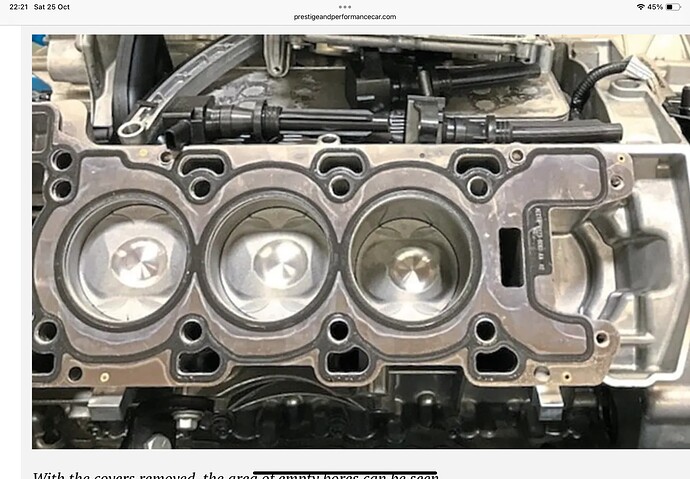

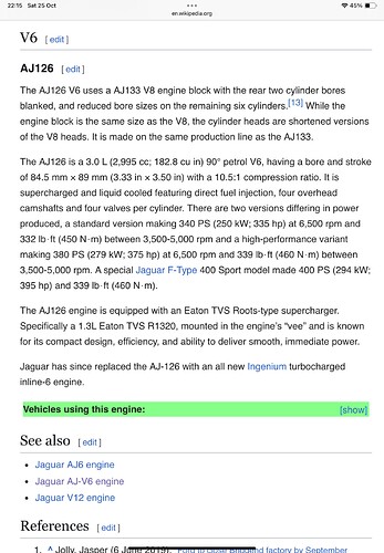

“ . . .which is actually a V8, but with 6 cylinders”
I’m baffled. Would you mind explaining that please.
Ah thanks. So it’s an 8 cylinder block with 2 of them blanked off and redundant.

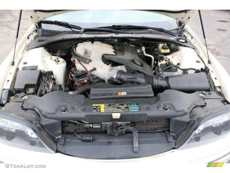

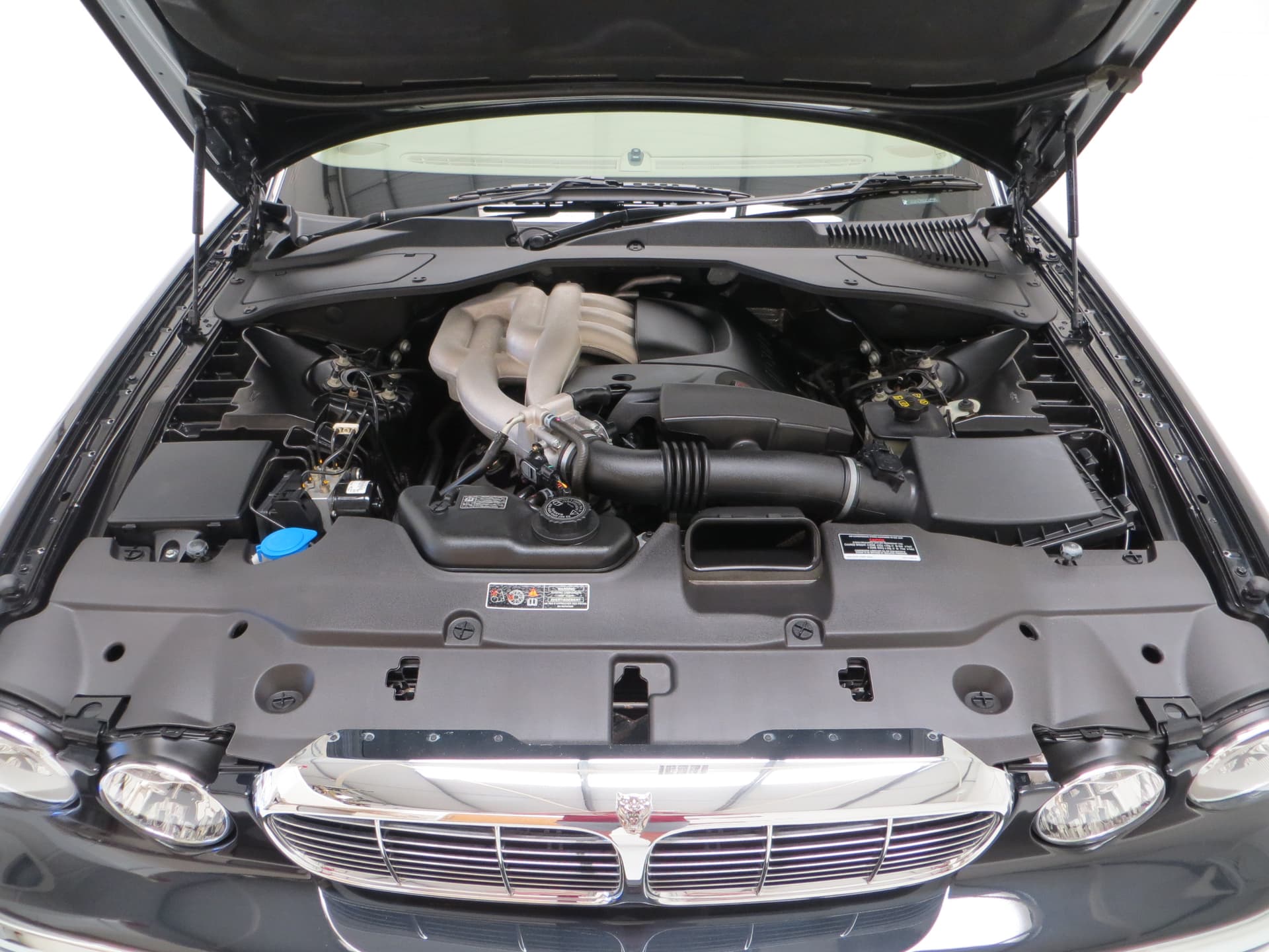

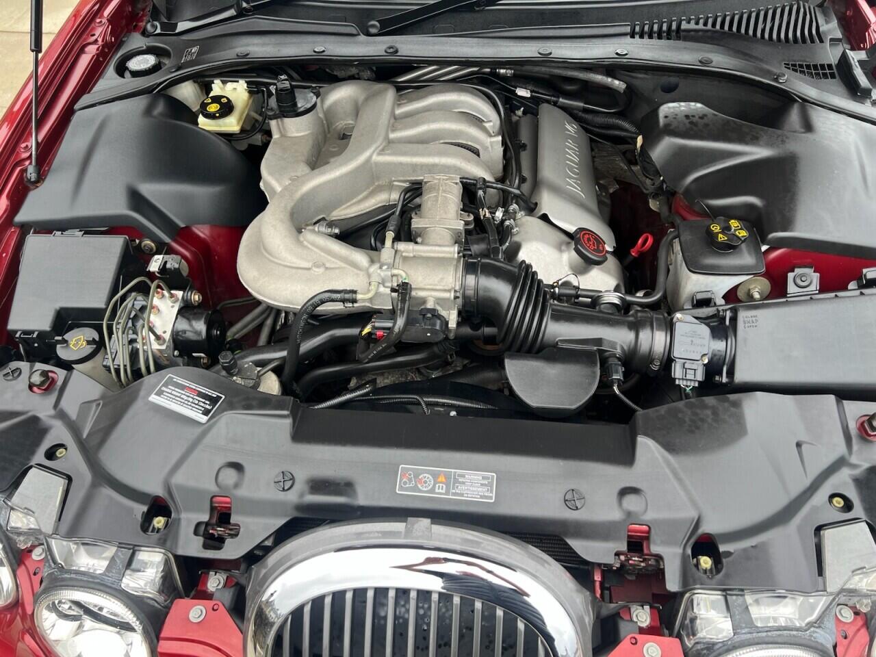

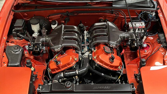

The AJV6 had a lot of commonality with the Ford Duratec V6. In face it was Ford who did the first conversion, as an apprentice project, dropping the V6 from the Lincoln LS (a rebodied Jag, or was the Jag a rebodied Ford). Ford fitted a RX7 diff and RX7 gearbox, presuma bly because it was a bit stronger than the MX-5 item. They used an airbox out of a Ford Taurus, and the power steering pump came off the LS, but it had to be reworked for the Mazda steering rack. RX7 brakes, half shafts and suspension uprights. There was never any plan to put such a car into production.
Ford Install
Lincoln LS Duratec V6 in its natural setting
Typical Rocketeer V6
Jaguar S-Type V6
In the XJ6
There are differences between the Jaguar and Ford versions.

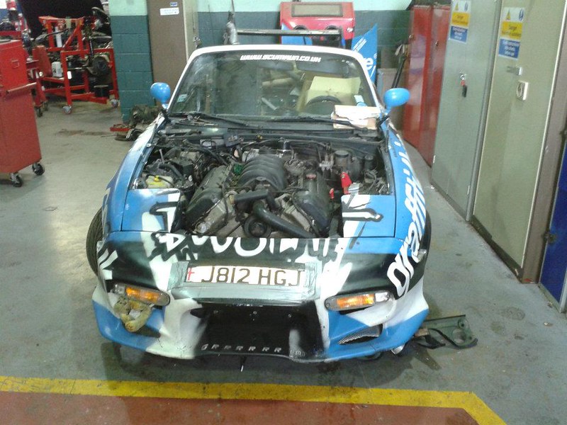

Someone squeezed in a Jag V8
This might be as far as it ever got.
