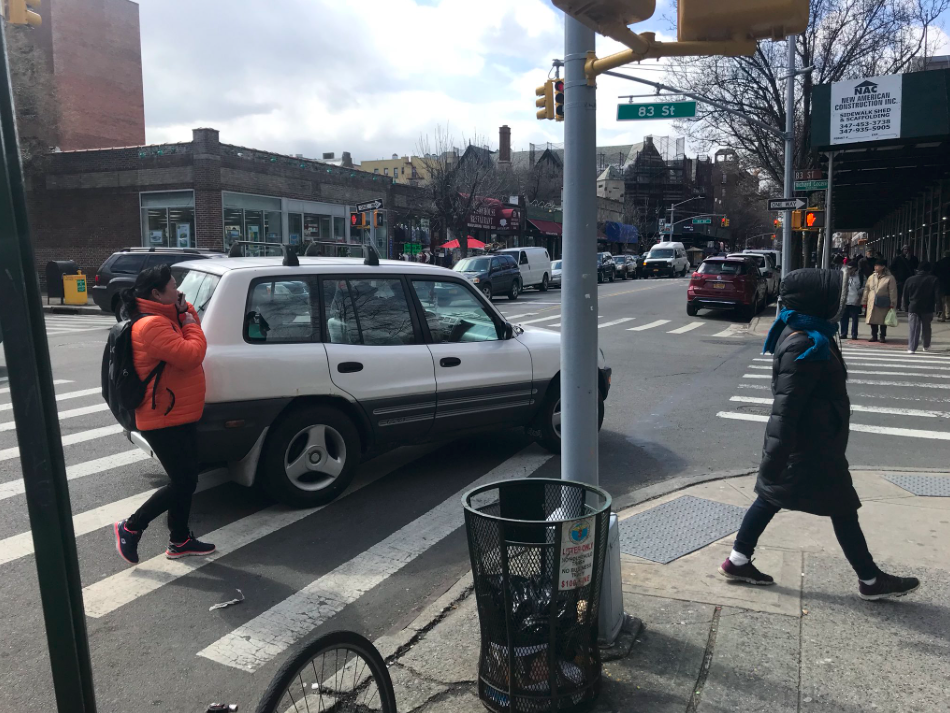

No, its because in US Law, pedestrians are often blamed for being injured by cars (Jay Walking Laws). Manufacturers have a larger role in lobbying. Introducing laws aimed at protecting pedestrians leads to two solutions; restyling cars to have a much higher bonnet line or fitting complex active bonnet systems. The manufacturers don’t want to do that, because they are afraid the styling changes will hurt sales.
Mazda doesn’t fit pedestrian protection systems for the same reasons as it doesn’t underseal cars; because (in the US) it doesn’t have to. If it does something it doesn’t have to that hurts the margins.
