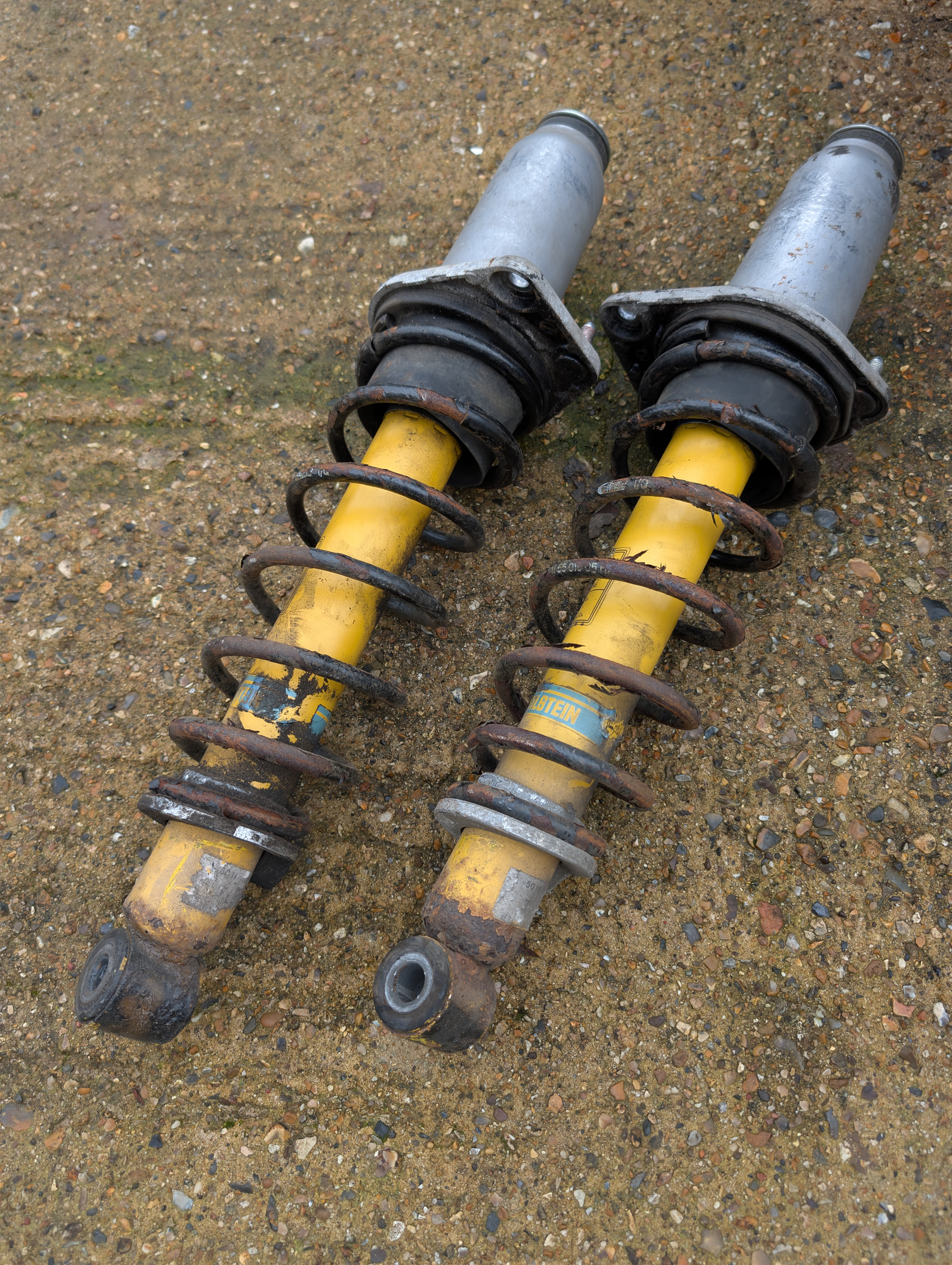

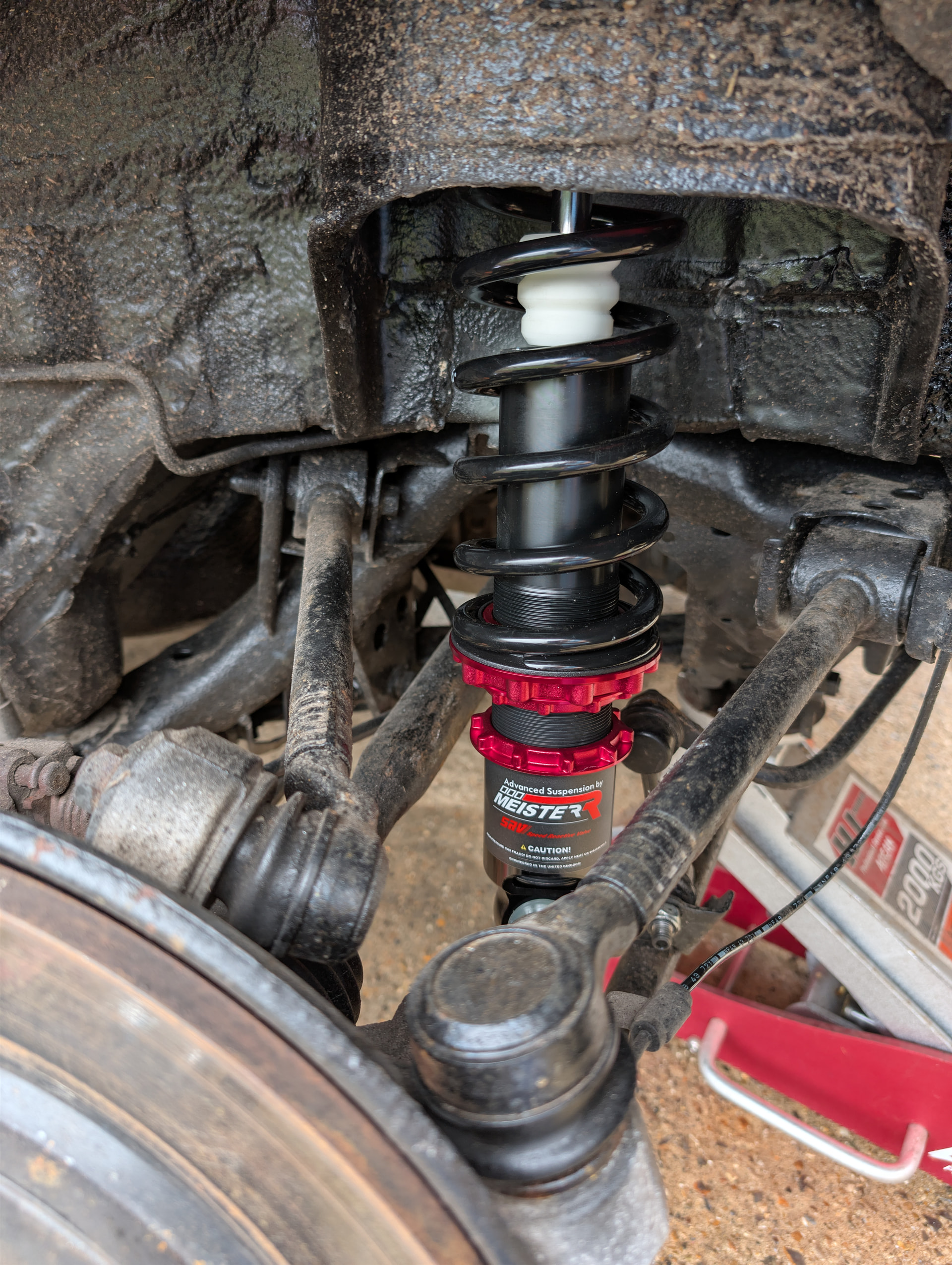

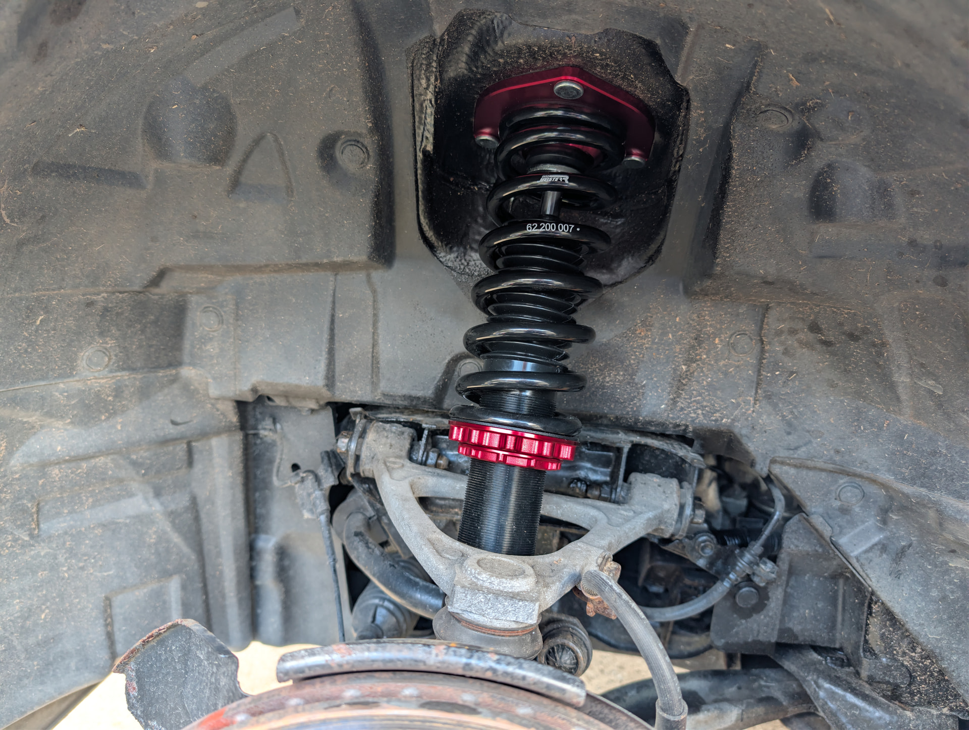

Busy day today - took the bull by the horns and fitted the rear MeisterRs on my own. A lot of swearing at times with stuck nuts and trying to manhandle the stock ones out, but they’re in :grin:
Will probably wait until I’ve done the fronts before I go for a drive and will need to see how the ride height settles. Right now they’re about an inch higher than what I took off, but if that drops much I can see myself needing to raise them up some. Will see how it goes - at least I have control of it now!
Also going to be nice having 32 levels of damper to play with :grinning_face:

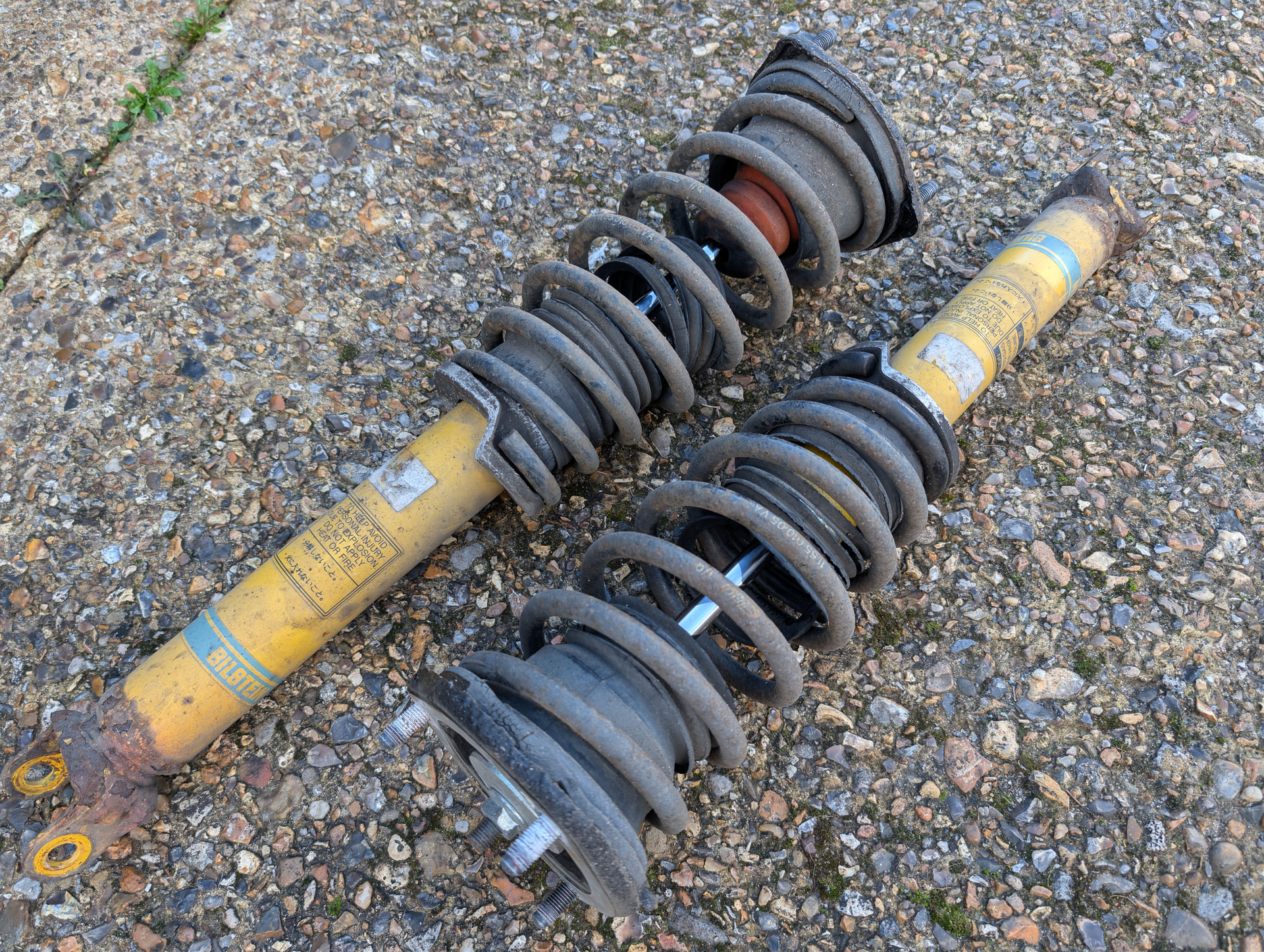

Installed the front coilovers today. Found it quite a bit easier than the fronts which was nice. Couple of stubborn nuts but air tools FTW :smiley:
Took it out for a quick drive and felt really good. I’m current only 22/32, where 32 is most soft, and it felt a lot less ‘crashy’ then the stock damper+lowering spring combo I had before. It’s sitting a bit higher than it did before too, but I’m still scraping on some speed bumps :frowning: I guess I’ll either have to raise it up a little more, and cope with even more arch gap, or just deal with it….

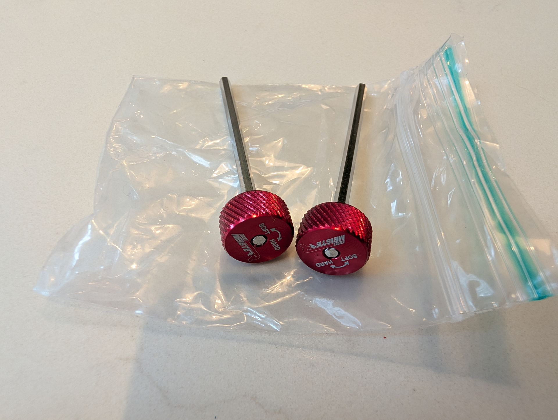

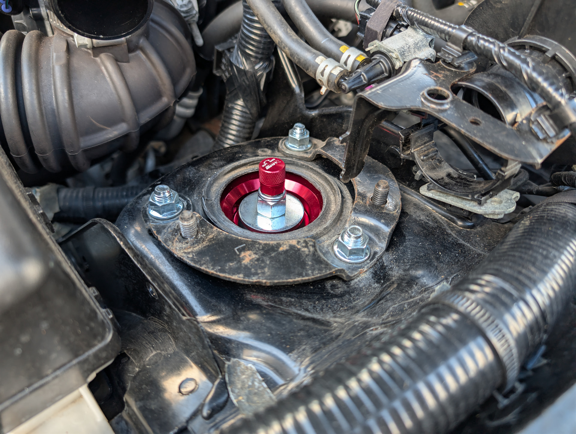

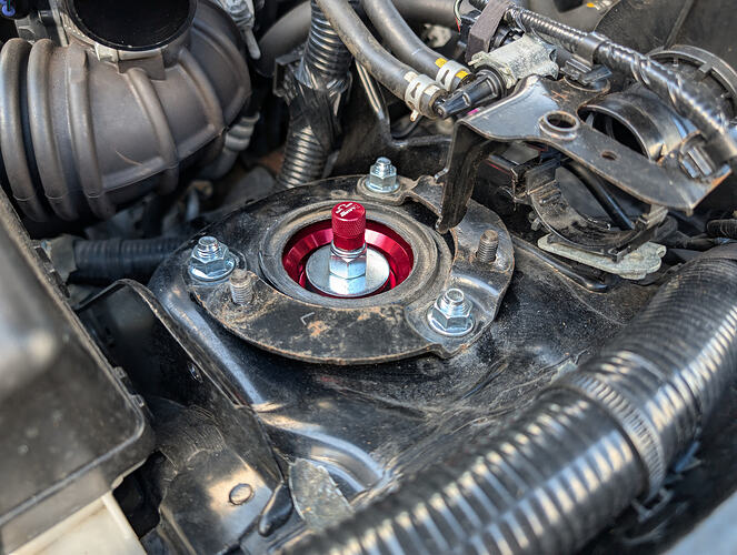

Still need to install the extenders for the rear damper adjustment, so I can adjust through the boot lining, and fit the extenders to the front too (though that requires drilling my OEM strut brace and I’m not sure how to fit the fronts yet). I could leave the fronts until I change my strut brace - got my eye on a nice red AutoExe one :smiley:

I drilled a hole of about 18mm on my OEM strut and can adjust the rebound with my fingers or an allen key. The adjuster on the MeisterR does look bigger though.
I would say that an alignment is a must once the suspension drops & settles; maybe in 2 or 3 weeks time.
I bought these which let me extend the adjustment up above the strut brace, so I’d just need small holes to get the posts through. Lining those holes up might be a bit tricky :slight_smile:
