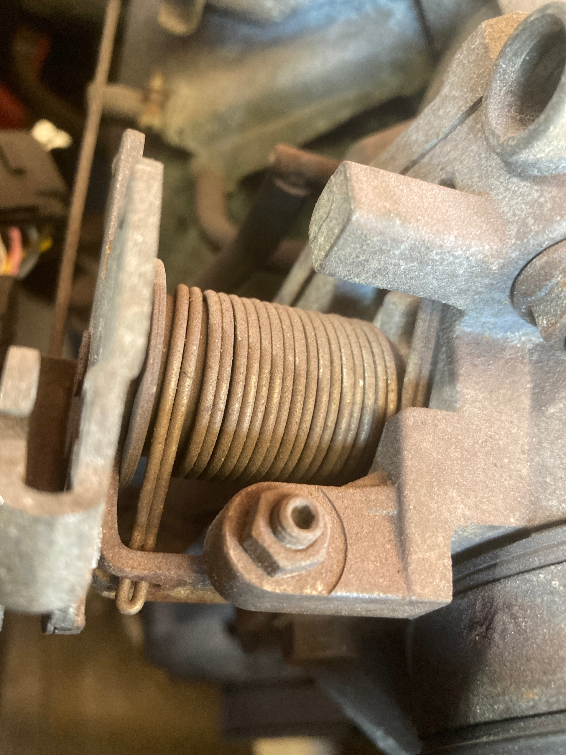

Just to clarify point about throttle . Blue book definitely states double throttle return springs are required on ALL cars but some people I’ve counselled say they have never been pulled on that in road going class. Can’t find anyone who has them to source any

MX-5’s have a double return spring on the throttle from factory.

chapter 7, app 2, 8.3 just says there must be a positive method of throttle closure by way of a spring.
Hi Andy thanks for the input. Just checked and mines the same so hopefully all ok
Hi Ken I think my confusion is where there are two carburettors each needing a spring and was also looking at some historic which rule N.9.3.2 covers. Most commentary on the throttle springs also points to having two. MisterG put forward his observations below and on the strength of everyone’s feedback I am leaving things as they are and will let you all know if any problems are encountered

“[Engines] Must be equipped with a positive method of throttle closing by means of external spring/springs so that in the Event of failure of any part of the throttle linkage the throttle(s) are sprung closed.
(My emphasis)
I suspect that the second throttle spring “requirement” originated as a scrutineering response to the second half of that statement (i.e. to ensure that the throttle is still sprung closed, even if a spring breaks).
In any case, the standard MX-5 throttle body does have a double spring.
